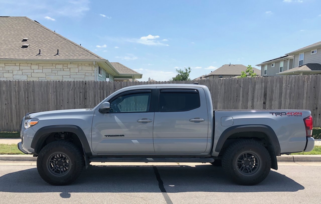

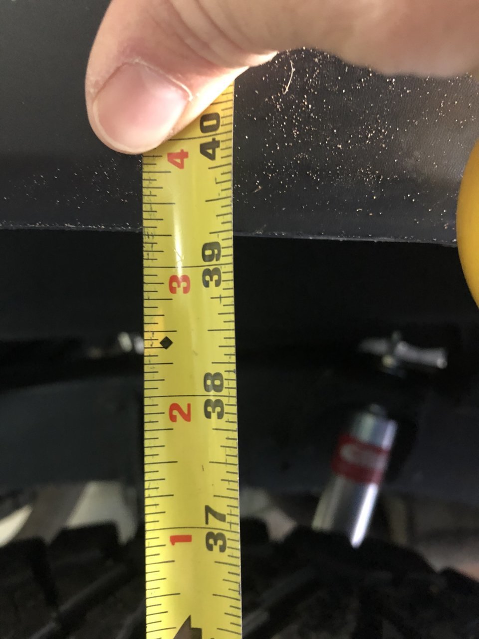

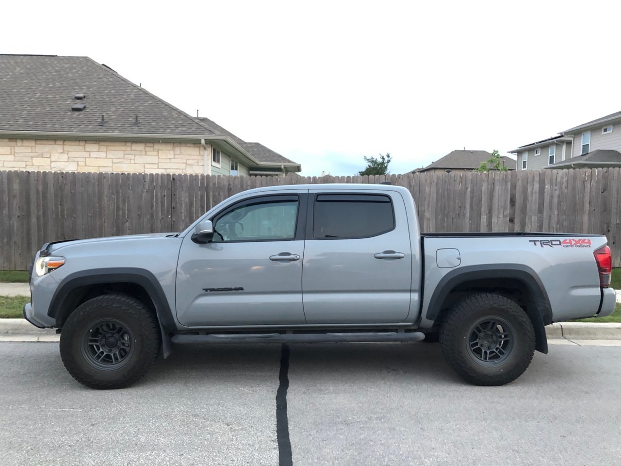

    Finally got my kit installed. Well at least half way, I got the fronts done yesterday. Pretty straight forward install but freeing the tie rod with a hammer was PITA (I wished I knew about the pullers). I netted around 2.5" inches on bottom clip w/ 1/4" spacer for the taco lean. It's pretty much even on driver and passenger side. I tried installing the rear today thinking it would be a quick job but man what a nightmare. I couldn't remove the top bolt from the shock, used a vice grip at the top and tried to loosen the bolt but eventually I ran out of real estate from keeping the shaft from spinning. I even tried using the vice grip right on the shaft but no luck. Pretty much gave up today and will try to tackle it next weekend. Probably end up cutting it off but there's gotta be a more civilized way of removing this. I wonder if @Ryan at Eibach can chime in on this.

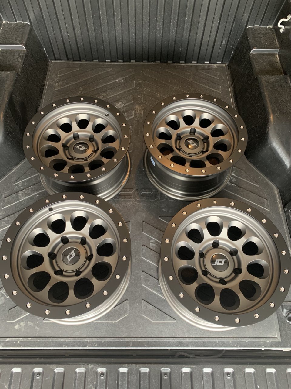

    Wheels and tires should be going on within the next day or two. I have my Ray10s in the bed of my truck just waiting for my local tire shop to call. I can’t wait. Still loving the Eibach setup, but ready to say goodbye to the stock wheels and tires. I’ll also be installing my ECGS bushing later this week or early next. 99C0624A-292E-4821-BE15-22F5566B5B29.jpg
