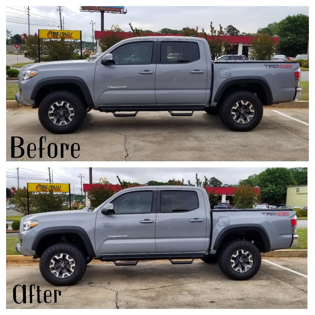

    Did you measure before and after? I'm always curious what the "real world" lift turns out to be. Looks great. Hope it rides great!

    Totally forgot to get the measurements before, but I would say I netted around 2.25" in the front and 1" in the rear with around .5" of rake. As far as ride quality, it's a night and day difference. No more bounciness and the front end no longer dips when braking.

    Yep. I netted 2.25" with the 1/4" strut spacer

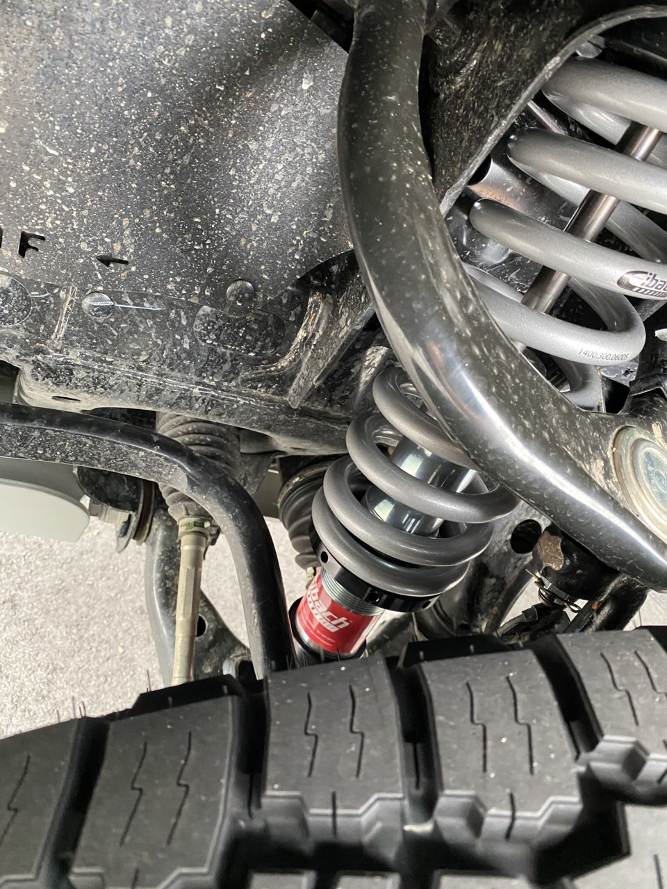

    111EA13E-9EC4-4031-A6FA-01845ED692DC.jpg Stage 2 installed over the weekend. Man what a huge improvement over stock. I did not get any measurements before install. I do need to come up 1/4 of an inch on the driver side but the tool supplied does not give you enough leverage to turn the bottom spring seat. Debating if I should just add the spacer on the top hat or make something beefy that will get that to turn. Other than that it’s worth the money! :thumbsup:
