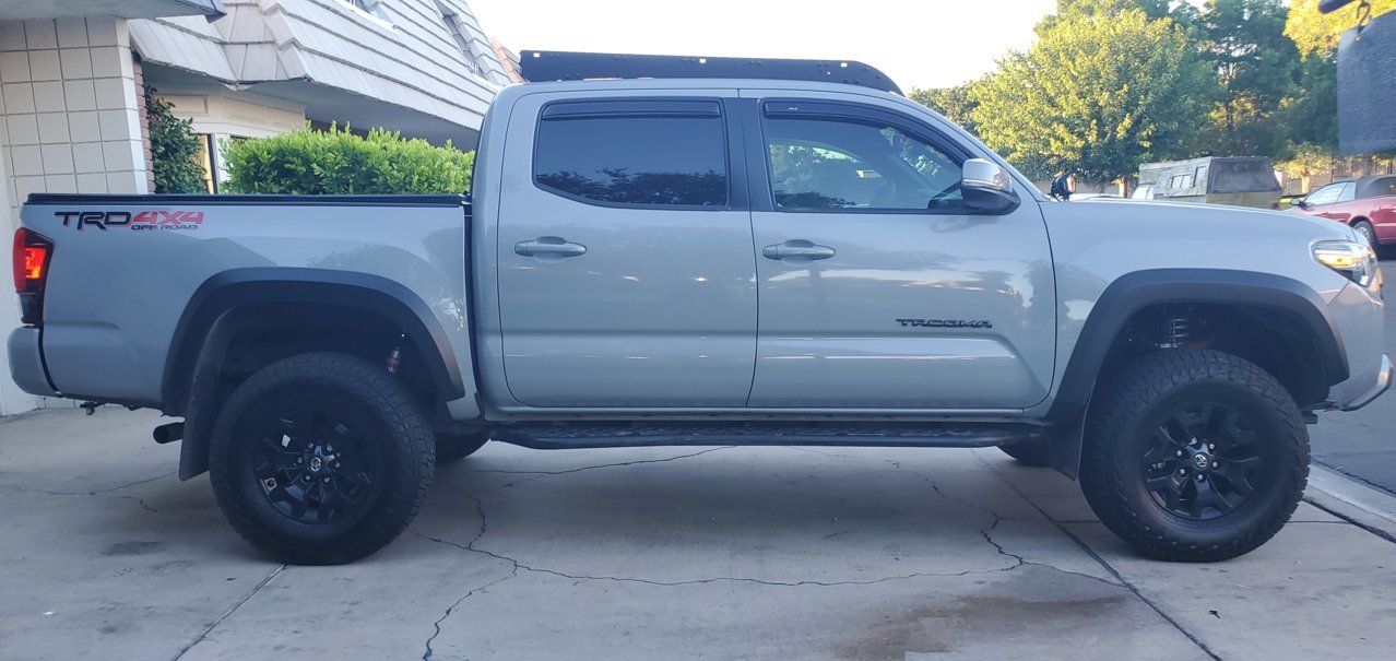

    2018 trd 4x4 short Bed, Cement
    20200520_190839.jpgone more flick , with my wheels murdered out.

  4. May 20, 2020 at 7:35 PM
    #2644
    Rawdoggy
    Rawdoggy Well-Known Member
    Jan 7, 2020
    #315438
    573
    Looks good. 1st clip?

    Desertacosauce
    Desertacosauce Member
    May 14, 2020
    #328034
    11
    2nd
    MrFixit420 likes this.

    573
    What’s in the rear?
  8. May 20, 2020 at 9:25 PM
    #2648
    Desertacosauce
    May 14, 2020
    #328034
    11
    A 2" aal from supreme suspension.... the 2nd perch is 2.5 in front... and the add a leaf states 1.5-2 of lift. Im guessing it gave me 1.5 of lift in the rear and the eibach rear comes 1" of lift, so 2.5 in the front and 2.5 in the back. Looks perfectly leveled

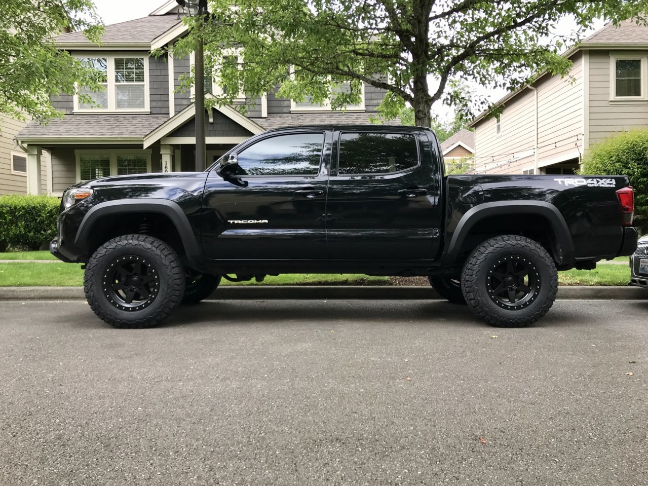

    Eibach pro truck lift, 1.5” maxtrac rear spacer, SCS BR6, 17x8.5, BFG A/T KO2 275/70R17.
    CFFCA093-A983-4461-B695-2153FFEDCF21.jpg Eibach pro truck set on the 1st notch. Maxtrac 1.5” rear spacer.
