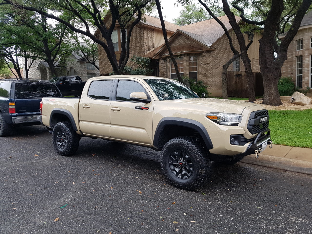

    I did mine jba uca way

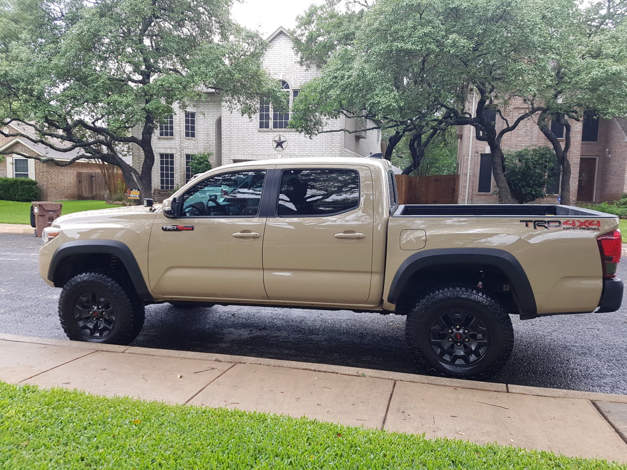

    20200520_190839.jpgone more flick , with my wheels murdered out.

    Looks good. 1st clip?
    Desertacosauce likes this.

    2nd
