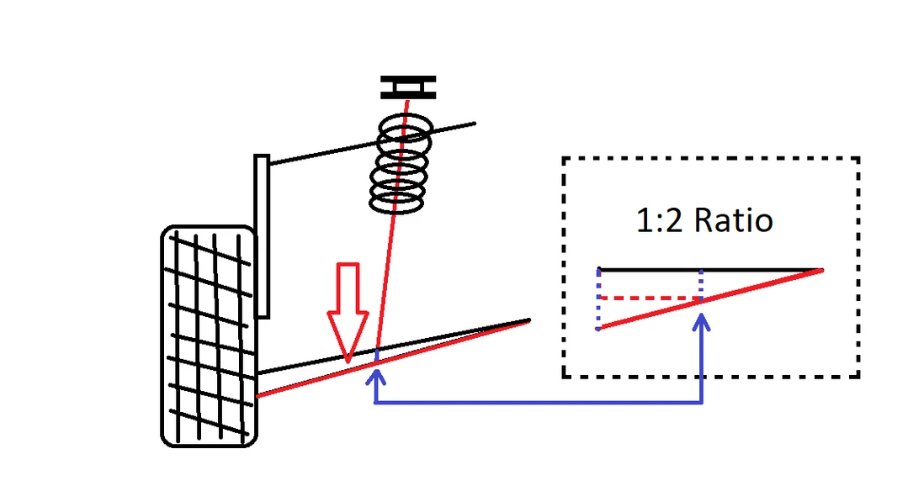

    @HeadStrong Off-Road what are your thoughts on using a 1/4" spacer on this kit (both sides) to get an extra 1/2" of lift versus disassembling and moving from the first notch to the second? I'm contemplating doing this for a couple reasons: 1) I'd like to get a little more lift yet retain the first notch ride quality, and 2) I don't want to have to disassemble the damn things to get that extra boost in ride height.
    Thoughts?

    Can someone explain how a 1/4" spacer can give 1/2" lift??? :confused:

    You can do that if you'd like. The 1/4" spacer will provide 1/2" of lift height. Having the same spacer on both sides will still result in the notorious taco lean.

    How does a 1/4" spacer give 1/2" lift?:confused:

    Geometry

    Never saw that equation in geometry class. Maybe you can expand on that answer.
    So does moving the clip up from a lower setting 1/2" give it a 1" lift too? If not why?

    Beat me to it.... all has to do with triangulation and leverage arms. When you make a change in height close to the pivot point, in this case increasing the distance via a spacer, the magnitude of that displacement is exaggerated as you move outboard along the leverage arm (LCA) from the pivot point.

    Thanks. I knew there was a reason but sometime you just need to see it. :thumbsup:
    So does the same go for the clip on the spring? If it goes up 1/2" does it actually go up 1" on the truck?
    I am thinking of taking out the taco lean and want to get it right. Should have put a spacer in from the start.:(

    Different type of action than a spacer. Moving the clip preloads the spring yielding a taller (stiffer) ride height. I think if you used the clip position to eliminate the lean the suspension would not be symmetrical, not sure if that would be a problem or not. May yield uneven wear on components down the road...
