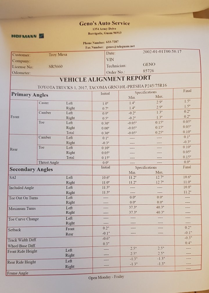

    Just got my alignment done. Techs that did the work said there was not much adjustment needed and said that I could go to 33's in the future with a little trimming and asked who did the lift. Told them it was done at home and complimented on it. No CMC needed. Just got my tires so might be doing that later. Ride is very comfortable and driveline angles are good to go. Going to do a chalk test and argue with myself if I want to smooth out the ride or go for MPG. No vibrations whatsoever and am loving my lift. This Eibach kit is well worth the money and highly recommended. Now I'm going to save up for step bars or sliders.

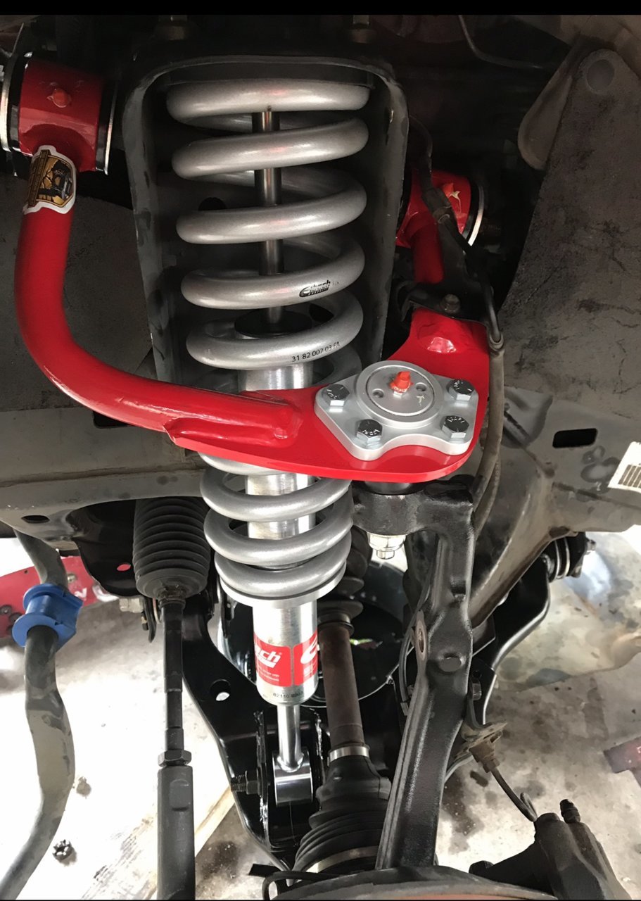

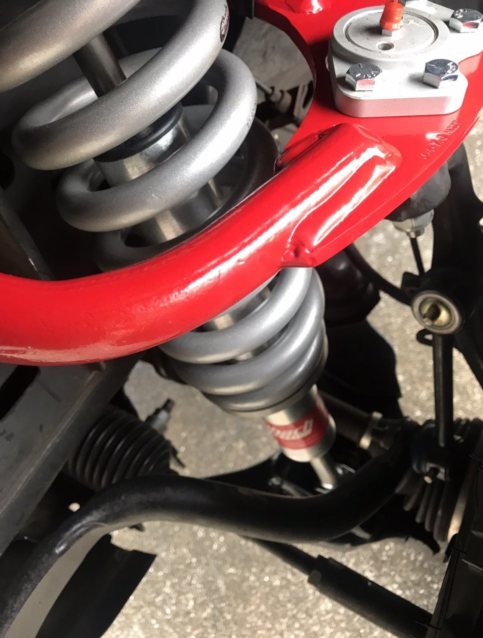

    Finally got my lift installed and I love it. I’m maxed out- 2nd clip. I haven’t measured but it’s easily 3-3.5”. I have a 6mo old TSB leaf pack just threw on cheap single AAL for the rear. I replaced most my suspension while I was at it. Love it. Maybe I’m in a honeymoon stage or I’m used to my shot suspension but it’s super comfy. Cv angles are wild lol but whatever.

    Brother just noticed in your pic of the front suspension, is your steering tie rod not backed up to lock in place?
  19. Jun 3, 2020 at 7:47 PM
    #2879
    07tacomatoy
    07tacomatoy Shoots den
    May 2, 2017
    #218020
    136
    Pacific Ocean
    2007 4x4, 2019 TRD SPORT 4x4
    No it wasn’t installed properly, we were still putting everything back together at that point. It was one of the only pics I snapped before tires went back on and blocked my view of the setup.
