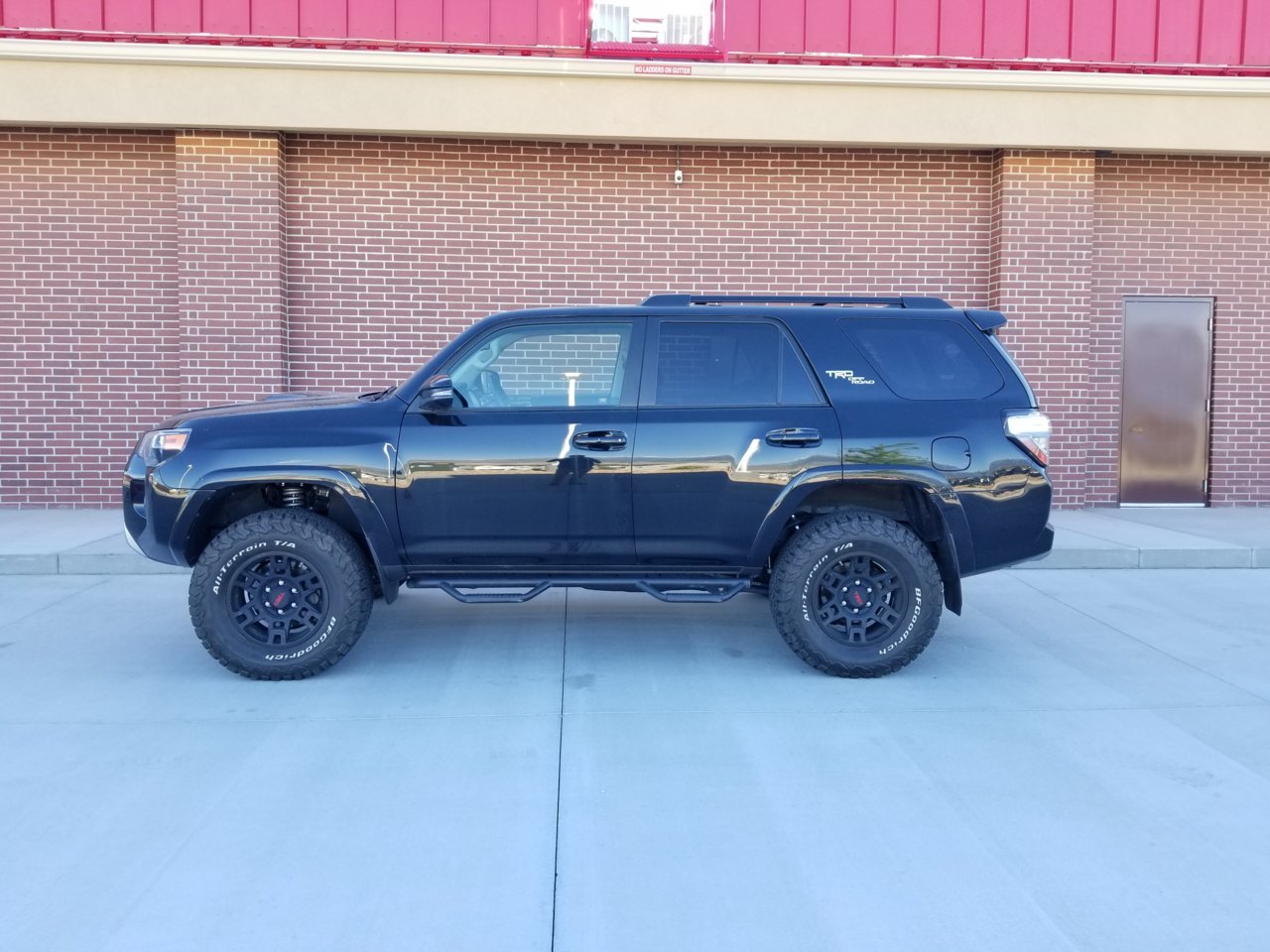

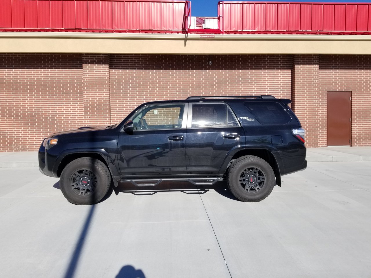

    May not be a Tacoma, but this thread 100% convinced me to pull the trigger on the Pro Truck Lift for my 4Runner.
    WOW! What an improvement over ride quality. Eibach lifts for Toyota's are for sure a hidden gem. Ride quality, looks, build quality, and especially price point have almost every lift beat IMO. Check out @Mike's Custom Toys. They had the best price that I found.
    Before:
    After:

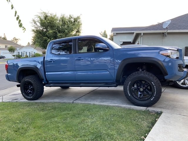

    Just lifted my truck. Added 1/4” front driver spacer, ECGS clamshell bearing, icon 1.5 aal, and spc uca. Now I need bigger tires, looks kinda funny.
  4. Jun 11, 2020 at 9:50 PM
    #2944
    DTaco22
    DTaco22 Well-Known Member
    Dec 19, 2019
    #313752
    671
    Darian
    17' Taco. TRD OR
    3" Eibach lift, JBA high caster upper control arms, 2" ToyTec add-a-leaf
    Looks good! Did you get any before and after measurements?
    How does it ride?

    2019 trd offroad dcsb cavalry blue
    Unfortunately I didn’t.

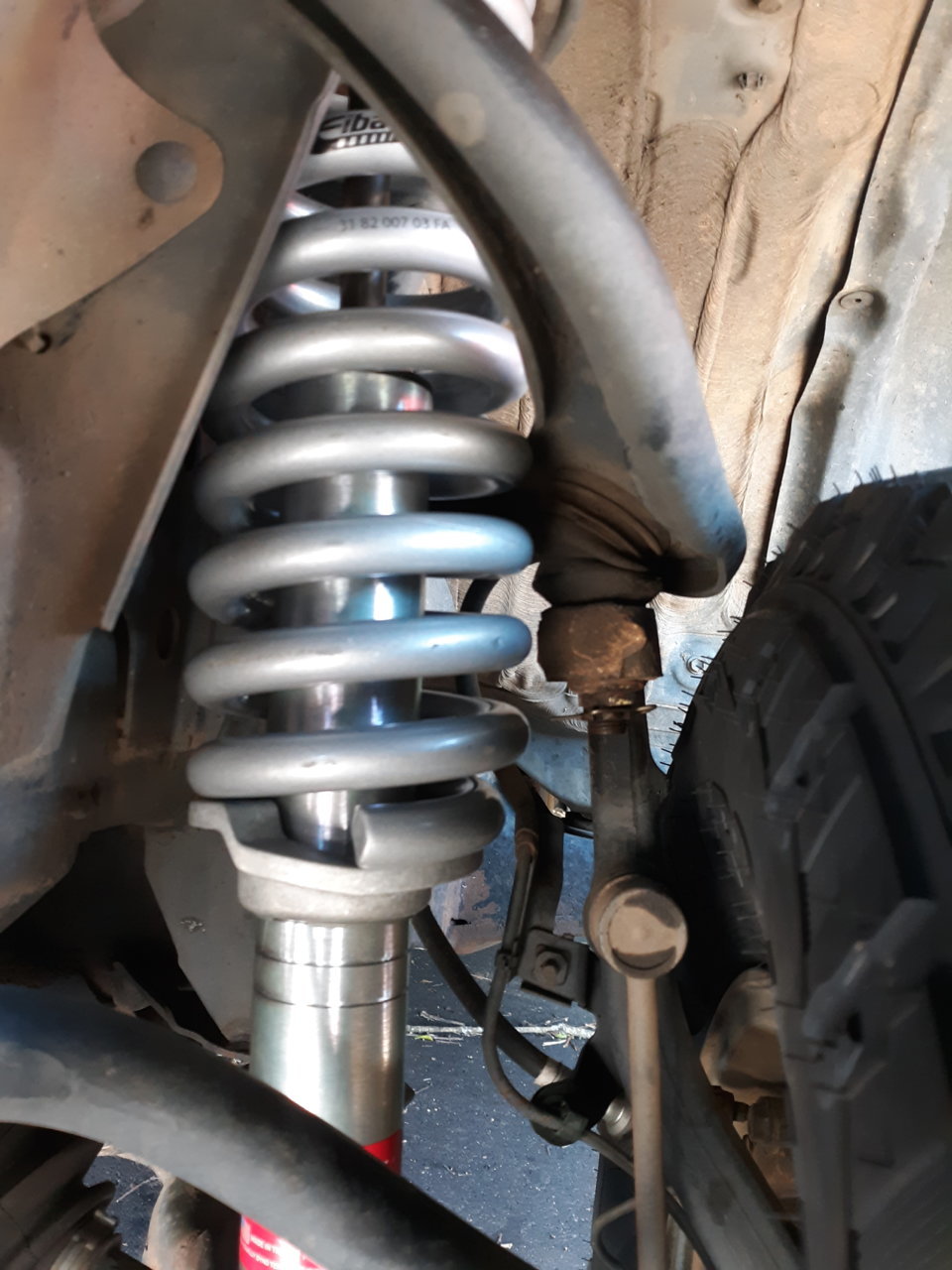

    I finally got mine put on. I have an issue though. I went with the third clip because I'm also adding a c4 bumper with a winch. But the issue is my upper control arm is touching the spring. Will that change once the weight is added? Is something else wrong? Will dropping it a clip fix it?
  7. Jun 12, 2020 at 9:20 AM
    #2947
    Mike's Custom Toys
    Mike's Custom Toys Well-Known Member Vendor
    Jun 28, 2017
    #222593
    1,096
    Grants Pass, OR
    Your spring seat is on upside down
    Gs4x46mt, Pritch, patdeezy and 2 others like this.
  8. Jun 12, 2020 at 9:22 AM
    #2948
    banditcamp
    banditcamp Well-Known Member
    May 23, 2018
    #254335
    1,835
    daniel
    2015 Super White DCSB Off Road
    Really? That's how it was when I opened the box. Is the spring suppose to be all the over to where the spring seat comes up? Its currently in a spot where it dips a little before going back up

    Sorry mate, but it does look like it's upside down. The image in the first post you can see the bottom of the spring seat, opposite of yours mate. It's gonna have to be removed and reassembled properly.

    Lovely

    Yeah it's quite tall. I didn't expect to to be that high. I got it done by an off shop.

    Yeah definitely upside-down spring perch. Needs to be redone. Shop should cover any further costs and/or damaged caused. Also may consider going to a different shop. Sorry bud.
    Gs4x46mt and banditcamp[QUOTED] like this.

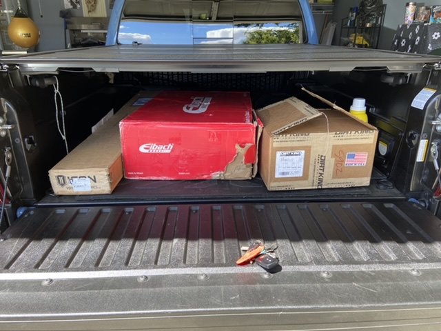

    Just got it done yesterday. I posted a pic yesterdayE2D1C5BB-8FC5-4A1B-839E-4CCEF8631481.jpg AB17D465-7A98-4FDD-999F-5E0524C7781F.jpg . I got talked out of installing the Dirt King UCA and ended up installing SPC. Time to return the Dirt Kings.
