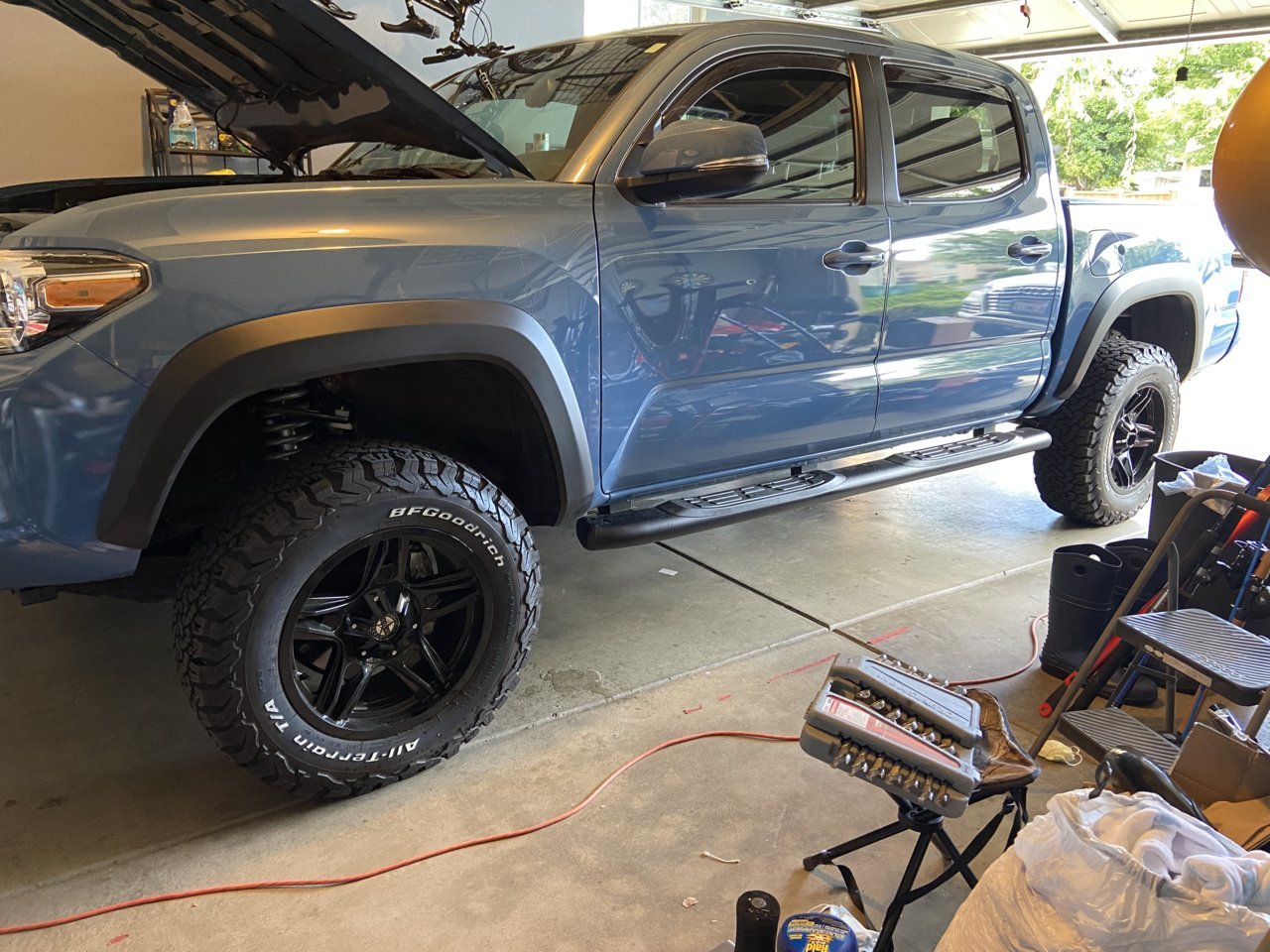

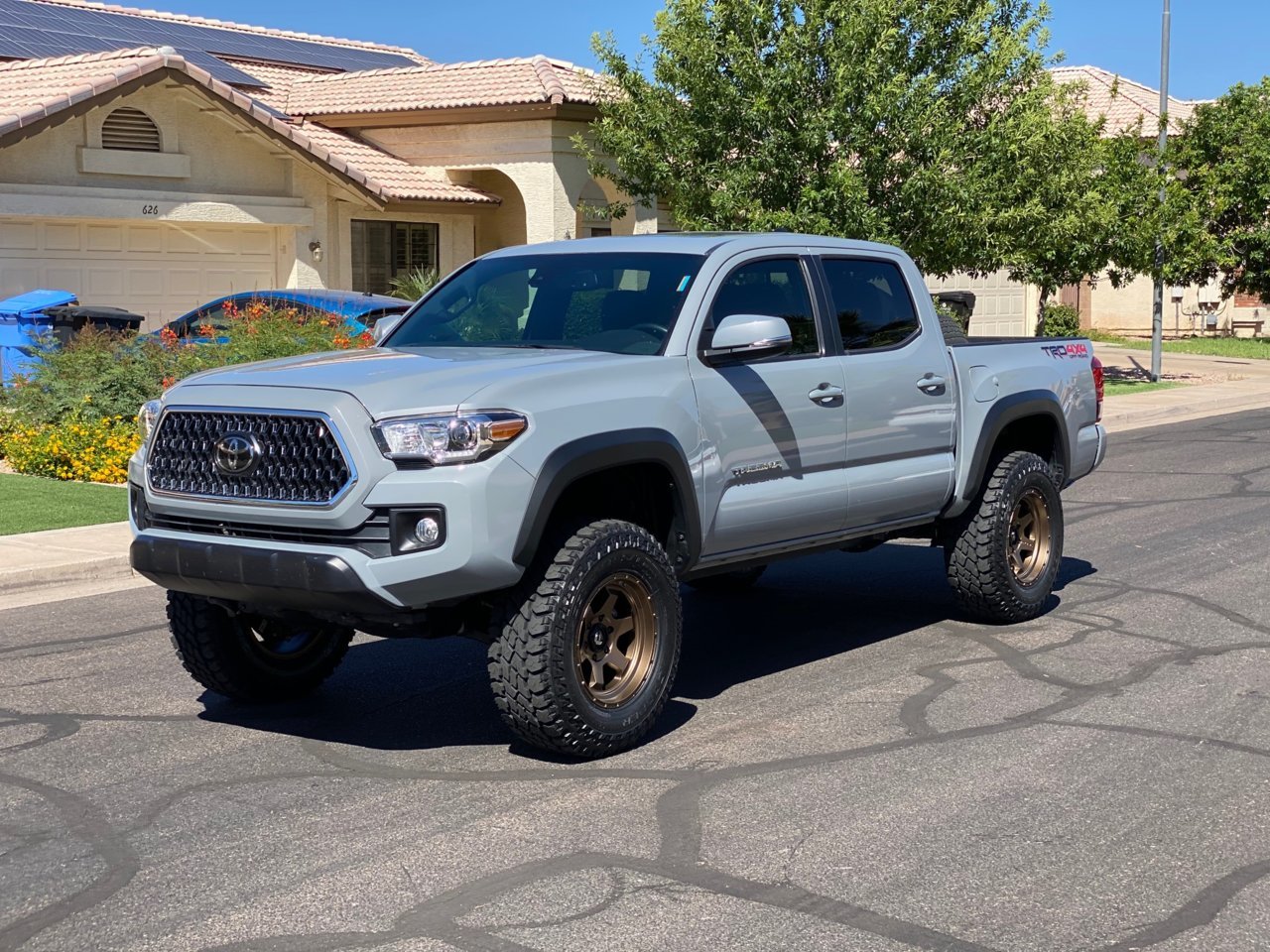

    -Eibach pro truck lift -All Dogs Off-road rear Progressive AAL -Stealth Custom Series F5, 0 offset, bronze -285/75 16 (33.1) Yokohama Geolanders
    Ha! Thanks, good eye on the bike!
  5. Jun 14, 2020 at 12:22 AM
    #2965
    Legionaire
    Legionaire Member
    Sep 2, 2019
    #304040
    14
    2019 Cement TRD OR DCSB 4x4
    Fox 2.0 snap ring, 2.0 w/res rear, 285/70r17 Toyo Open Country AT3.
    Damn looks good, did you gain 2" of lift? Any rubbing? Thanks

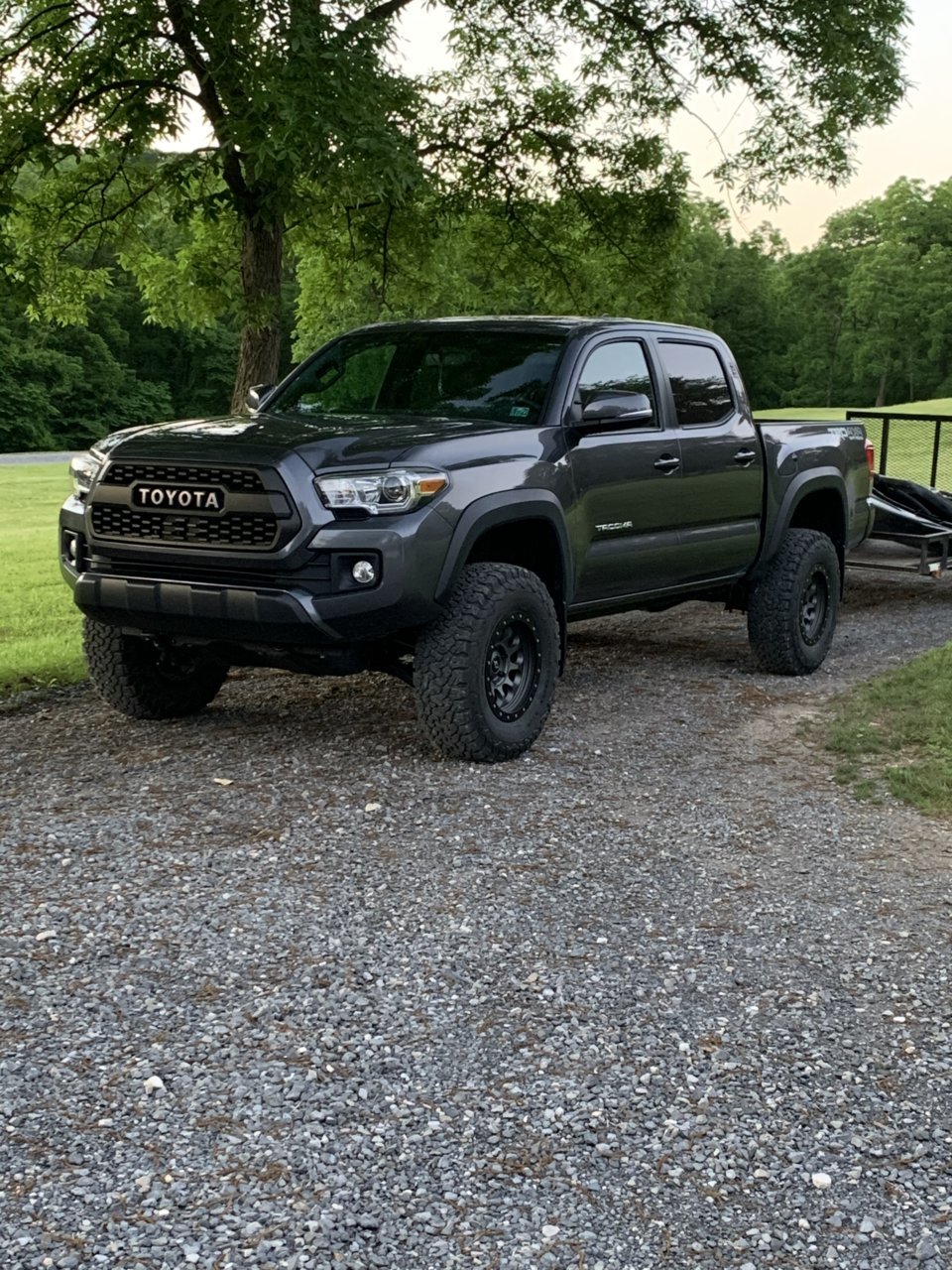

    Eibach Suspension, JBA UCA’s, 16” SCS Ray 10s, BFG KO3s, ECGS Bushing, Pro Skid Plate, Fumoto Valve, Pro Grille, Opt7 Tailgate Light Bar, AVS Window In-Channel Vents, Roknlokz XL Mud Flaps, Husky Floor Mats, Bed Mat, Tailgate & Glovebox Letter Inserts, TRD Grille Badge, Exhaust Tip, Toyota Hitch Plug.
    FA7B1E0A-7F89-4F8E-88FD-5EE6FEE6516A.jpg 50B10648-4DC8-49F6-A252-2481B54D6C4D.jpg
    Was heading kayaking the other day and snapped some pics. Thought I’d post them up to help people who are researching this kit. I know this thread was a big help to me in my decision making process & hope I can help others.

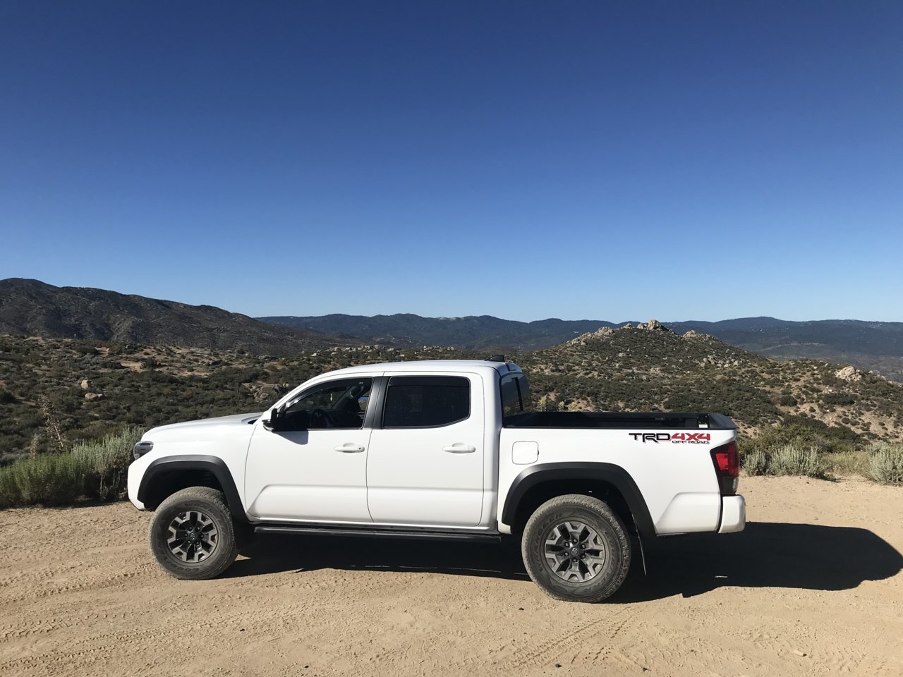

    Took the taco out on a shakedown run before I switch over to the Stage 2 this coming week :thumbsup: non technical trail, 3N14 Coxey truck trail in San Bernardino Mtns in SoCal for those local and want to check it out. Sorry for the crappy and repetitive angle. I wish I was more of a photog

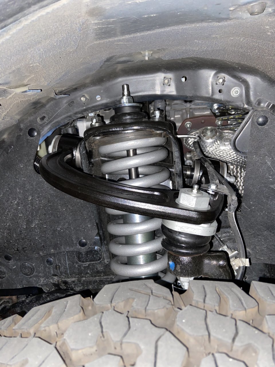

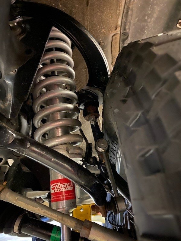

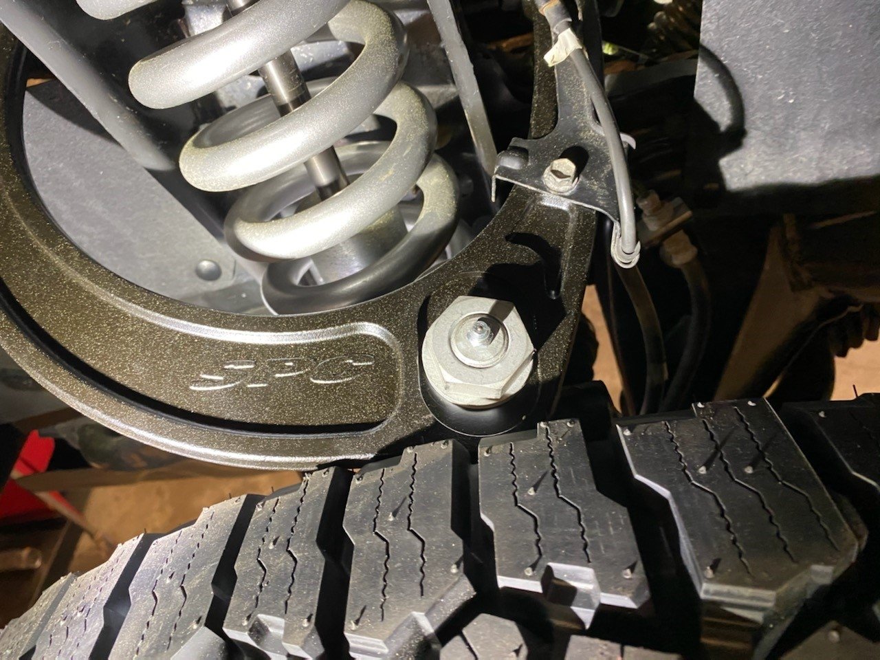

    I am hoping someone can help me out. My truck is getting tires installed and an alignment. They are telling me that the 285/70/17 falken wildpeaks are rubbing against my spc upper control arms. I believe it hasnt been aligned correctly. Has anyone else had this issue or able to help? Running the pro stage 1 on the first clip.
    edit - stock sport rims
    Edit x2 - they were able to align everything properly. The UCA sits about 1/8" away from the tire. Updated pics to come soon
    Below

  16. Jun 16, 2020 at 11:15 AM
    #2976
    FRESH OJ
    FRESH OJ Well-Known Member
    Jun 26, 2019
    #297514
    106
    Rhode Island
    2017 Tacoma Sport
    Stock sport rims
  17. Jun 16, 2020 at 11:18 AM

  18. Jun 16, 2020 at 11:38 AM
    #2978
    Azdvo
    Azdvo DuneFreq
    Apr 6, 2020
    #323949
    64
    Shawn
    Yuma, AZ
    2020 TRD 4x4
    Eibach Pro Lift - Toyo AT3's 285/70/17
    Yah Spacers will be a quick fix but then youll need a 0 offset rim or negative, but then negative will cause some rub.
    FRESH OJ likes this.
