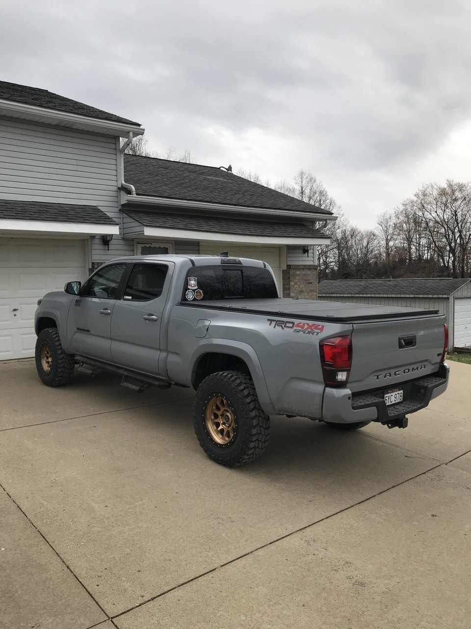

    Got the Eibach stage 1 pro lift kit put on this weekend,, I went with the 1st notch, JBA UCAs , Toytec Boss Rear Shocks, And Toytec 1.5” rear blocks. The UCAs where a PIA to put on but there worth it (14 gauge bushing spacers are extremely tight but a small pry bar helps to get them in ). The ride is awesome just a little stiffer than stock!! Pics to come

    Lookin good! I've used a sliding adjustable arm once before and had trouble keeping alignments. Does the JBA have something to keep them locked in place?

    Are these measurements from center axle to fender?

    Correct. I gained approximately 2" all around. Factory is 21" front and 22" rear.
