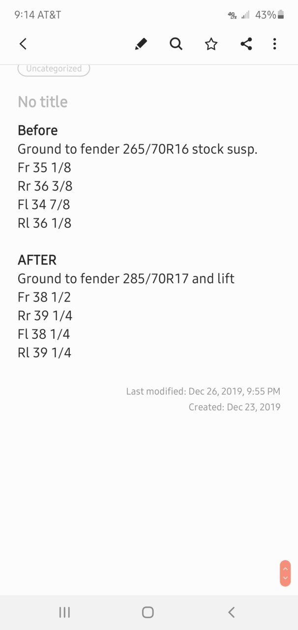

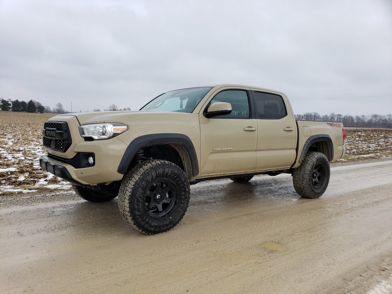

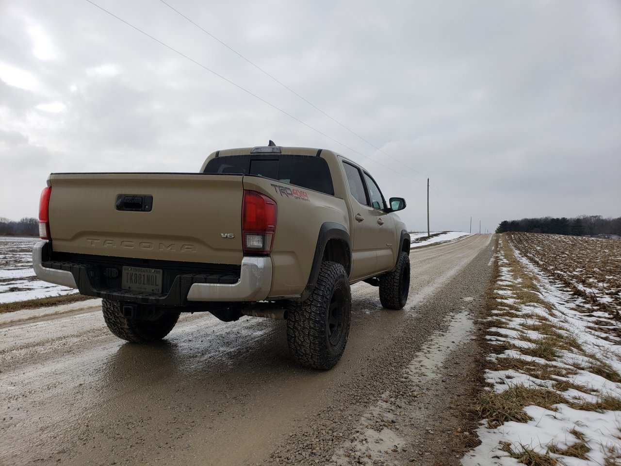

    Wow this thread has blown up. Been on hiatus since February or so lol. I've seen alot of people asking about before and after measures and ill share mine. I've put around 5k on my stage 1 setup on my 2019 offroad. 285/70r16 falken wildpeak at3w with fuel shok 16x8 +1. Im on the 2nd notch, deaver aal, spc uca, 1/4 spacer on ds for taco lean. Everything I got from toyotec lifts. No sway bar mount kit. No drop kit. Replaced ecgs while I was doing the lift. 95% on road sadly. These measurements are after a few days after install and I have not checked for any change. Hope this helps.

    Looks great bro!

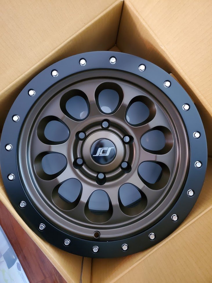

    My wheels came in today and tires show up tomorrow. Just need the Eibach kits to be in stock and I'll be good.
