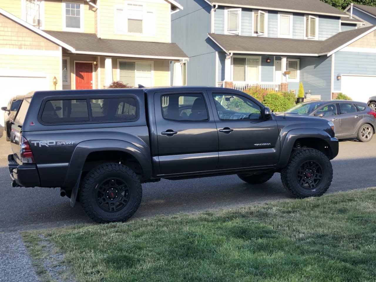

    Hah. Yes. CMC with -12 and a little trimming of the front bumper. And front mud guards removed. But I’m very happy I did. I debated for a LONG time between 265/75 and 285’s and I have zero regrets. I have Falken Wildpeaks and as far as I am aware, they only come in load range E. They are definitely a bit stiffer than what I had in the past, but nothing that I lose sleep over. My father had an ‘89 SR5 and I can always remember him telling my mom “it rides like a truck should” whenever she would say it was “bumpy”. That’s the best way I can describe it. It rides like a truck

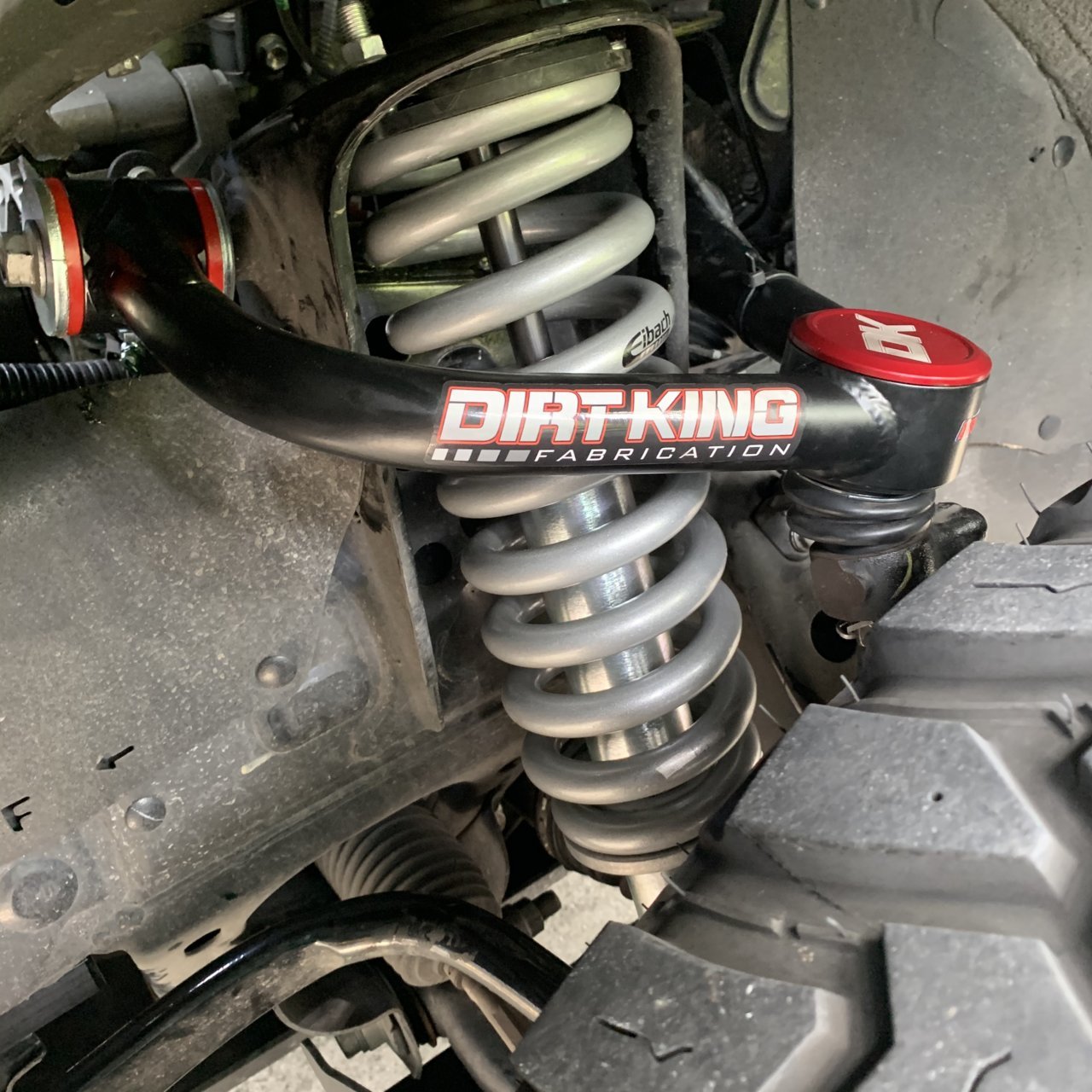

    Installed the Eibach stage 1 with DirtKing UCA and Wheelers add a leaf kit. I had a spacer lift on before, this sits higher and is more planted on the road. Gonna have an alignment done tomorrow.

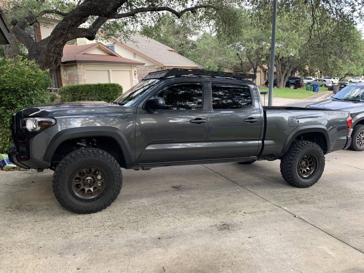

    What size tires are you running? Any chance of a full truck picture?

    285/70R17

    Looks great! Thank you!
    What notch are you on?
