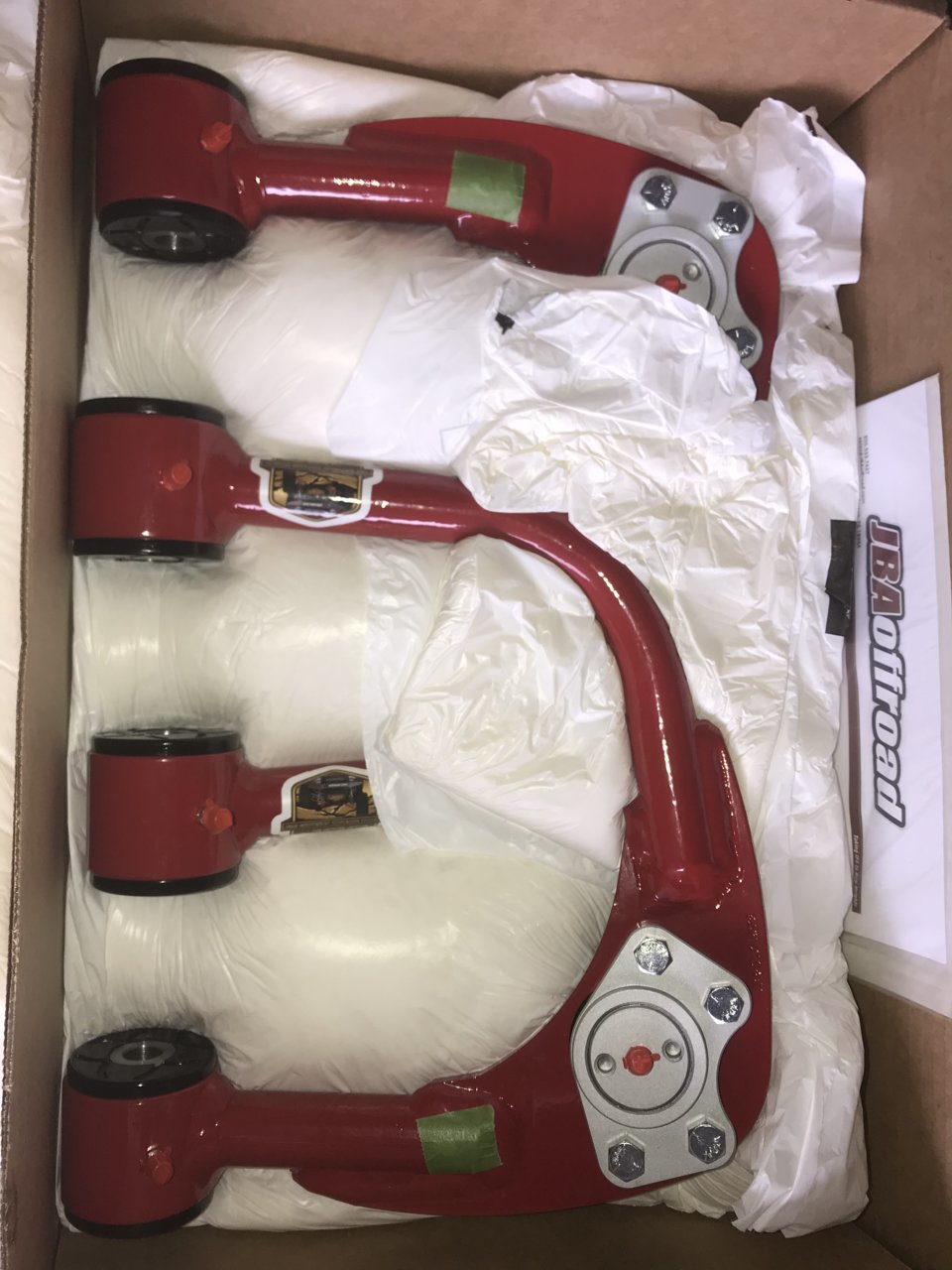

    Well, the first part has landed.

    My first part of the puzzle came today. Now waiting on wheelers to get my stage1 delivered 82EDEC20-734A-48EE-9301-E1EF30418085.jpg

    Very nice! I have the exact same set of JBA'S on order right now too.
