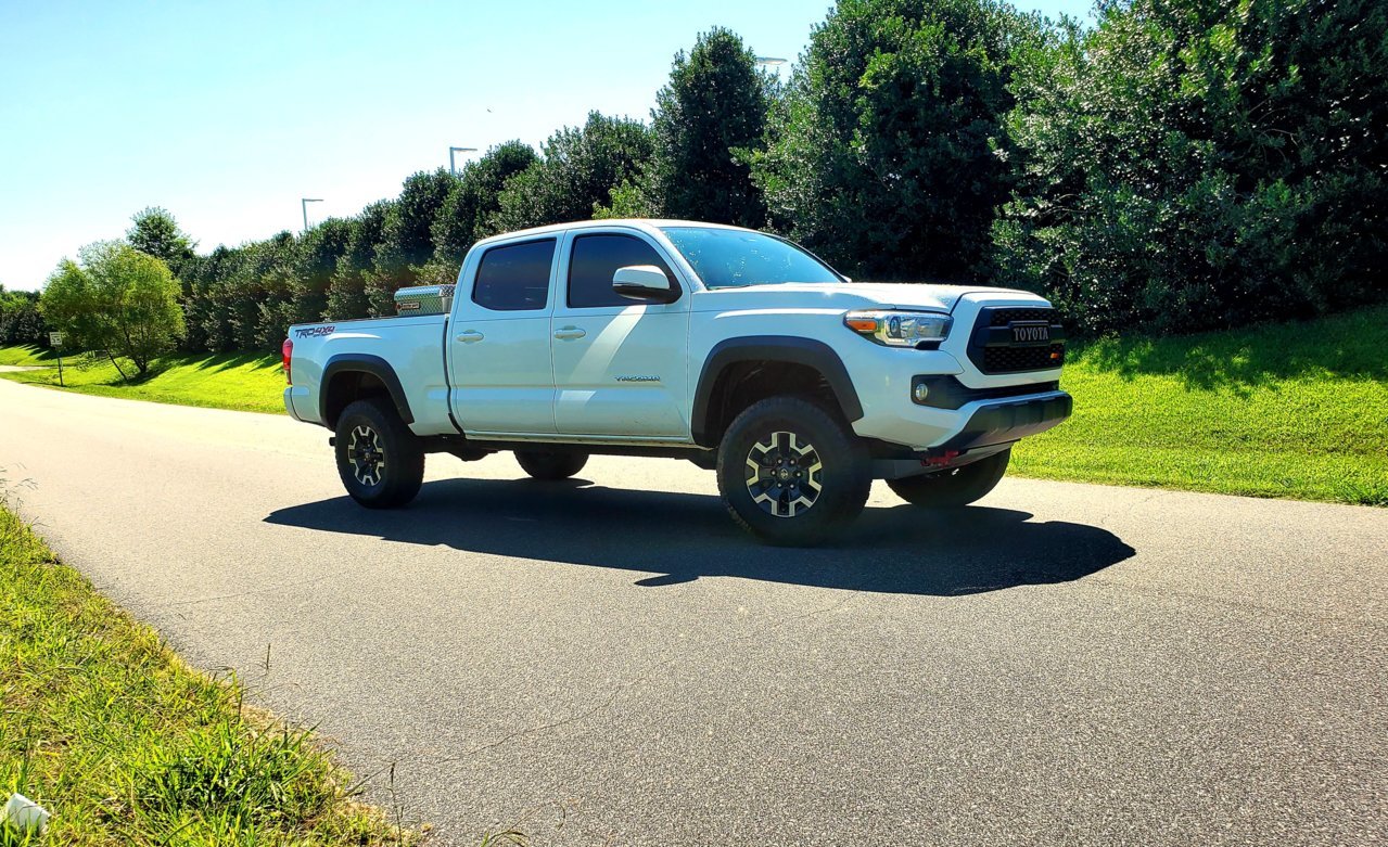

    Followed this thread for weeks before I purchased the kit. Put the kit on a few months back. No complaints.
    2nd clip, SPC UCA's, Dobinson rear leaf pack.
    heel_touge and Dave13 like this.
  9. Jul 11, 2020 at 1:13 PM
    #3169
    Brownie_Man
    Brownie_Man Well-Known Member
    Sep 21, 2019
    #305897
    881
    Maine
    2019 Off Road
    Grips the hills well....
  10. Jul 11, 2020 at 1:15 PM
    #3170
    derek3988
    derek3988 Active Member
    Mar 19, 2020
    #322479
    30
    Derek
    2020 Tacoma OR
    HAHA that's about it so far. Terrible pic I know.
    Brownie_Man[QUOTED] likes this.
