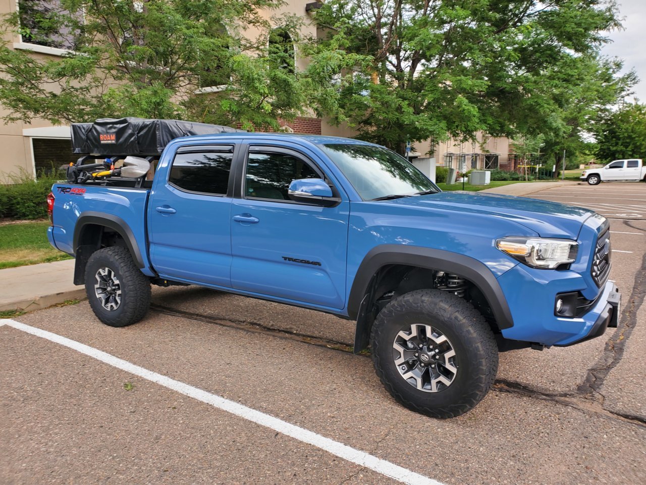

  13. Jul 20, 2020 at 10:08 PM
    #3233
    ContourEclipse
    ContourEclipse Well-Known Member
    Dec 1, 2019
    #312173
    78
    Austin
    2019 Cavalry Blue DCSB TRD Off-road
    Interior, mud flaps, tail gate,
    Installed my Eibach kit and HD DAKARS in the back. The ride is so smooth! I love it! Thanks to Marie @HeadStrong Off-Road for all the help!

  14. Jul 21, 2020 at 6:41 AM
    #3234
    burnt_taco
    burnt_taco Well-Known Member
    Mar 30, 2017
    #214920
    309
    3rd Gen Tacoma Limited 4x4
    Which notch setting are you on?

    First notch
    burnt_taco[QUOTED] likes this.
