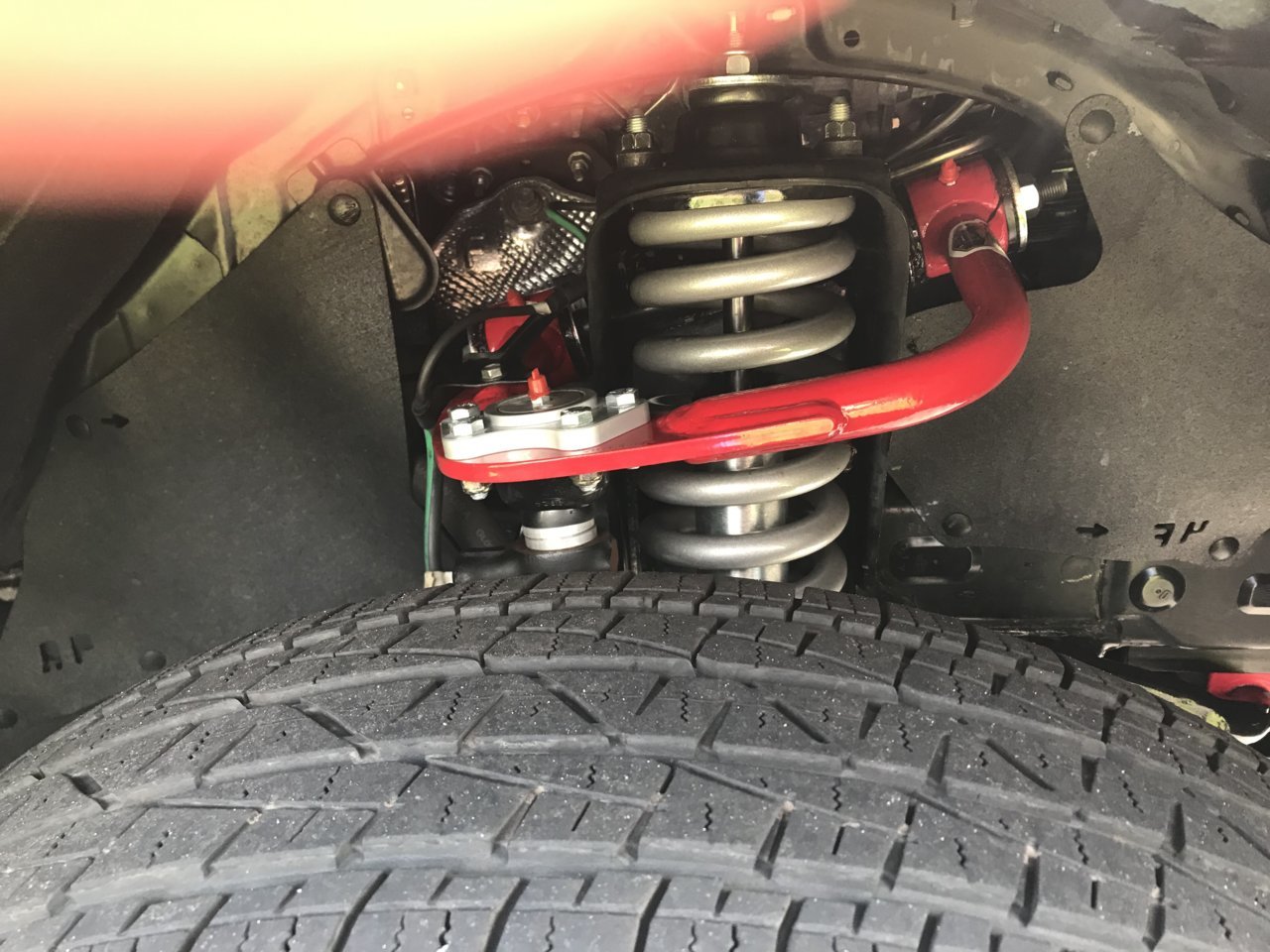

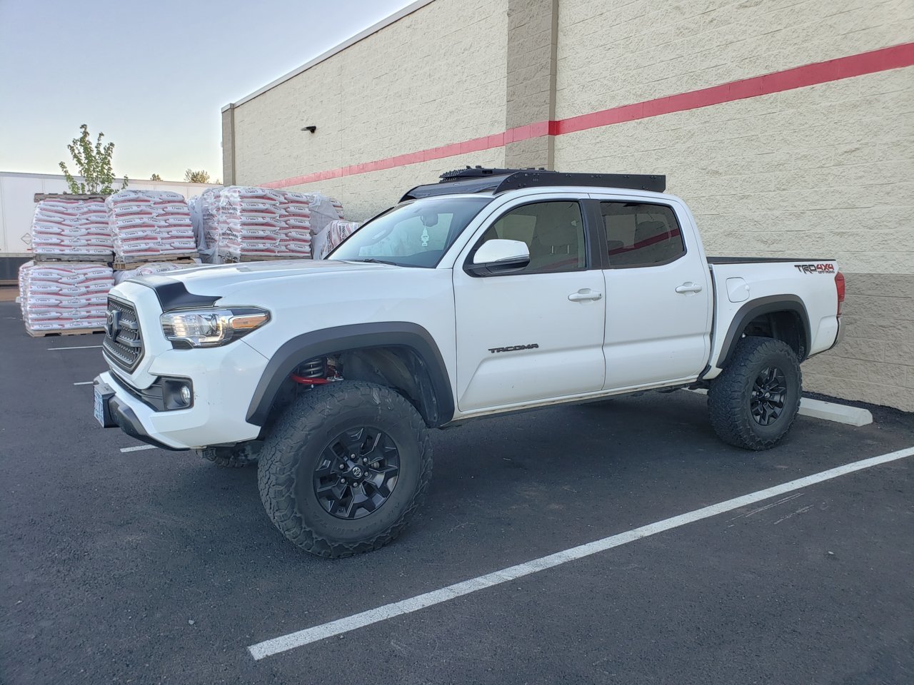

    Alright, so I have finally gotten everything installed and tested.
    What I ordered was...
    Eibach Pro Lift (set at 2nd notch)
    JBA High Caster upper control arms
    Wheelers Offroad ¼" aluminum lean spacer
    Toytec add a leaf by Deaver (nets 1½"-2" lift)
    3° rear axle shims
    Toytec 7½" extended U-bolts
    1½" wheel spacers
    I am currently running 285x75x16's with factory wheels and ZERO rub.
    What I was previously running was the Low Range Offroad 3" front, 2" rear level lift (spacer lift)
    It was pretty stiff but did its job of lifting the truck in a cheap way. Running that kit, I was not able to get a good alignment though.
    Installation...

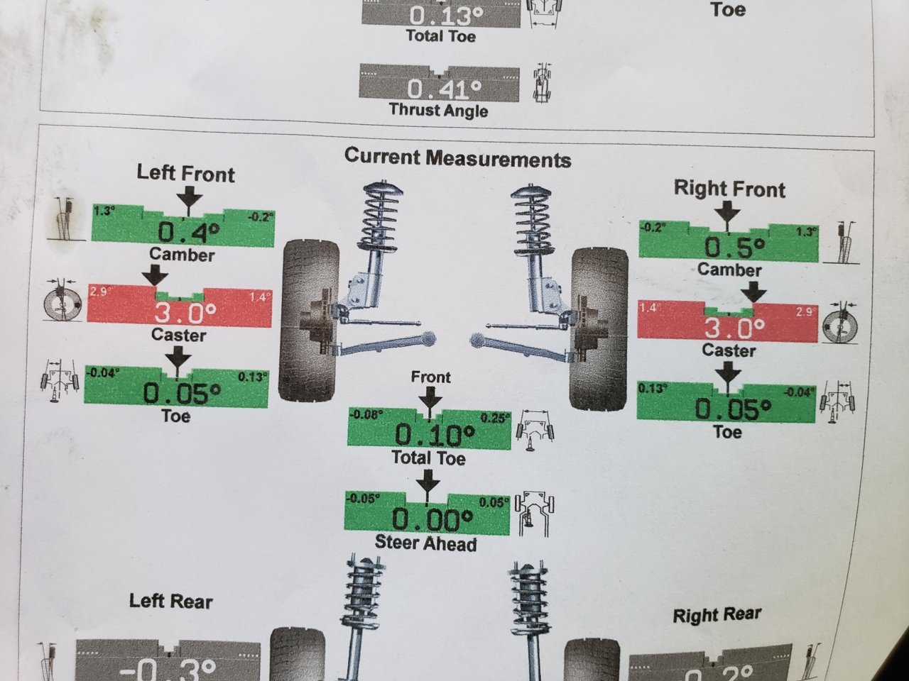

    I called around to local shops for quotes, just to find that Toyota WILL price match other shops labor rate, which I never thought was a thing with the dealer.
    After it was all said and done, Toyota installed the UCA's for $250.00 and installed the suspension and add a leaf for $375.00. Then, since the install took longer than they had originally said, they took off another $50.00. So, $575.00 installed with an alignment and done by the dealer.
    Running the Eibach Kit at 2and notch with the Toytec add a leaf gave me just over an inch of rake, (barely noticable).
    The Eibachs are incredibly smooth. The only way I can describe them is firm, but it feels the way the truck should have felt from the factory. I no longer experience the spongy feel that I had before the spacer lift or the jarring stiff feel after installing the spacer lift.
    The JBA upper control arms were able to give me an ideal alignment with the stability and control that really make a huge difference. The truck honestly just feels more grounded and a lot more stable.

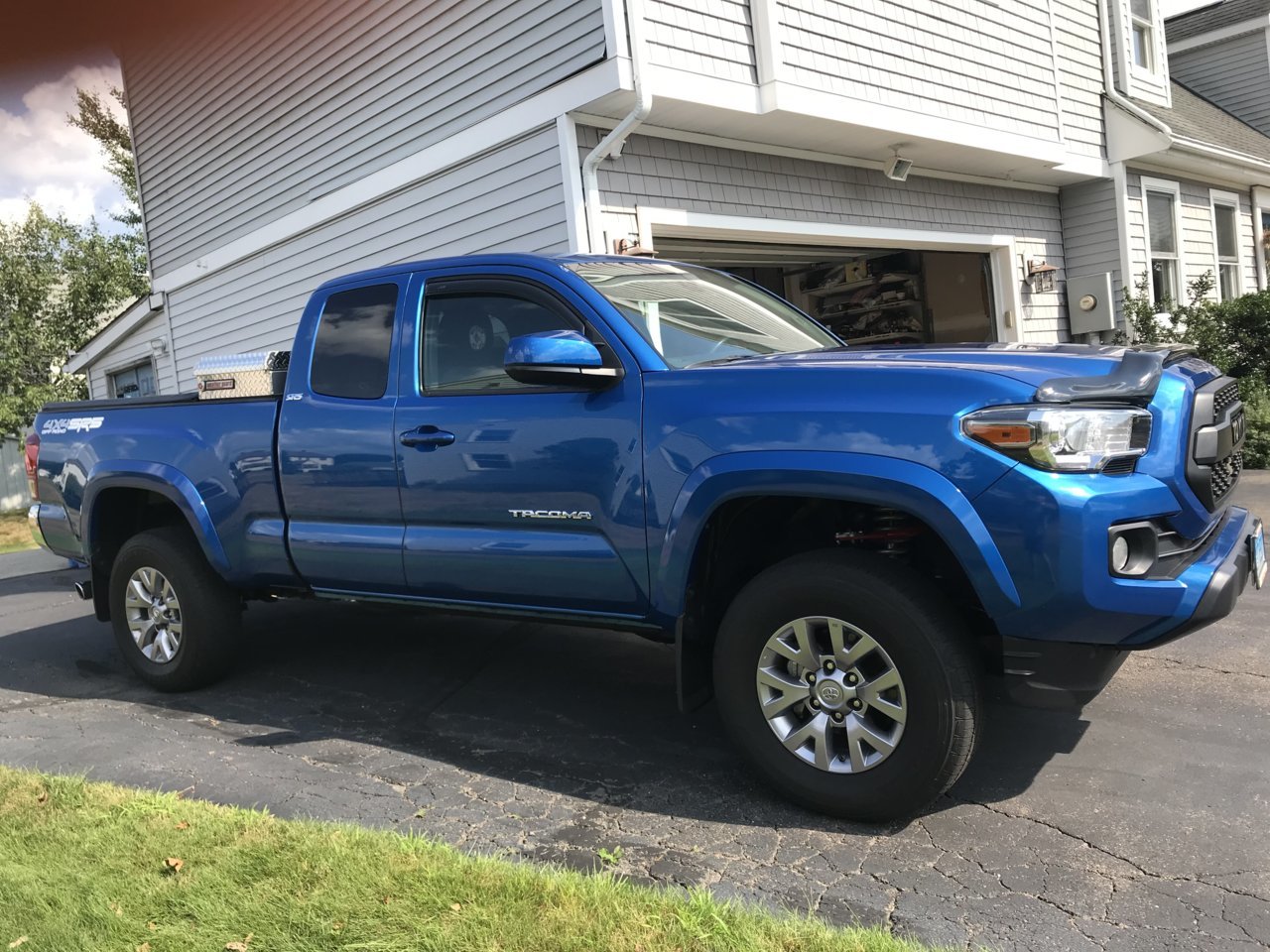

    Did you need the 1 1/2” wheel spacers to clear the tires or did you do it for the looks?

    I needed it to clear the tires from the factory upper control arms originally.

    I just installed the same setup you have except I’m on the first notch (2”) and was wondering if I can get 285s in without the wheel spacers. So do you still need the spacers to clear the JBAs. TIA

    I dont believe I need spacers to clear the JBA's. I'm on stock wheels so that's my only reason for continuing to run them. However, you need them if your running fa story UCA's.

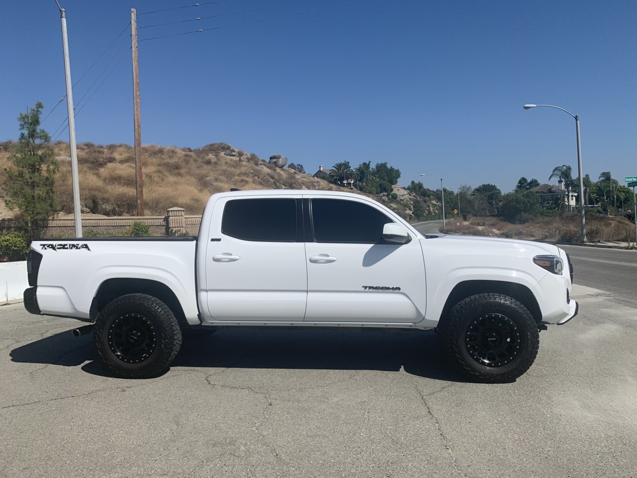

    Thanks I have the JBAs and 16” wheel but I think I’m going to put on some 17” 4 runner wheels with 285s 3598E343-0AF9-441B-97F3-5EA334F9DDEB.jpg0A4C71C6-5614-4425-B628-613E746D6310.jpg

    Looks great! I really like the 4Runner 17's also

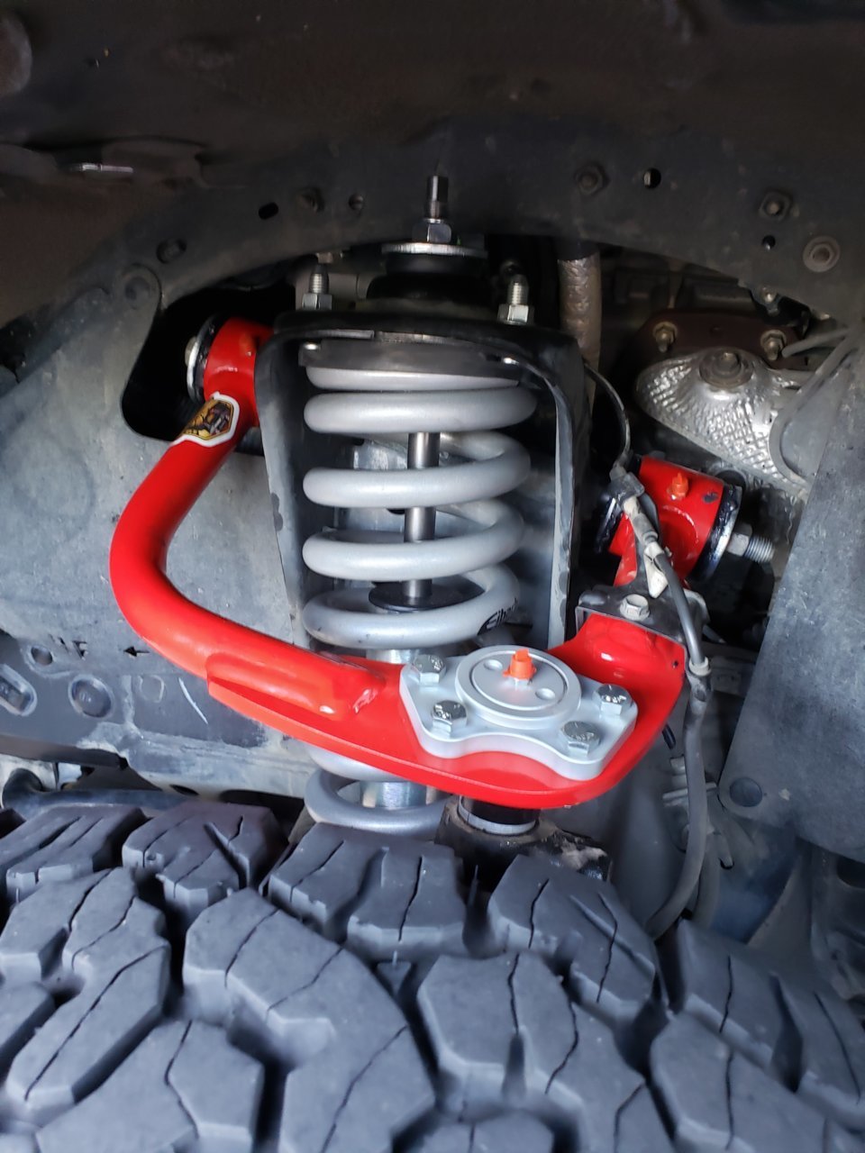

    Some before & after pics on my install of the Eibach Pro Kit!

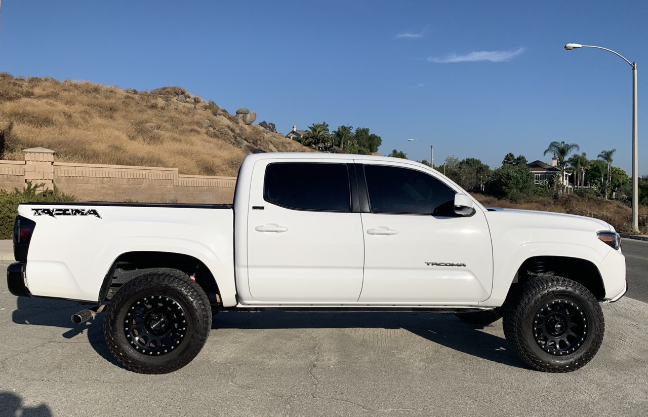

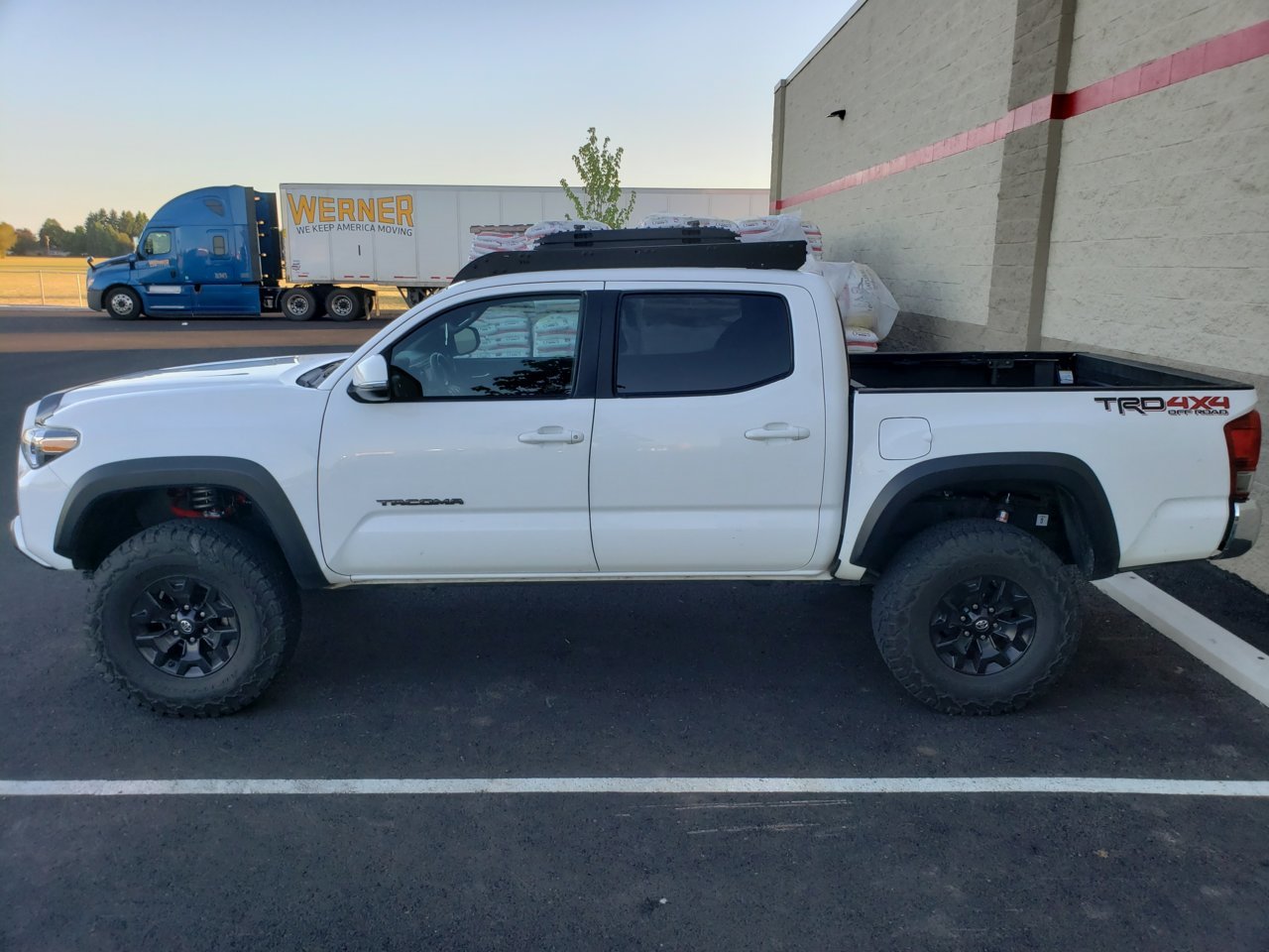

    IMG_20190305_051932_958.jpg 20200809_065021.jpg@j10munoz here is my before and after. The first one was before the spacer lift and the last one is today.

    Thanks brother! It ended up being 3" in the front and about 3½" in the back

    These are my measurements when stock with factory tires...
    FR-35¼"
    RR-36½"
    These are my measurements after installing the level lift. (Before)
    And my new measurements with the JBA UCA's and Eibachs.(After)
    Before
    FR-38⅞
    FL-38⅜
    RR-39½
    LR-38¹⁵/¹⁶
    After
    FR-38½
    FL-38¼
    RR-39⅝
    LR-39⅜
