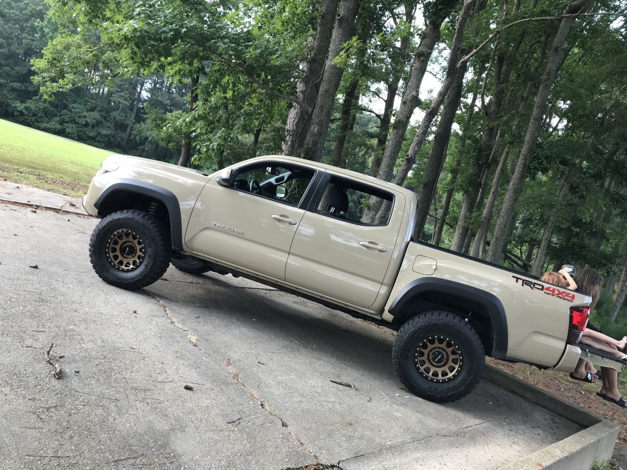

    I got my kit installed yesterday! Front is set on the first notch with 1/4” spacer on the driver side for the taco lean. Rear is a 2” AAL from wheelers. Tires are 265/75R16
    Here are some before and after pics!
    8CC2FB4B-E225-4506-938D-AEB51D621B48.jpg 82C149D4-84D9-4F10-8247-9C65D1FA28FE.jpg

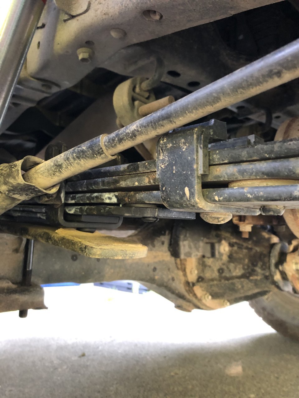

    Kicker speaker upgrade Rockford Sub TRD Grill Raptor Lights Oedro Running Boards Seat Covers Black Emblems MBRP Exhaust Sound dampened doors Blacked out turn signals Pro comp 7069 wheels BFG KO2 285/70/17 Ram mount Joying Head Unit Fogs Soft topper canopy Fox 2.5 RR DSC Fox 2.0 RR rear HS AAL 1.5" rear plus overload (2" total) Center console divider Axe/Shovel Mount Traction boards 32" light bar Shift sense pro v2 iDrive throttle controller Xentec 35W HIDs Vair 88p air compressor Dome LEDs LED reverse lights + pods JBA Upper Control Arms Full size spare tire Driver seat riser
    Installed my Eibach coilovers and HS 1.5” progressive AAL. Love the ride! I see now why Headstrong recommends removing the factory overload, as you can see the rivet contacts the overload. I may cut/shorten the overload by 4” in the front so the rivet clears and I still get 1/2” of additional lift
