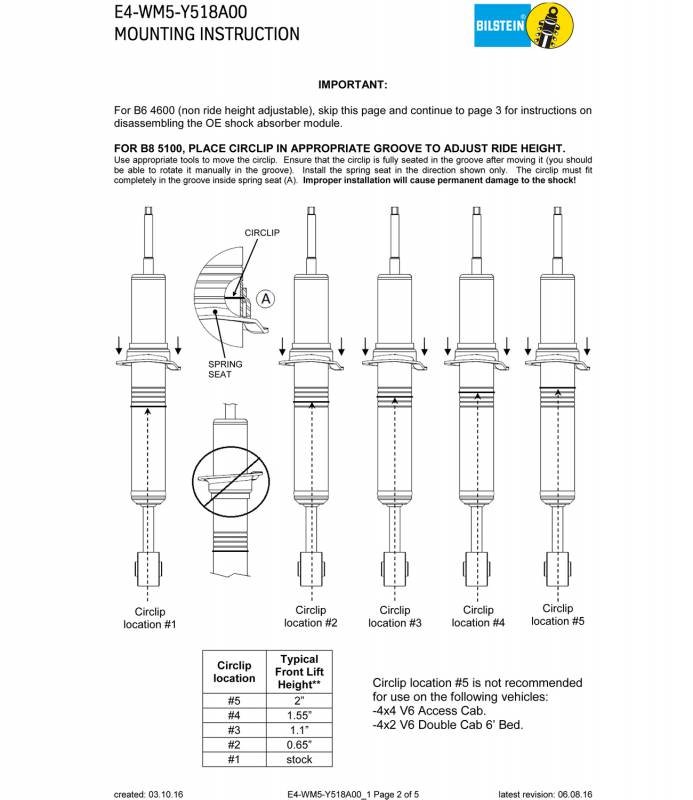

    how hard is it to turn the front up a notch? i might wanna go 2.5

    anybody know how involved it is to put these coilovers on the next notch....I know some systems come with a tool to crank them up or down .....but i dont know about these

    bottom

    You’ll have to take them apart and use a spring compressor to reassemble.

    thats what i was afraid of....most adjustable coilovers come with a spanner tool...or at the very least you can turn the adjustable coilover while it is installed on your vehicle...either by hand or a screwdriver or something.....
    .interesting....

    We’ve done it using a jack under the LCA while on the truck. It’s not recommended but we did it.

    my thoughts were going that way....its just a matter of compressing the spring and moving the snap ring to the next groove correct?

    It’s not that easy
