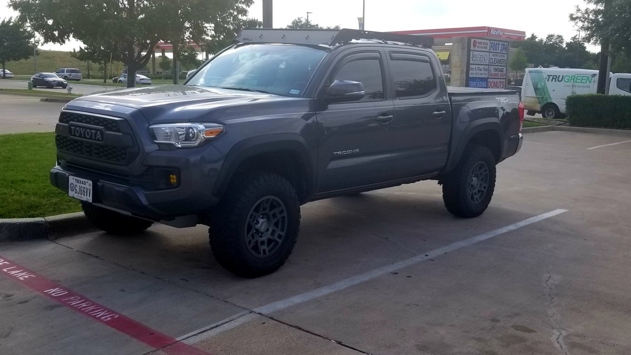

    Will I need a differential drop when installing the Eibach Pro Truck stage 1? If so any recommendations? I noticed in the Extreme Terrain install video they dont install one

    Avid lightbar, Eibach 2in lift, various TRD parts
    I needed it.. if I didn’t install the front sway rubbed

    I have about 500 miles on my install with the icon 3 aal, drop diff and drop carrier bearing and I have to say this kit is phenomenal. The lift was great visually and the ride is fantastic. To me its even better than stock. Based on the price, quality and performance you cant beat it.

    Is this at the highest perch setting?
    Looks great

    2018 Tacoma TRD OR
    Eibach Pro Truck Kit - Part#E80-82-069-01-22
    iCon 1.5” 3 aal - Part # 51100
    TACCB - Toytec Driveshaft Carrier Bearing Drop Kit (05 & UP Tacoma)
    RM83011 / TAC-DR-05 - Toytec Front Differential Drop Kit - 05+Tacoma
    Front set at middle perch
    Blueegg and Siblue like this.

    Sasquatch, did you add a shim when you installed the AAL? If so ..degree?

    It was inside my kit BTW. Also I added the carrier barring drop (which removed a ever so slight vibration from the back) I will do some shims when I add a full leave pack instead of the 2in aal I did.
