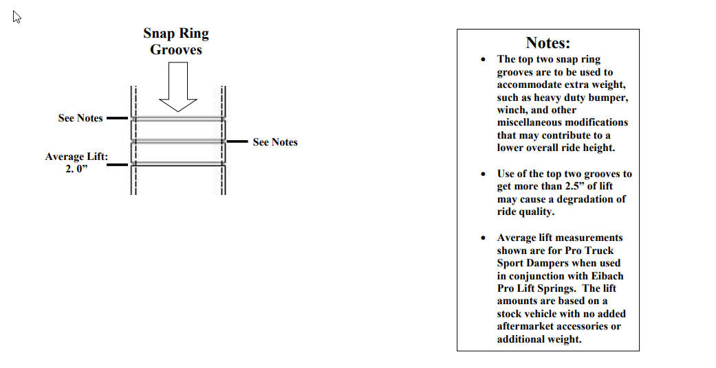

    I got this from the Head Strong site
    CBrob[QUOTED] and hwntaco20 like this.

    I had the kit on my other truck and talked with Eibach cple times. 1st notch(bottom), 2" gained from the springs alone, 2nd notch is for added weight, bumper winch, etc- if used with no extra weight just to gain a little extra height it will be harsh riding, 3rd notch is not recommended unless a lot of weight is added like bumper, winch, skids, etc, the ride will be too harsh. I had mine at the bottom, it was a firmer than stock but comfortable ride. Looking to add these shortly to my new 20 OR.

    The guy who said he got 4" had installed his spring perches upside down, and that was before he corrected the problem.

    I added the 1/4 spacer to my order. As of now Wheeler will be getting the pro lift in by mid October. I also called Eibach about 30 mins ago to ask about what perch to go with a 153lbs bumper. They recommended the 1st perch since my bumper is not that heavy and no winch. Also, about 25lbs were removed from the stock bumper and crash bar making the bumper come in at only 125 lbs. He explained that I need to take the weight and divide X2 so it's only about 62lbs per spring so no need to go to the second notch. I would get 2" from that lift. I am also adding the Wheeler single AAL to keep the factory rake.
