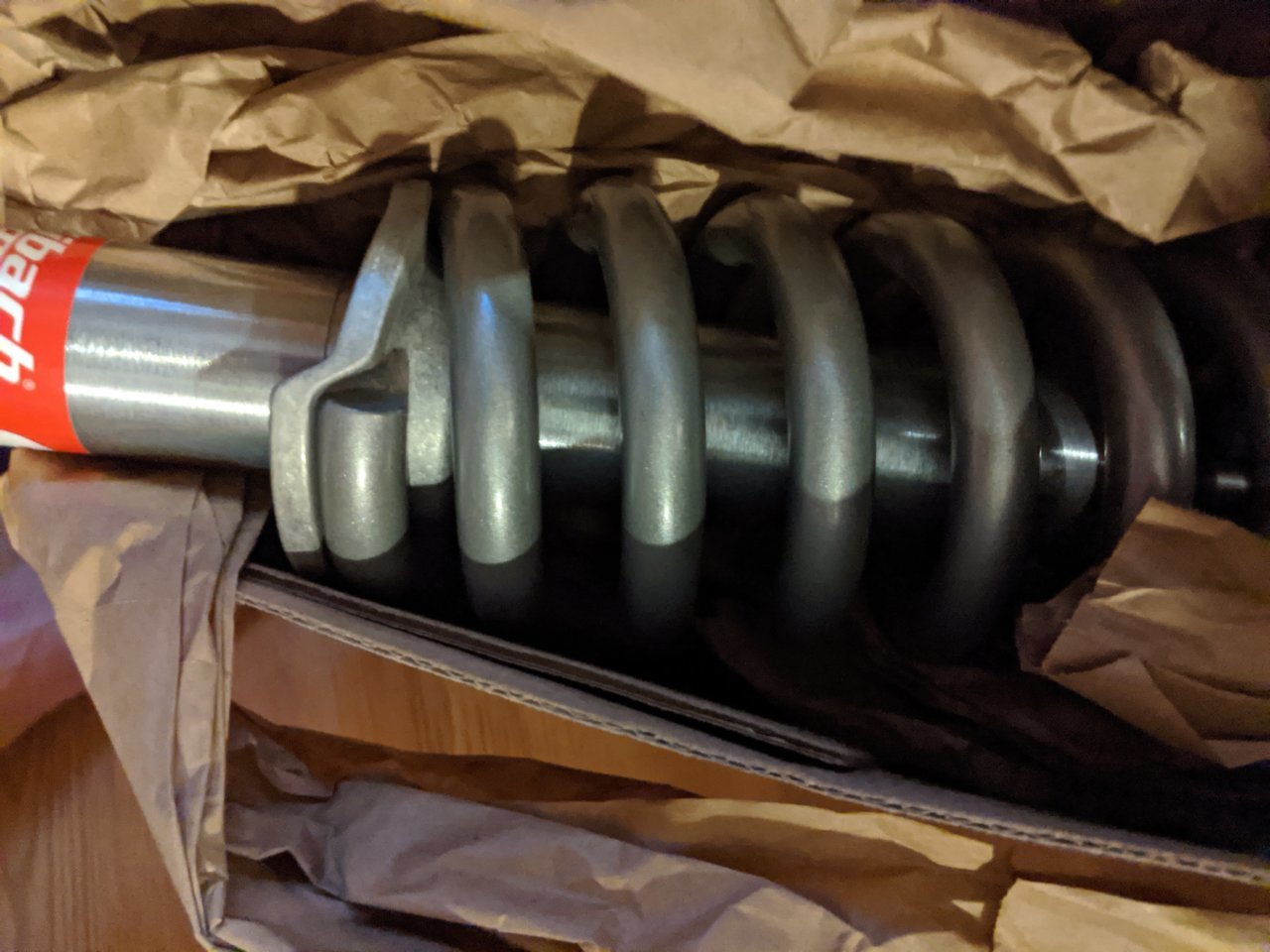

    But I will say none of the chipped powder coat flakes were in the packaging so it happened before it was boxed. So I don’t think the marked up springs are from the delivery service.

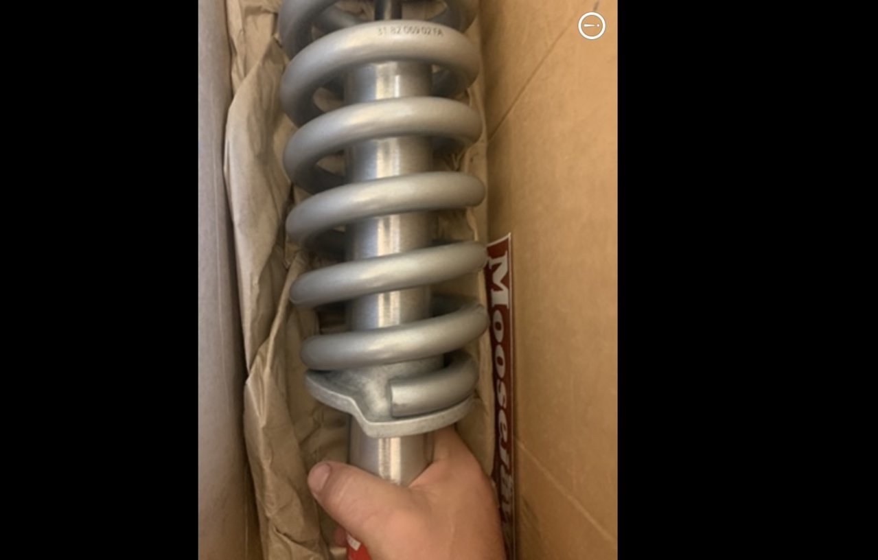

    I do wonder if this spring not resting on the stop will have any effect on noise. Should I try to get it to rest in the proper place or let it ride?

    in this case, 2 options, rent/ borrow a crappy spring compressor from Oreilly's or similar, the good news is you won't need to compress as much to get it to move over a bit. If not, install as is, then do the NO SPRING COMPRESSOR method using weight of the truck to adjust. I've done installs both ways.

    I'd let it ride...
    I bet it will settle into place pretty quick.
    But for comparison, mine were seated.

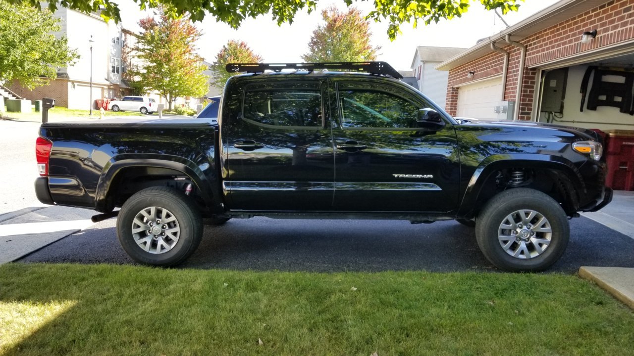

    Eibach installed. Bottom notch.
    1/4" HS spacer
    ICON AAL
    ECGS
    please excuse the baby shoes..
    alignment tmrw, rotating but keeping the 245's a couple weeks before wheels/tires and prob another alignment.
    Ride is stiffer for sure, but much more planted.
    Def like it better, feels like a truck should feel.
    Not like a caddy..
    Swapped at 36.7k, original tires are slappy, too, plus alignment off..
    a big THANK YOU to @skatefreak282 and @Arcticelf for workin on their Sunday and gettin me close enough to float home.
    Will check in after tires and final alignment, but got 2.25" front, and about 2" rear, for now..but less than 100 miles, so..
    (before/after)
    after pic is on a pretty good incline, overal she still sags a bit on front left..
