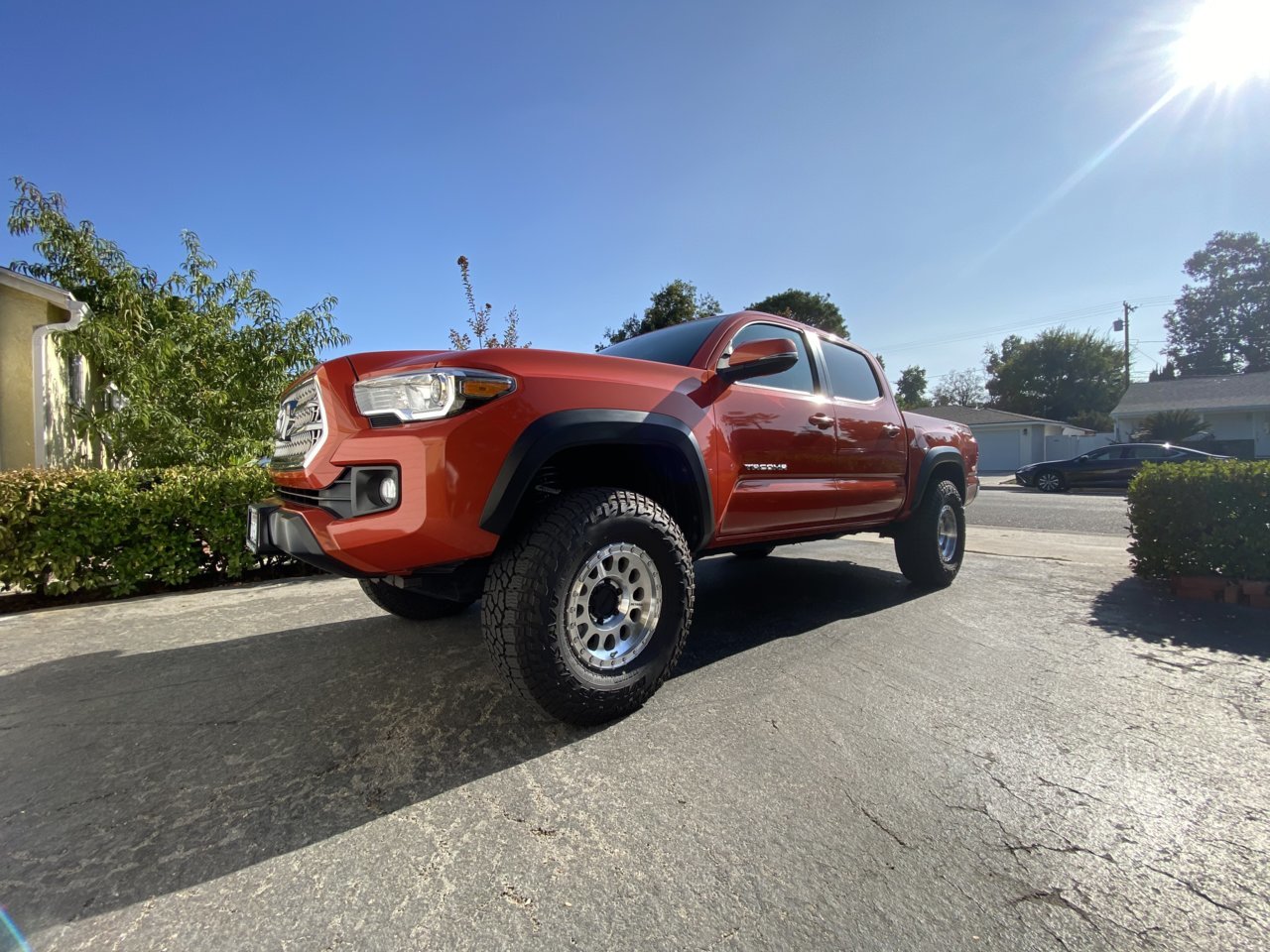

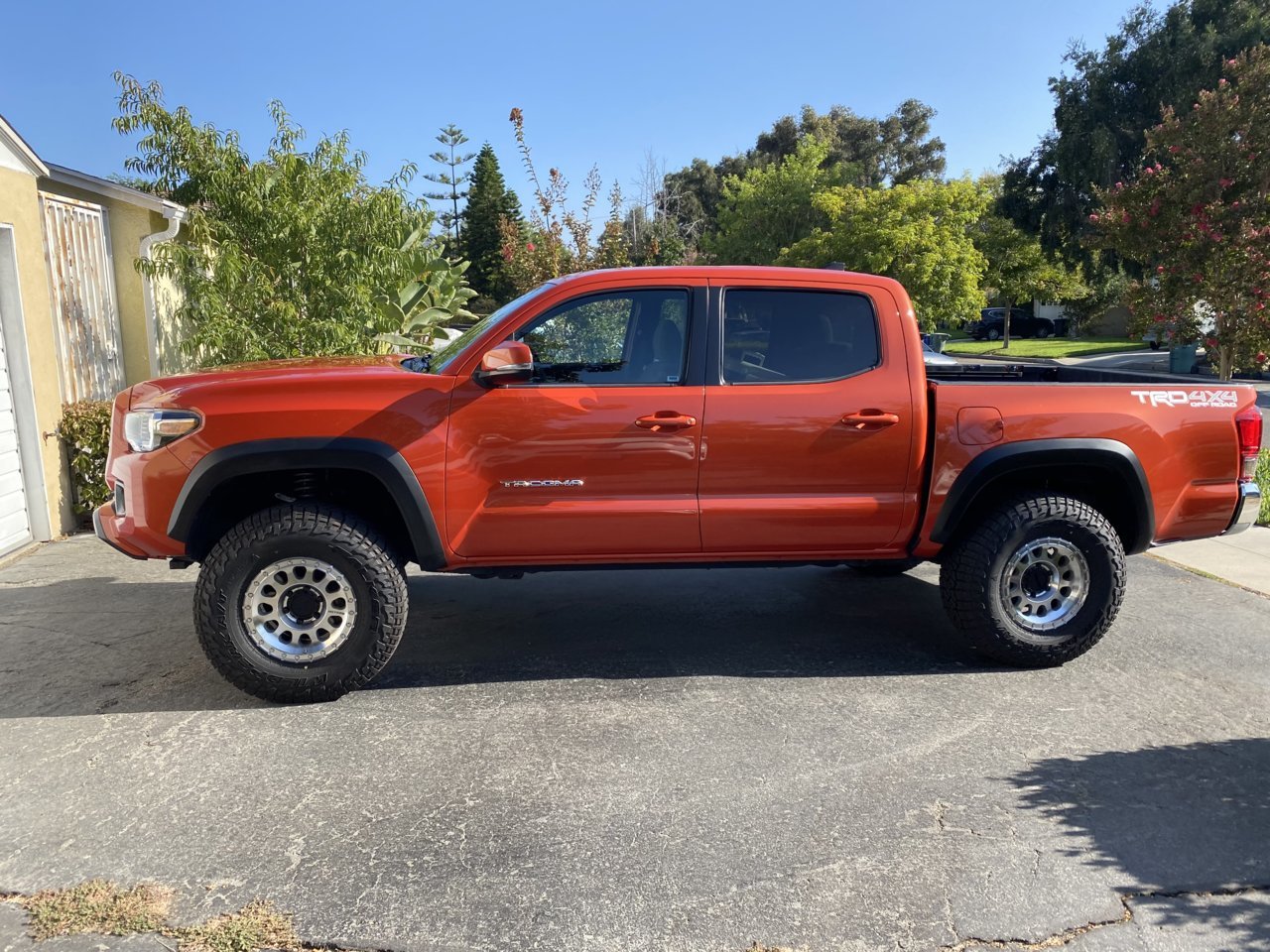

    Eibach pro truck lift with 285/75r16 0 offset with no rubbing at all
    Gs4x46mt, hwntaco20, kas2828 and 3 others like this.

    what notch setting, bottom or 2nd? Finally non black wheels, what are they? Looks great!

    Thanks! 2nd notch and the wheels are the method 315’s. The silver goes great with the chrome accents. Everyone goes with the stealth look nowadays, had to switch it up a bit.

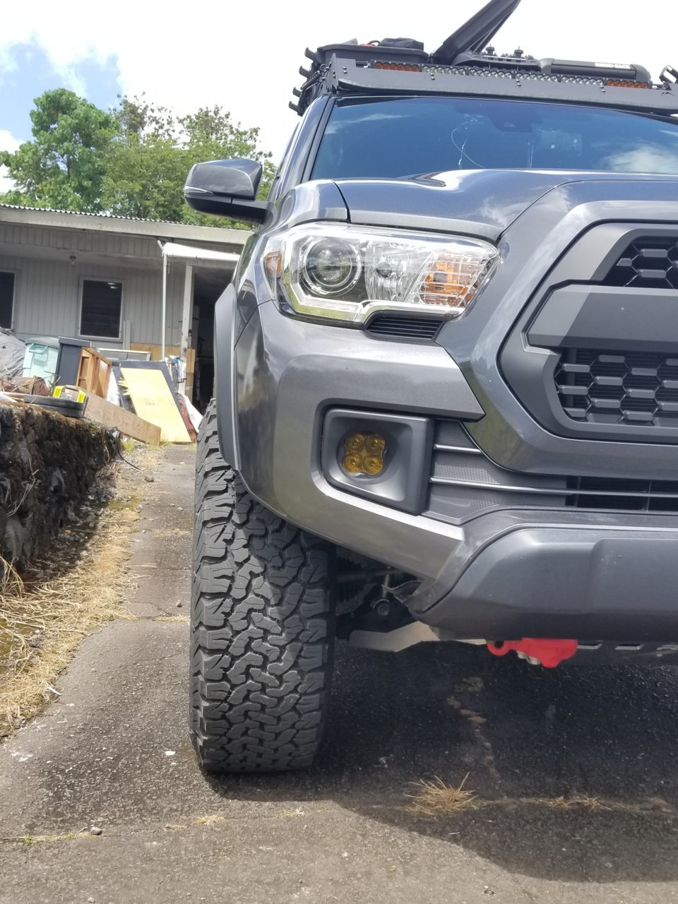

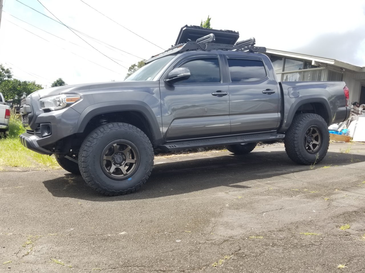

    17×8.5 with -12 offset on 285/75r17 KO2s. Set at the bottom notch.
    CMC, hammered pinch weld, and trimming of the back fender liner where the pinch weld used to be. Viper cut on the lower front bumper helps with clearing rubbing up front. I still have a little rubbing on the bottom of the drivers side fender flares when I'm going in reverse. I have JBAs coming in which will eliminate all of the rubbing.
