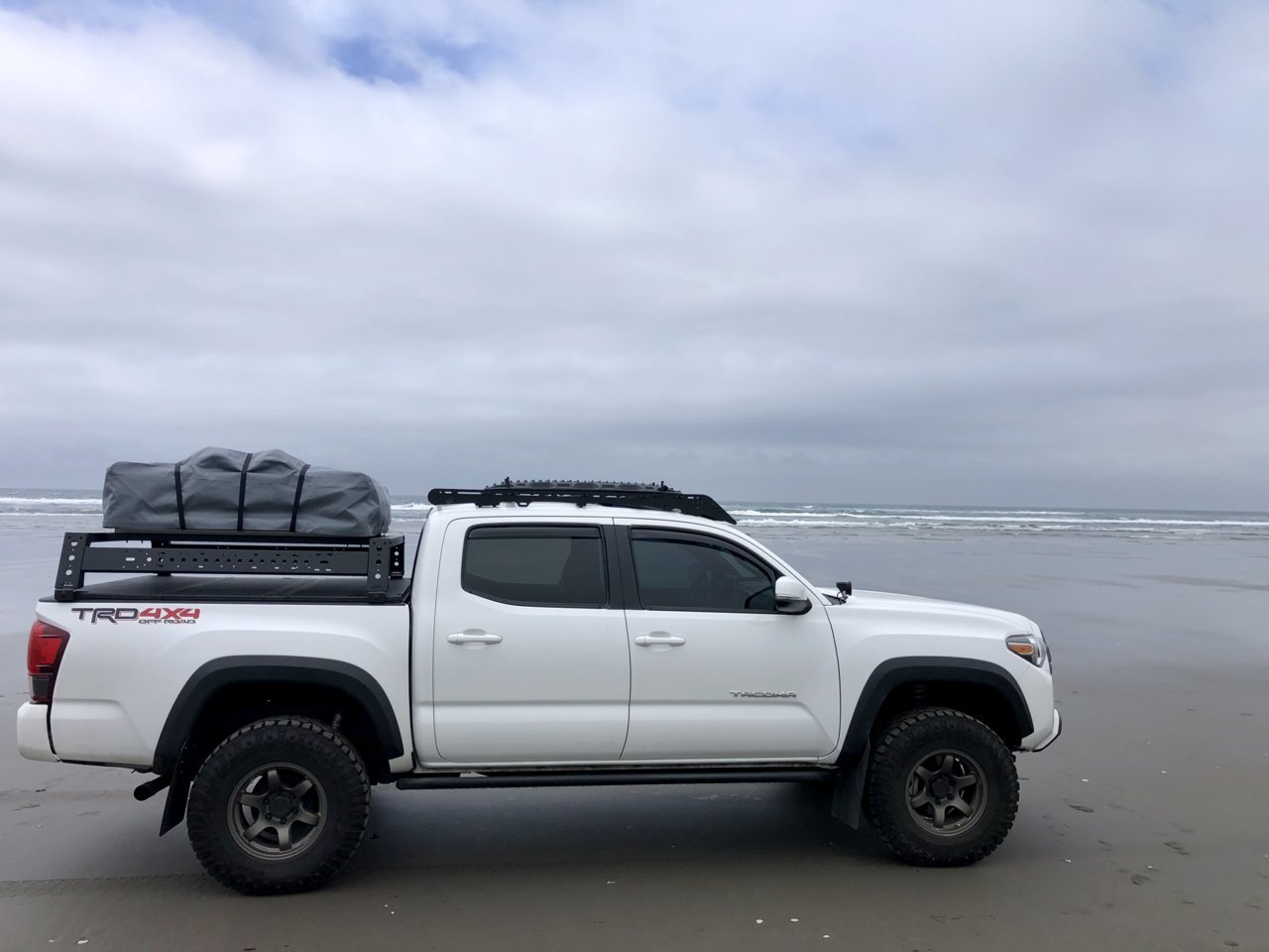

    Front is set on the 2nd notch for the additional weight up front (streamline bumper @ 65lbs, winch @ 65lbs, skid trio @ 135lb), and 3 leaf AAL in the rear w/the overload left in place.
    Still sitting at 2" lift all around. Rides very smooth even with all the weight.

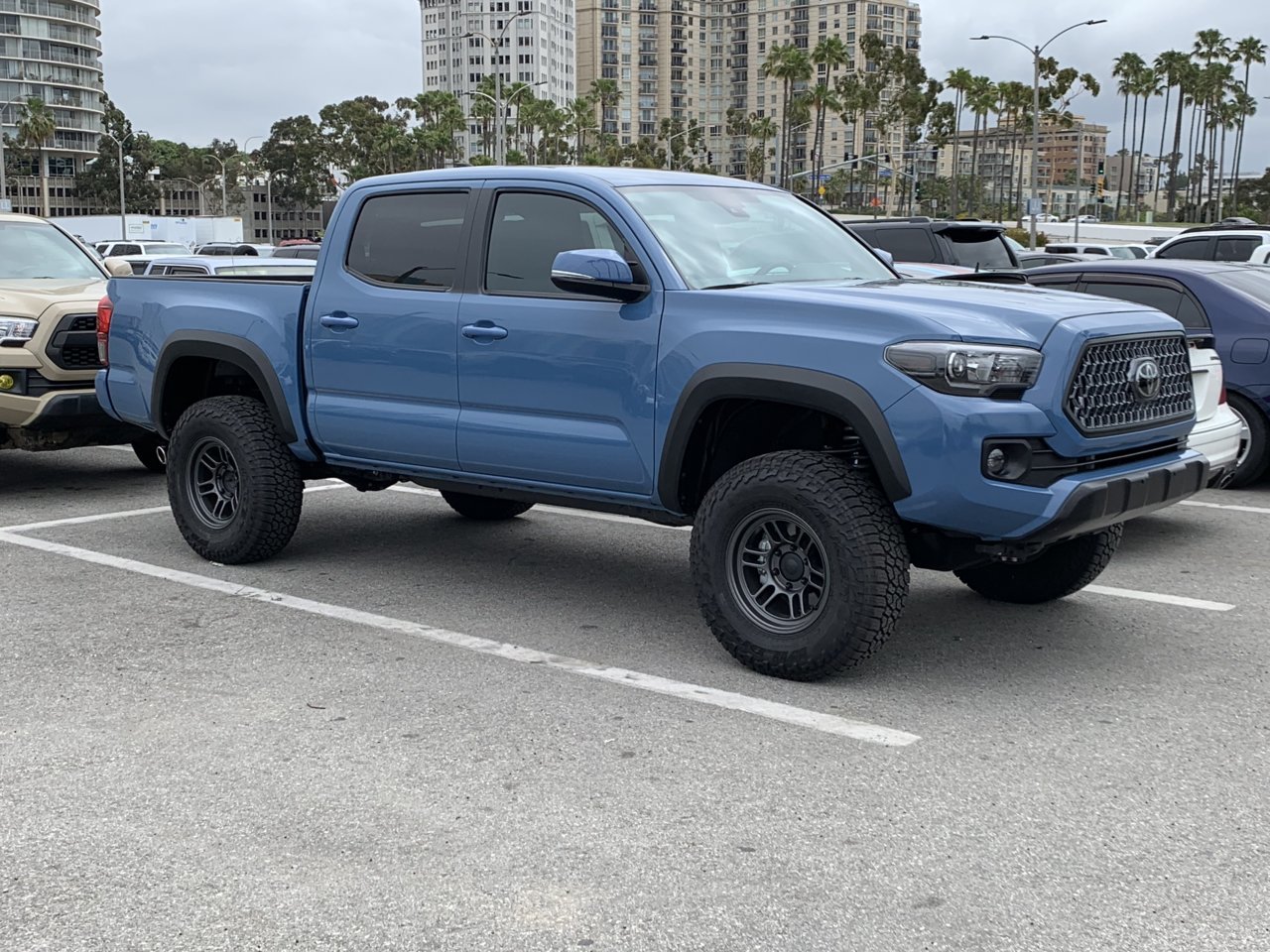

  9. Jun 3, 2019 at 2:05 PM

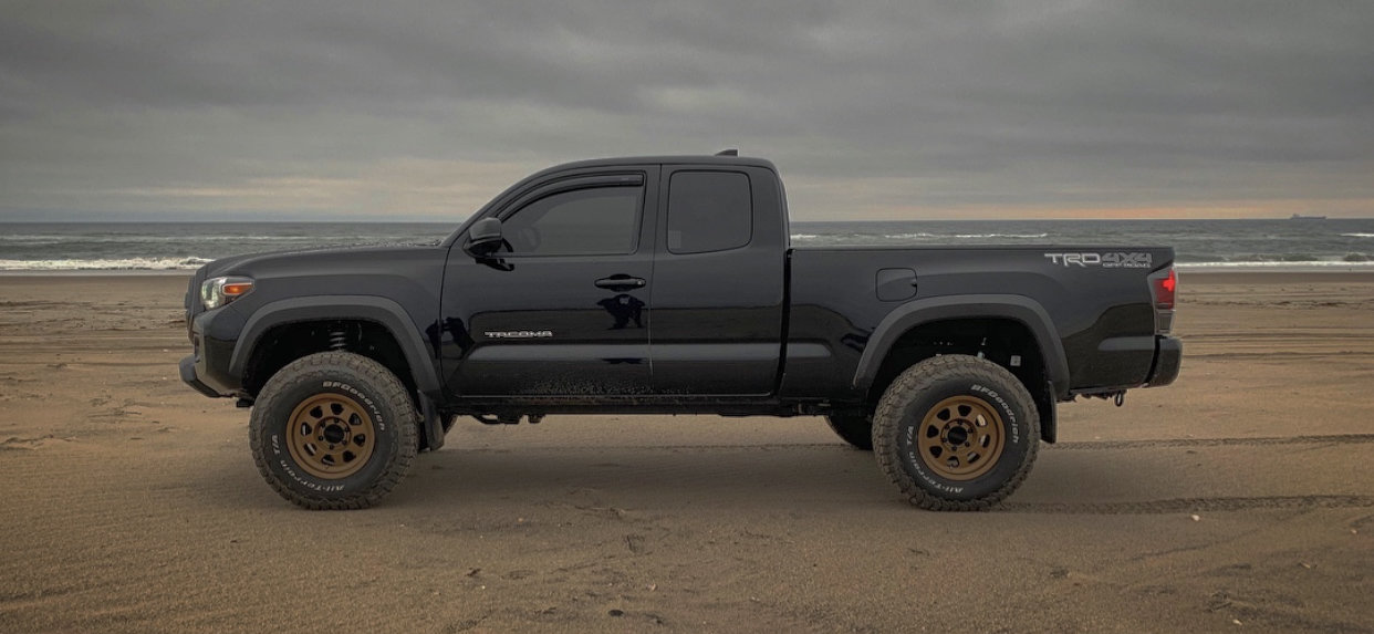

    After about 5,000 miles with this kit paired with Icon 1.5” 3AAL, I’m completely happy with the kit. The ride is great and softened up over time, handles the same if not better than stock on the road and through turns. I don’t do any serious off roading so I can’t comment on that, but it handles great on the beach and dirt roads. I’ve inspected the shocks and have no signs of any damage (leaking, contact scratches, bends). I’ll likely go up to the top notch, get some UCA’s and either go with a new leaf pack or a 1” block to fit in some 35s eventually. For the price of this kit compared to others, I’m not sure why it’s not more of a popular option.
    I honestly don’t take too many pictures of my truck and have likely posted this picture in here before but f it.

  12. Jun 7, 2019 at 7:47 AM
