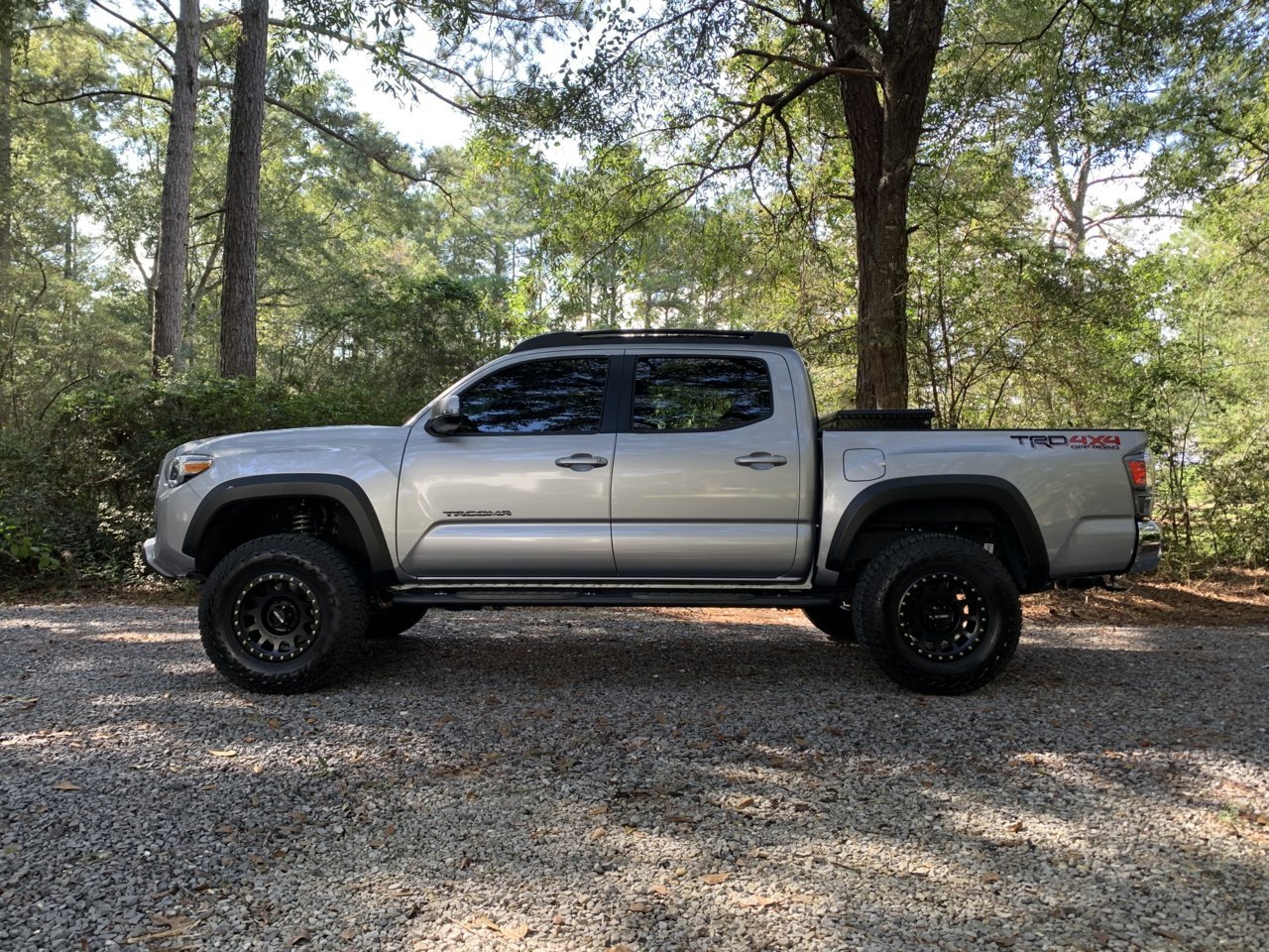

    265/75/R16 AT3w, Clazzio Black leather, Bed Lights, 15% tint, Roof Rack, TRD Grill Amber leds, interior leds, spidertrax 1.25 spacers,
    265/75/16 Falkens on Nv 305, 1.25 spacer. Eibach on second clip and icon 1.5 aal. No uppers or any of the other stuff. I may try to put the overload back in, because the front is about 1/4 higher at the moment

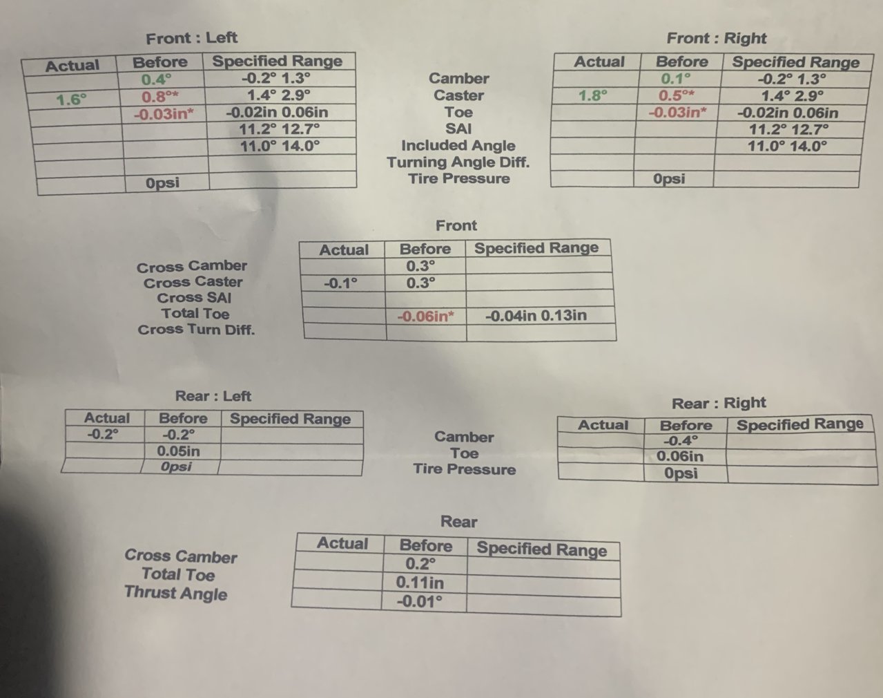

    I'm on basically the same setup (second clip) with no uppers. What are your alignment numbers?
    I have 1.8 degrees of caster, which makes the truck a little squirrely on the highway. Not a huge deal, but so many people on TW swear you need new UCAs to get higher caster. Maybe a year down the road I'll upgrade, but don't think they are absolutely necessary (also $500+ is sizeable).

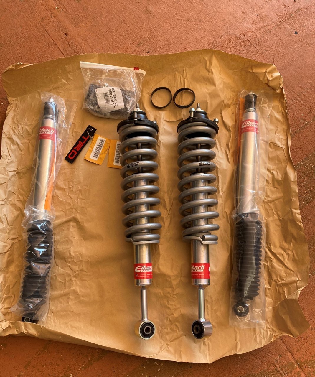

    Just got my kit. Now I need to wait for the JBA and AAL to get here next week so I can start working on it.:muscleflexing:
