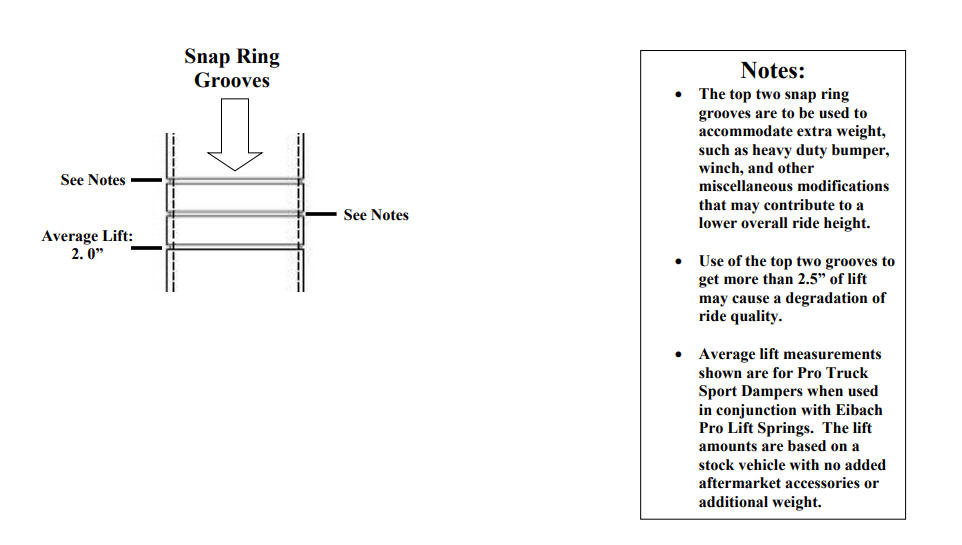

    I just moved up to middle notch to account for added weight of bumper and winch and it sits really nice. I added UCA’s and now have a ton of caster. Changed out wheels and tires to 4Runner TRD Pro with +4 offset and 33 inch skinnies (255/80R17) and so far no rub. Second notch does not fill any stiffer really than the bottom notch.

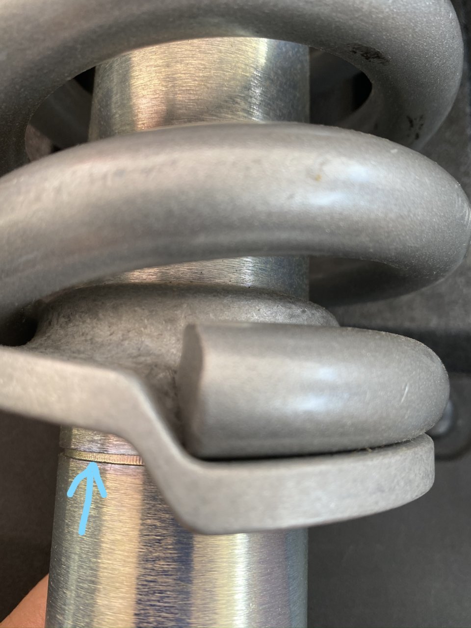

    I asked the shop to put the coils on the 2nd perch when I ordered them but when looking at them they look to be on the 3rd perch. The reason I say this is because I would think that I should see the 3rd perch if it was on the second perch correct? I don't want to install these and find that I need to take them off to adjust them.
  16. Oct 1, 2020 at 10:56 AM
    #3816
    alegerlotz
    alegerlotz Well-Known Member
    Apr 25, 2017
    #217263
    195
    Los Angeles
    2017 Tacoma Limited 4x4
    aren't the perches counted from bottom to top? You have 1 perch showing. Looks like its on the 2nd perch to me... Can you get a pick from an angle that's more from underneath?

    I'll post a better pick later on. The bottom perch gives 2" so my thinking is that if it is on the second perch I should see a bit of the bottom perch and a bit of the top perch. Right now I can't see the top perch which is why I believe that it was set to the 3rd perch.

    Not necessarily, my lift is on the bottom or first perch and I can see only one groove above my coil seat. I believe the coil seat is so thick it kinda covers up the next groove above what you have it set to. So if on bottom you'll see one groove (top most) above it, if in middle you might see none, and if on top you MIGHT see the lowest one. Just my observations, no data to show this minus just looking at my own setup and knowing what perch I have it set to. Hopefully this eases any stress though.

    Thanks, If you can see only the top perch then it makes sense that mine being on the 2nd perch I only see the 1st perch. I'll find out for sure if I get more than 2" when I install them.

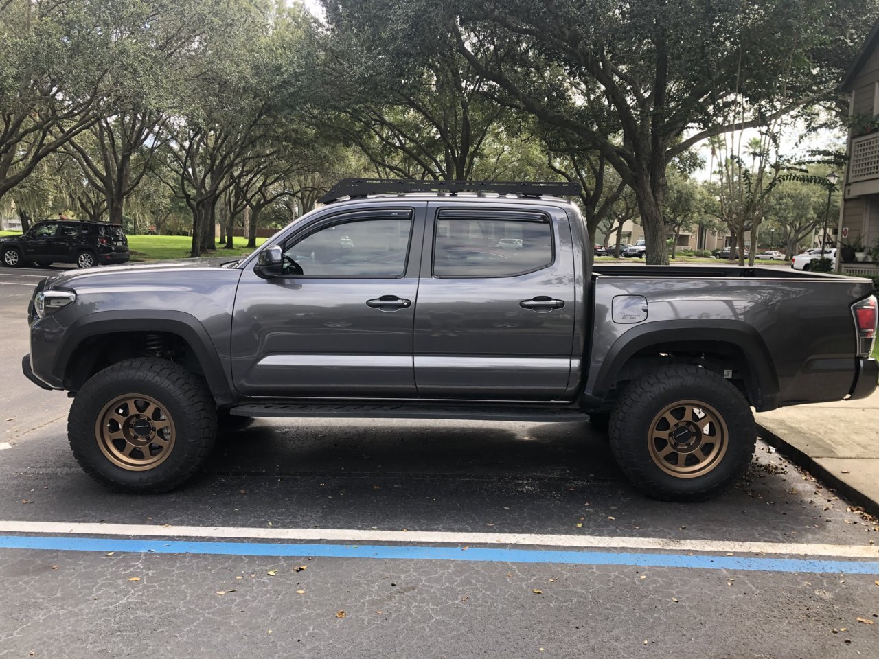

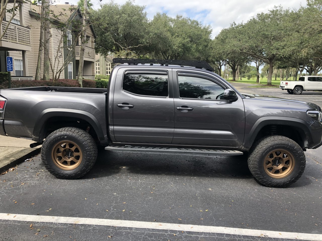

    Hello all! I just got this kit installed a couple of days ago after reading the first 188 pages of this thread.
    I ended up going with the Eibach Pro Lift Kit with a 1" block for rear (and a 1/4" lean spacer for front driver side). Pretty happy with results(ride/appearance) after a few alignment tries.I ended up with a 1/2" rake both sides and perfectly level in transverse direction with the help of a 1/4" spacer(that came with kit from Headstrong Offroad). The transverse rear height variation is negligible(only 1/4").I figured I'd post a couple of before and after pics. ✌️ 20200930_135717.jpg 20200930_135710.jpg 20200731_155152.jpg 20200328_154156.jpg 20200929_144442.jpg
