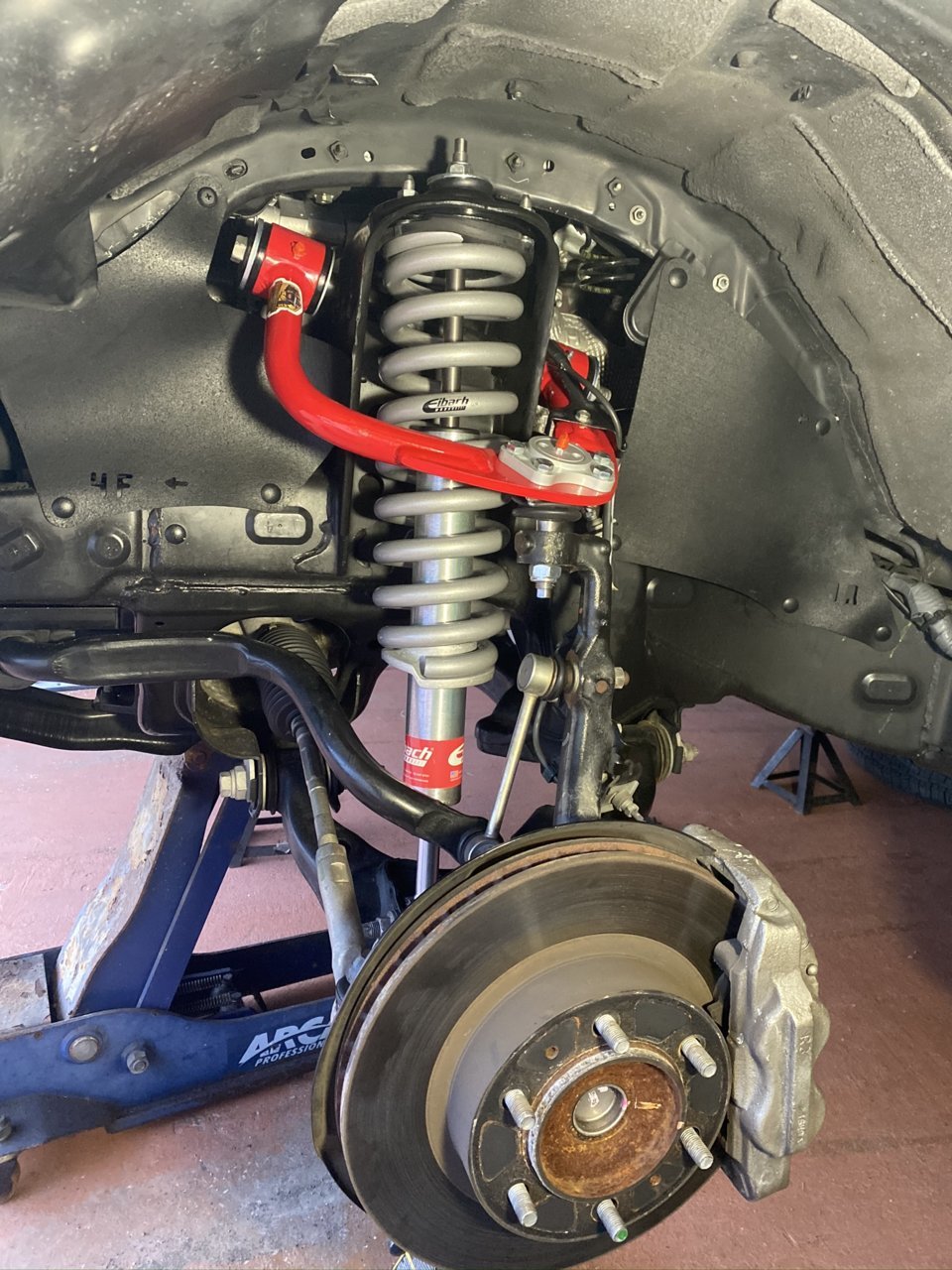

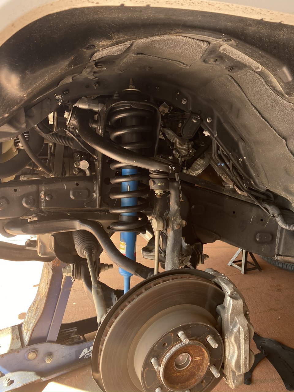

    Here is the before and after and it looks right to me. Even a side by side pic. It looked like it was on the second perch as I asked and they came pre-assembled. I might just take the truck to my shop and have them look at them to see if there is anything wrong. Then maybe take them out and have them put them on the first perch. The truck measured 34" 1/4 before the bumper then I lost 1/4" after the bumper install so I was shooting for 2" 1/4 according to the instruction on the Eibach site. The bumper only weighs 153 lbs.
    I have no idea what happened here. I have a TRD Sport so it's not a 4X4 just 2WD. If I messed up it might be on one side but both sides measure 38" even.

    I know this wont help with extra height but just curious, on the pic with the JBA UCA's & eibach installed, it looks like you are at full droop, is the UCA contacting the spring? Can't tell from that angle.

    There is plenty of room there now with the JBA UCA. I drove it and nothing out of the ordinary. Thanks

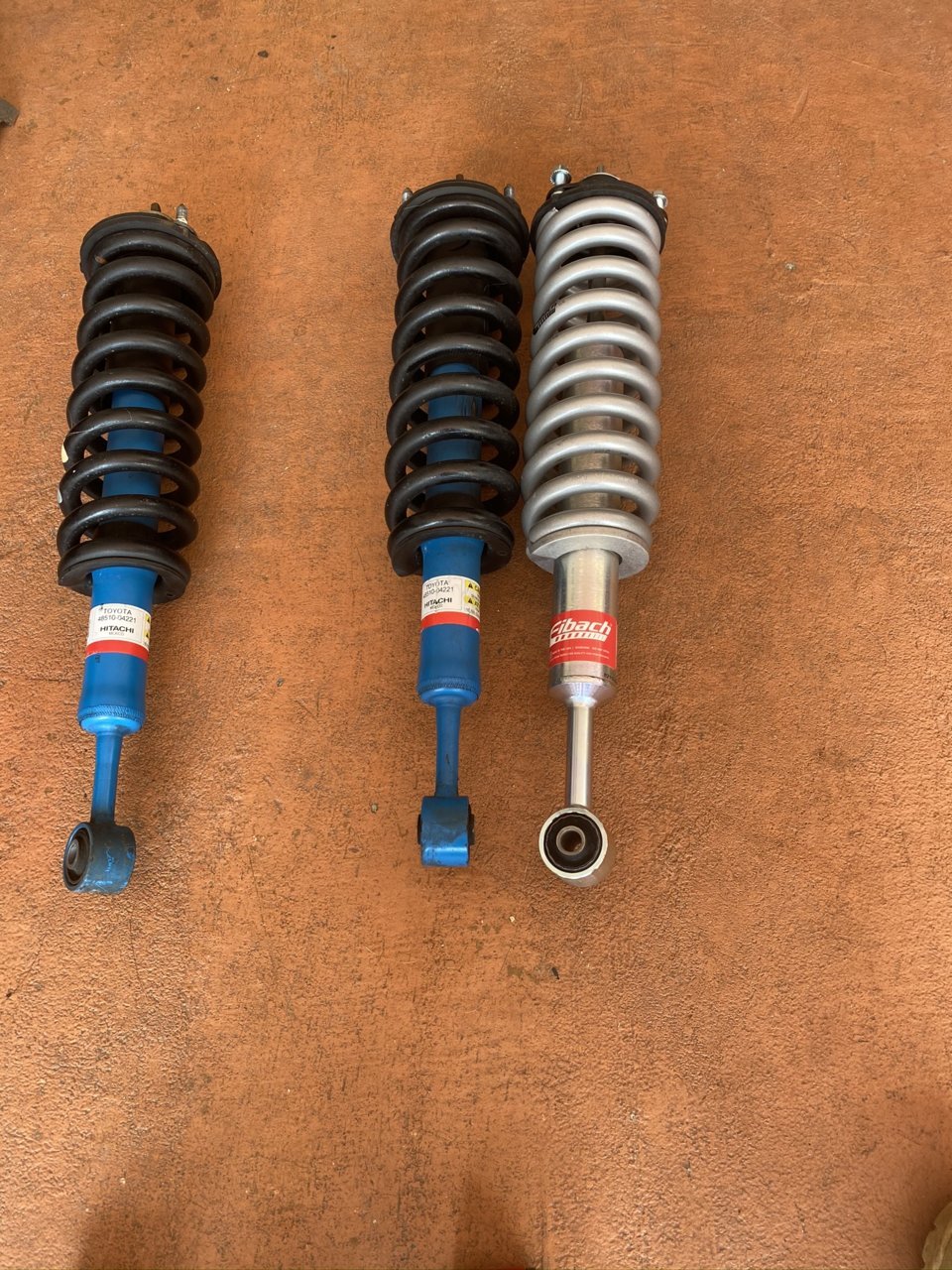

    I'm calling Eibach tomorrow to see if this is normal for a 2WD and also have the shop drop them to the 1st perch to see what I get. If you see the first photo you can see that they look like they are on the first perch. The other 2 photos are the stock strut and both Eibach which looks normal to me.
