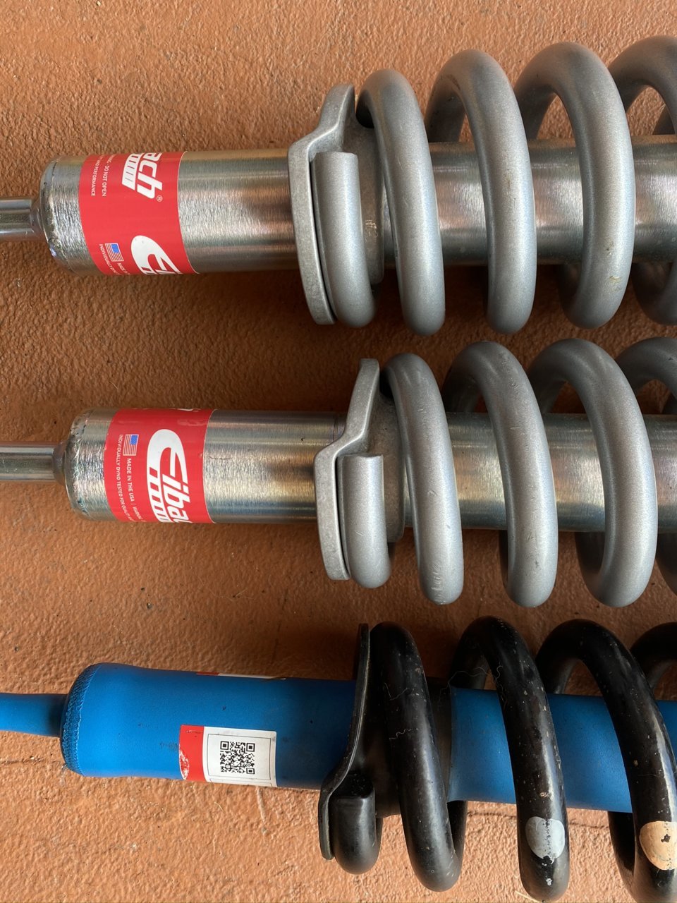

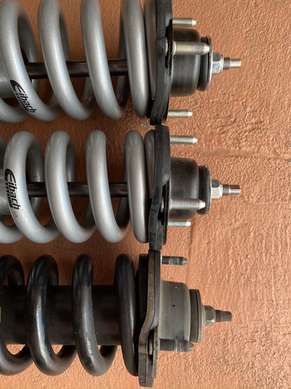

    Rainy day wrenching.
    Eibachs going in.
    So far so good

    It's surprisingly easy.
    I haven't wrenched in years.
    I watched plenty of how to videos.

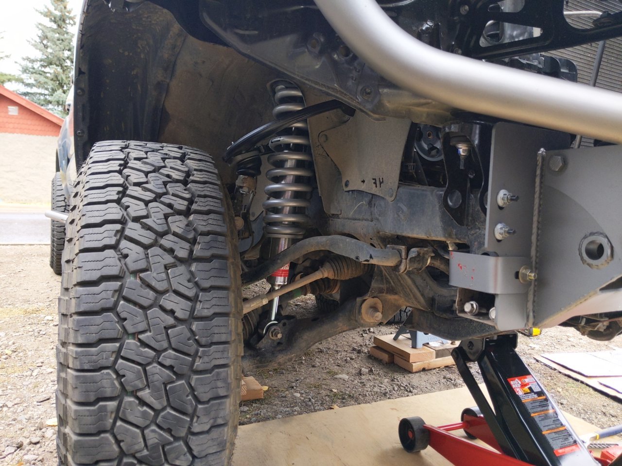

    Got the front done. Pretty smooth install even for a noob.

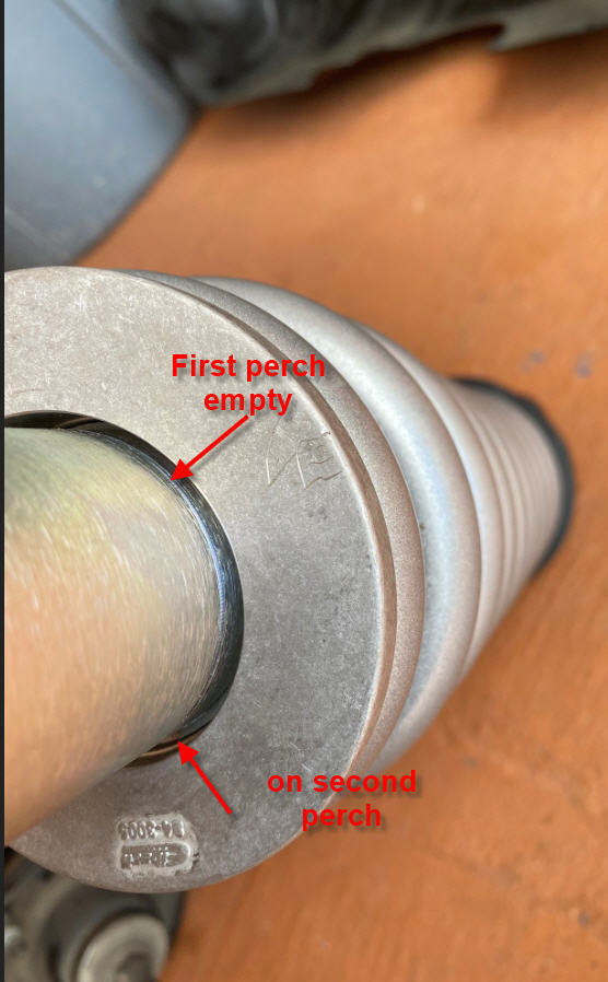

    What notch is that? Anything on the back?

    That is middle notch. Have icon springs waiting to go on the back, so it's stock right now

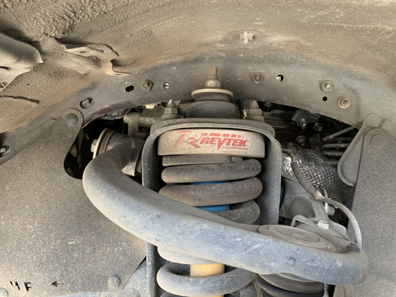

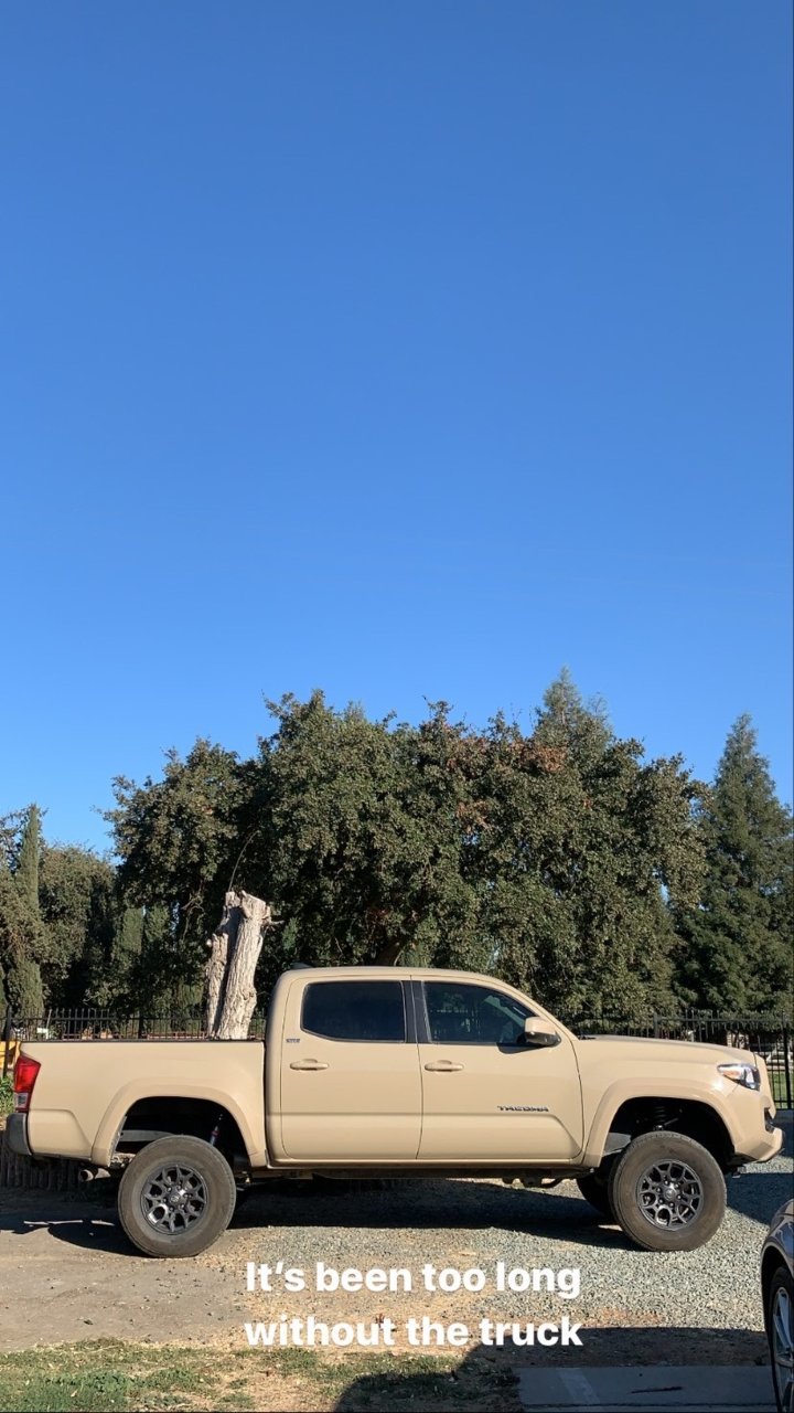

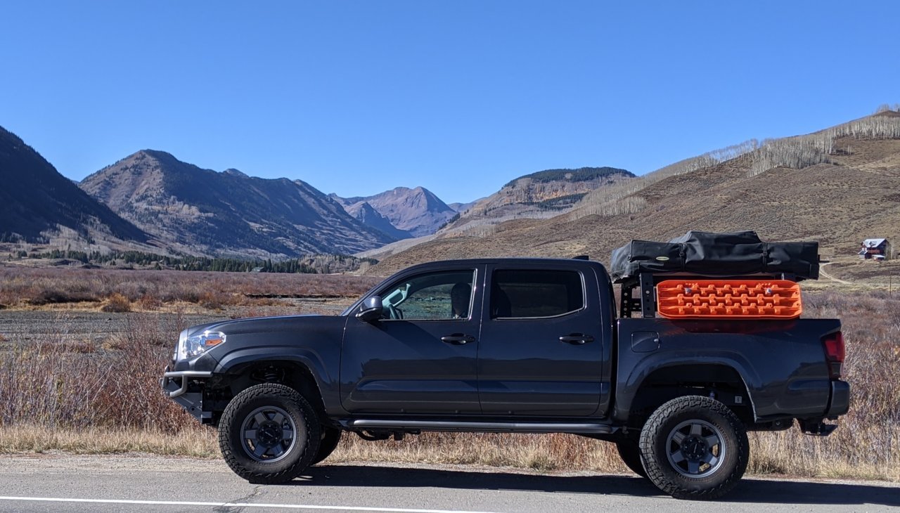

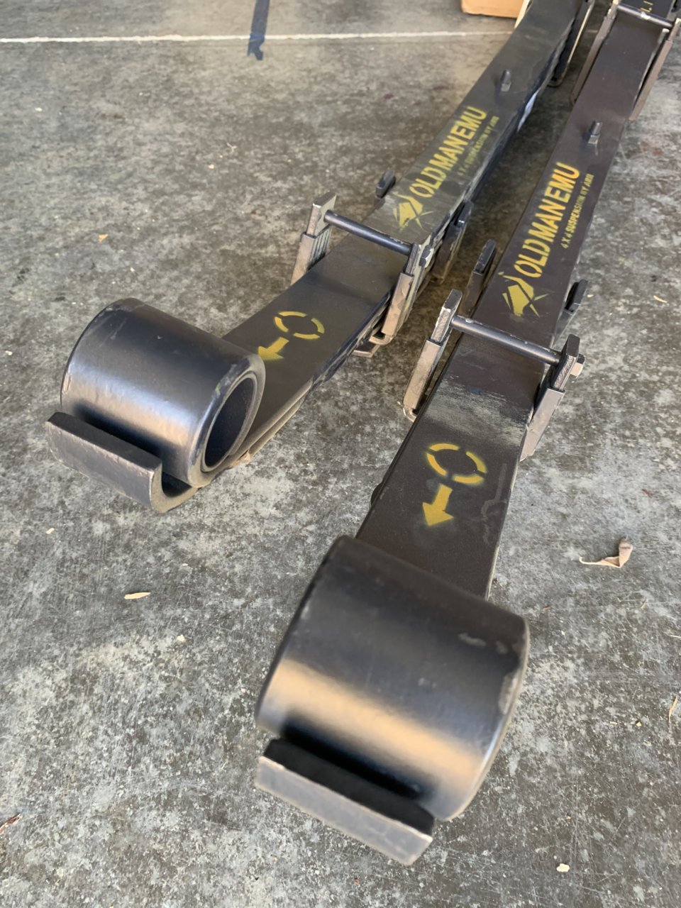

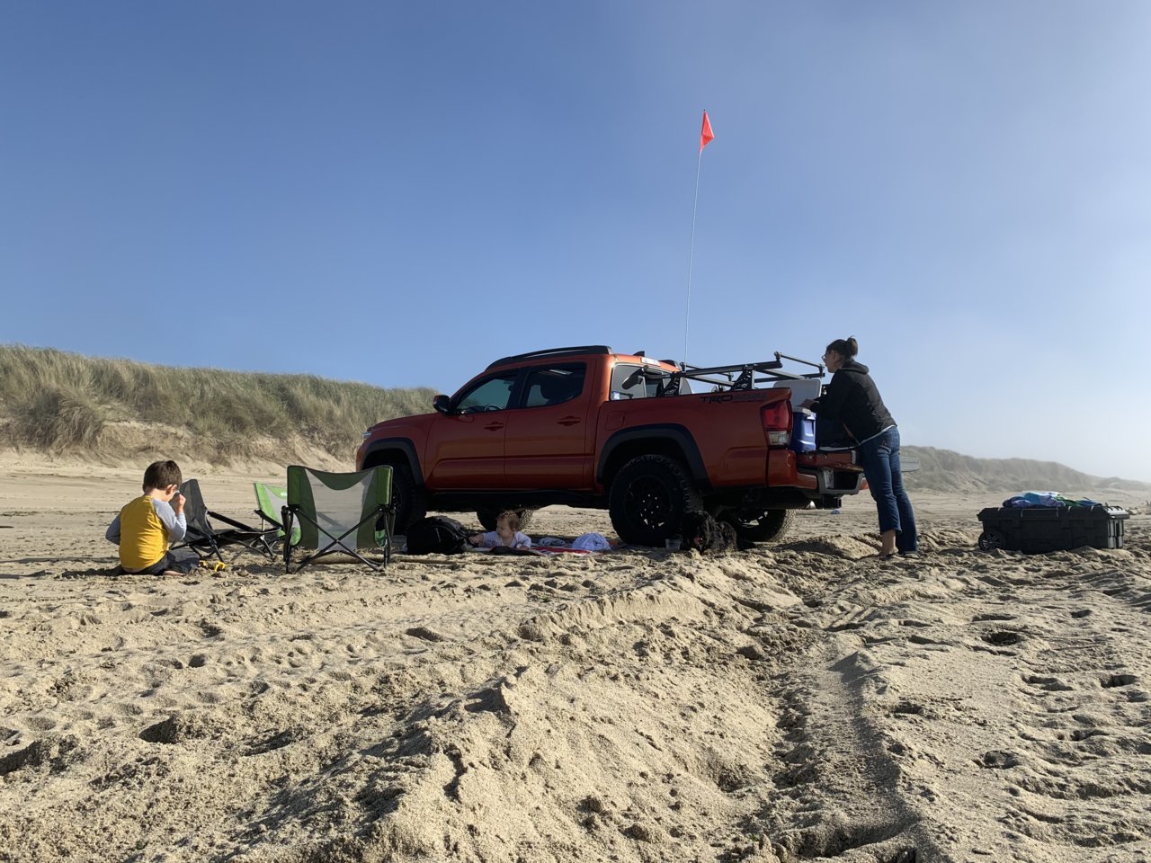

    C156EE59-D226-4D8E-B03F-9F9B2788339B.jpg E7B6ECA3-197D-4936-92E5-28E3E8D204C4.jpg 95F0A9E3-DE25-443A-BA74-E30450F16486.jpg Hello Eibach crew! I purchased the stage 1 kit from headstrong and hope to be installing it in the next couple weeks. I know there are a lot of questions in this thread about how much lift people are getting on which settings, so I will post before and after measurements and give you a rundown of my kit so you know how much weight I’m working with and what results I got. When I bought my 2016 OR short bed used from a dealer a year and a half ago, it already had a leveling kit on it in the form of revtec spacers. I’ve been happy with my set up except that I’ve developed a saggy rear over time. I’ve been on scales three times over the last several months and have been over GVWR each time. The last time I had only recovery gear, camp chairs, and a small cooler in the bed, so it was time to upgrade. Weight comes from the following:
    Victory blitz bumper—65#
    Ironman 9500#winch w/synthetic line—60#
    RCI sliders~100#
    CBI bed bars~50#
    Voodoo bed rails.~30#
    About 50# recovery gear
    2 car seats with kiddos—150#
    & copilot in back seat (until little one can hold her own bottle)—unknown#!
    It adds up quick!
    I decided not to mess around and purchased ome Dakar medium pack also (which made it here first!).
    Thanks, everyone, for the awesome thread! Really helped me in deciding what was right for us.

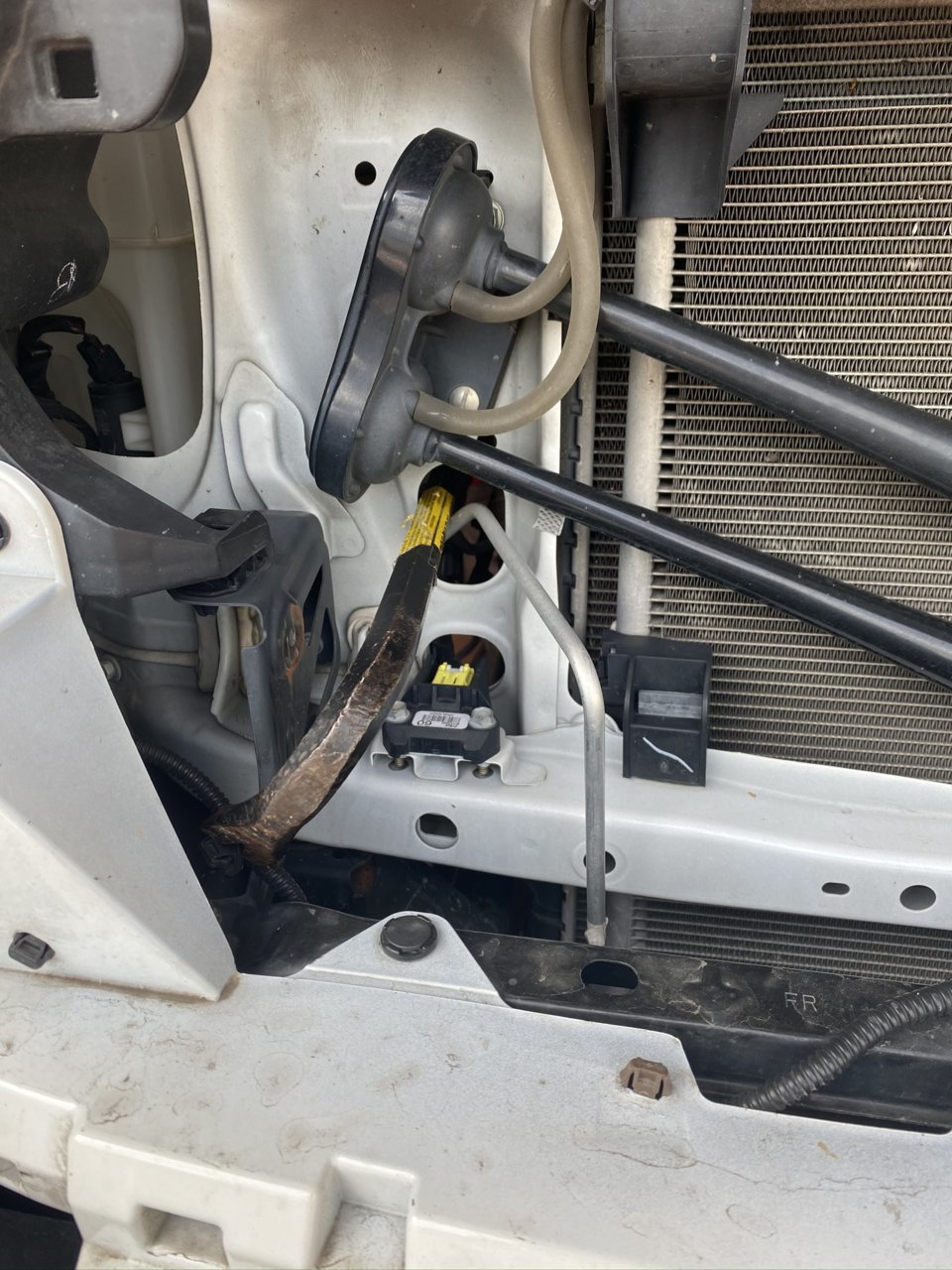

    If you are installing the JBA UCA as well I found that if you use the strut bottom 19mm bolt it can help you in aligning the fat and skinny washer. Also, I found it helpful to remove the front grill and you can use a long screwdriver or pry bar to help you push the long bolt through on both sides.

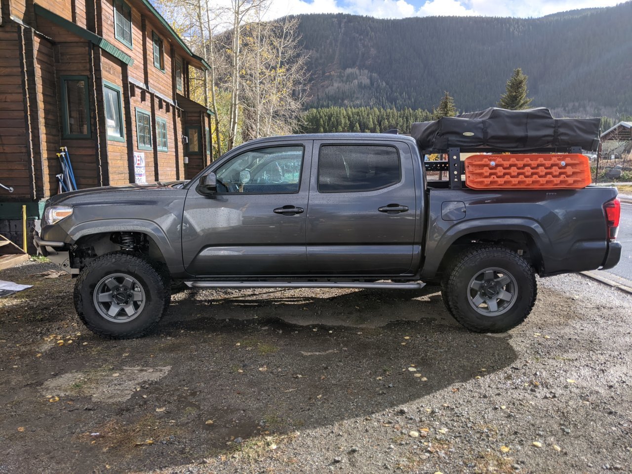

    Eibachs in the front icons rxt leaves in the back.
    Set the SPC at option D and the truck tracks really well and the steering feels a tad stiff.PXL_20201012_210705210~2.jpg

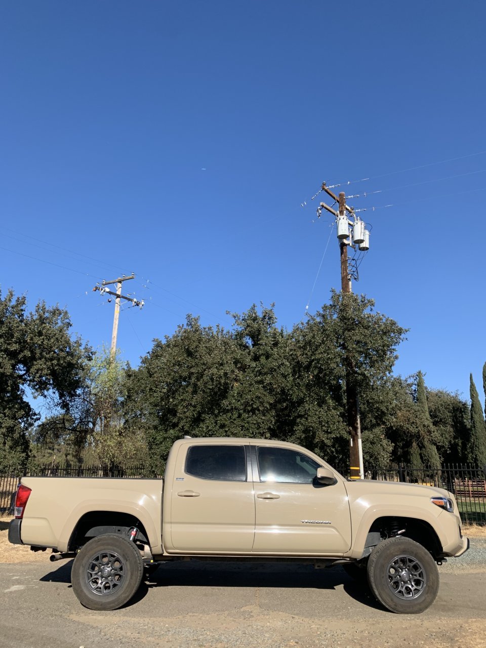

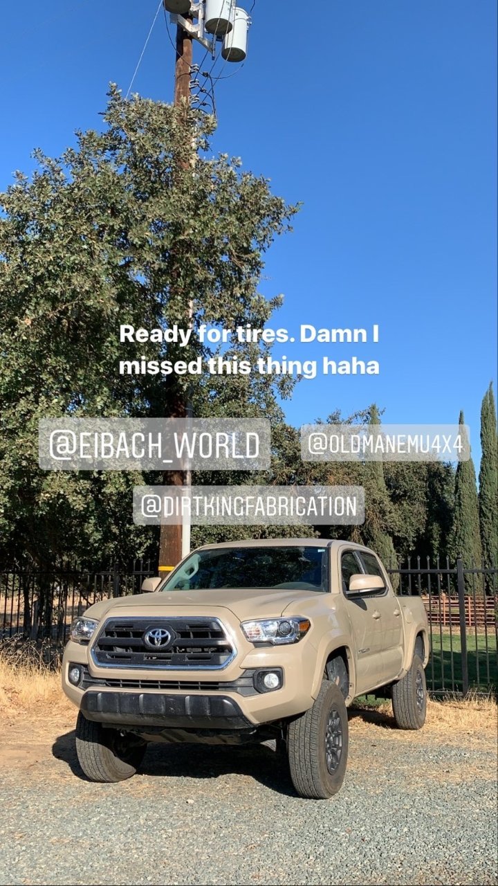

    Good evening everyone! I said I would post my truck after the lift is installed. It took a little longer than planned, but here she is. Sitting on the top notch. Dirt King UCA’s, OME light duty leafs. I had a feeling this leaf pack would give me a little rake and I was right. Not sure how I feel about the slight rake but one things for sure, I don’t hate it. Actually quite happy with how it turned out. Any pros/cons of slight rake with a lift? Also, ignore the Instagram tags :cool:2D3A7172-7907-4FFC-A917-716B1B221637.jpg

    So. Many. Stickers.
    Slight rake is good. Bro lean is for Chevy's :cool:
    Also not sure if I've ever seen an SR5 in Tali... erm, Quicksand.
