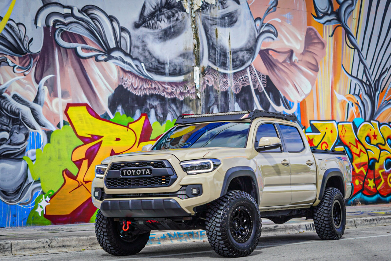

    2 notch and 33s .

    Looking good love the cut on the bumper :thumbsup:

    So. Many. Stickers.

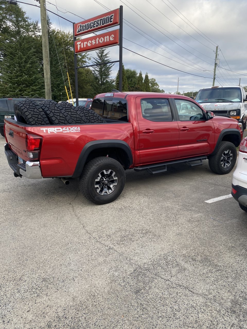

    Finished the lift yesterday! ECGS, 2" aal, Eibach 2nd setting JBA UCA's. It took the longest for the ECGS! Waiting on getting the 33's and new wheels put on.

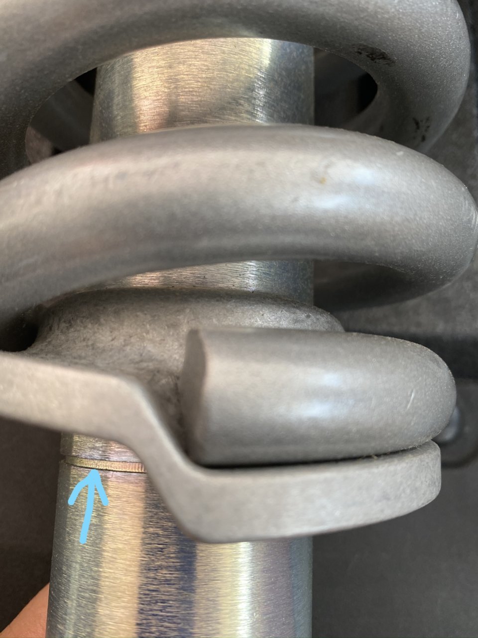

    Dumb question but you're mentioning the lift seems way too high for what you were thinking it would be, is the spring saddle installed correctly? One person on here before mentioned similar and came to find out the spring saddle was installed upside down before being sent to him. Just something to look at to be sure it's not the case. Hope it all settles you for and you get to the lift you were hoping for!

    Not a dumb question at all. In fact, that is what the tech at Eibach asked as well and after sending him this pic he said it was ok. This pick is when it was on the second perch.
