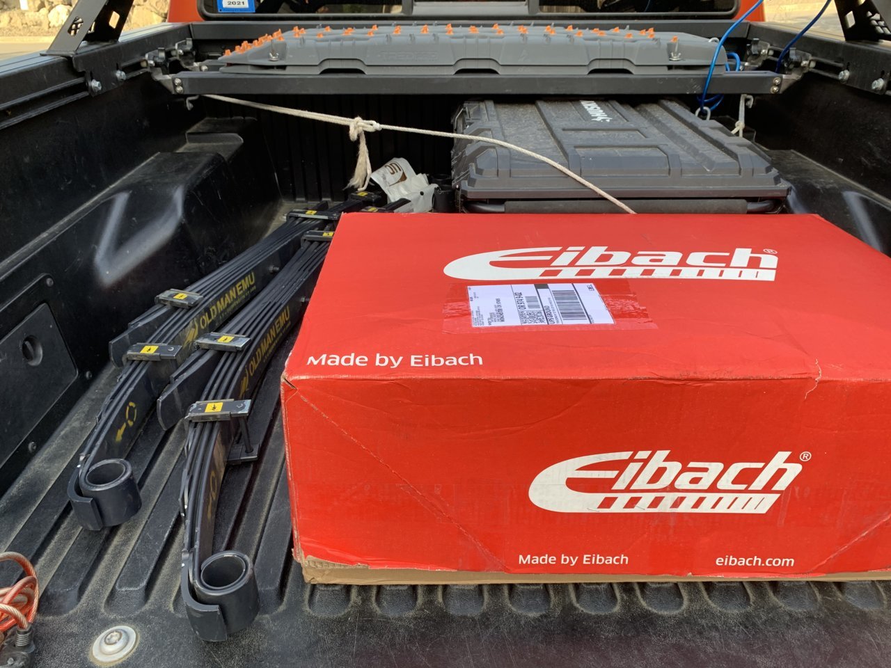

    Install day!!

    Make sure you put the leaf springs with the little clips nuts out. Away from gas tank.

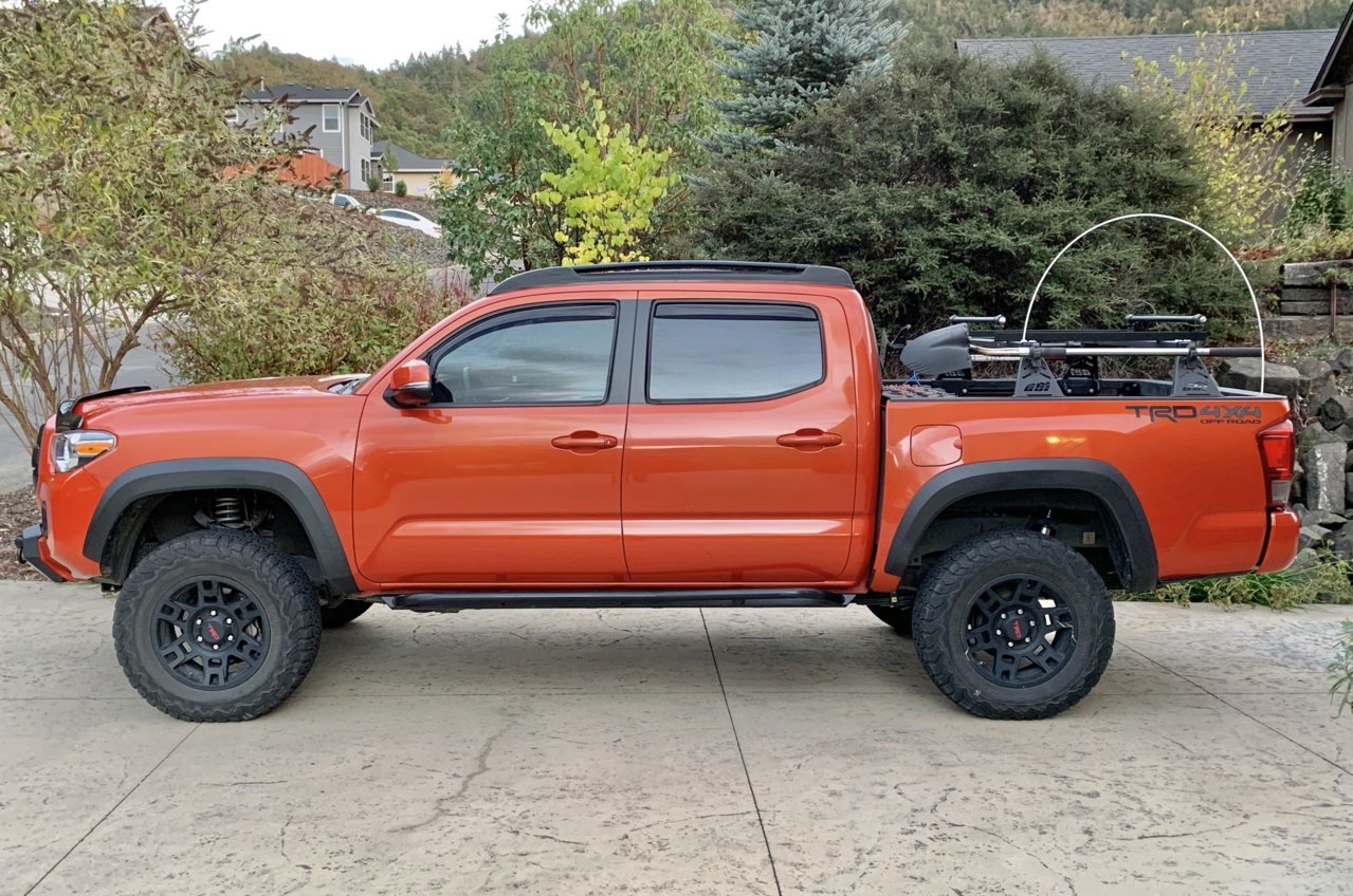

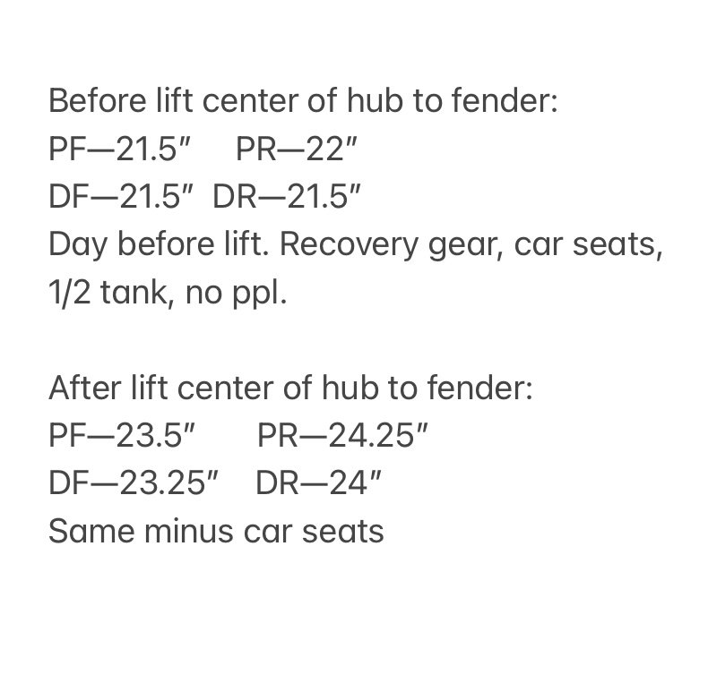

    19423F95-0F20-4DC7-AC3B-0E9424F83493.jpg 66B5E04C-7587-4679-B50B-7CEC24847B8C.jpg
    Eibachs plus Dakar med pack. A little higher than I expected. Drives more like a really nice Jeep now—stiffer but tracks straight. Did not do UCAs yet. 300+ highway miles tomorrow should be a good road test.
    (Before measurements include front spacers shown in previous post. )
    Thanks Marie @HeadStrong Off-Road for all the help!

    Looks great. I was looking for measurements like this. What tires are those?

    265 70 17 BFG KO2–31.6” officially. They’ve done really well for us so far.

    Why are you all measuring from the center of the hub and not the ground? What is the difference?

    Measuring from the ground can vary from vehicle to vehicle due to tire/wheel size. So it's more information folks would need to post to be clear about the change in height they experienced. Since the hub is a fixed point of reference, measuring from the center will always give accurate numbers regardless of tire/wheel size.

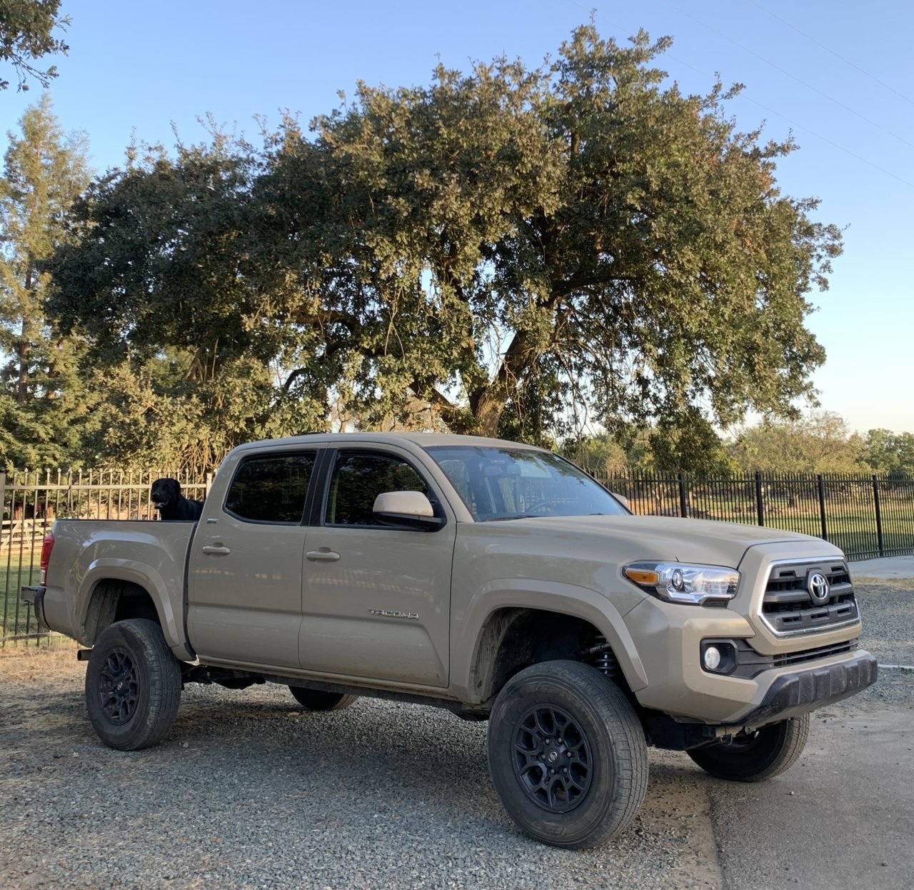

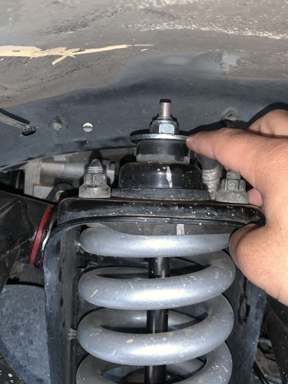

    Just an update on my truck. I feel like it has settled. It doesn’t look super high in a way although I’m not 100% sure. Another thing I noticed a couple days ago was a loose washer on top of each strut. Would these washers feeling loose be a sign of the suspension settling? I was told a re-torque would be a good idea after some miles on the new kit. Is this why? Has anyone had this happen before?
    taco kai and CygnusX191 like this.

    I believe that you need to retorque after 200 miles. I used a metal marker and marked all the nuts to see if they moved. BTW. after 100 miles my truck now sits at 2.5 inches so it settled down from 4" finally :) I'll post pics once the AAL arrives and gets installed.
