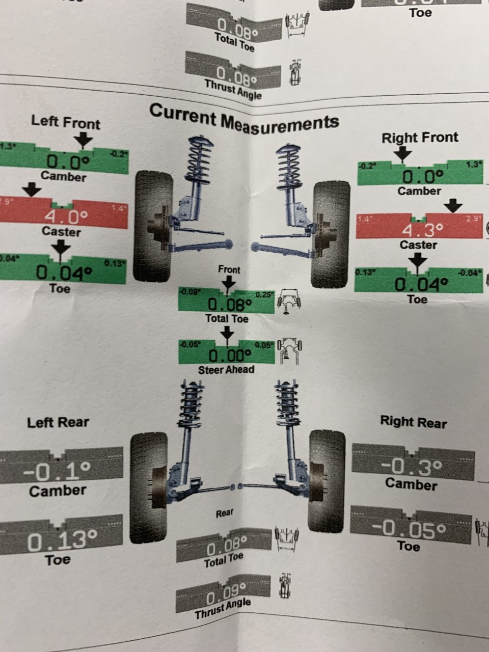

    4C33FBD4-9945-4682-B6F4-91FC2EEB0582.jpgI would’ve never been able to achieve these numbers on oem UCA’s. Imo some need them and some don’t. I definitely needed them. The adjustability on these is awesome.
    CygnusX191 and taco kai like this.

    was it hard to find a shop that knew how to adjust them, or did you get it close yourself?

    Yes I had a shop I know install and adjust them. Learned a lot on here from members. Imo truck drives so much better. I know it’s some coin for uppers but well worth it in the long run.
