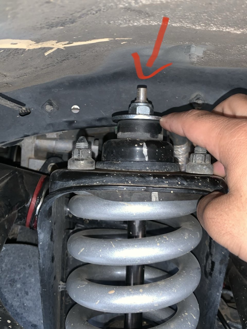

    So I went back and tightened up these loose nuts. And the top piece started spinning after it got tight enough. Does that adjust anything? I don’t want to throw anything out of whack. It was spinning the whole piece.

    You need to have two wrenches, one to go on the nut, and another to go on the piece the arrow is pointing to. It has two flat faces on it for the wrench to grip and hold the threads still while the nut turns

    yeah I was gripping it with some pliers because that’s all I had. But they wouldn’t hold enough. I will go back later with a wrench. Do you know if that piece adjusts or makes any changes to anything when you spin it?

    Spinning it does not adjust anything, no worries

    To my understanding, that is the top hat that actually holds the spring in its compressed position. Factory torque spec is 20 ft/lb according to a diagram I saw, but I'm not sure what Eibach's is. I wouldn't worry about it too much unless it's super loose

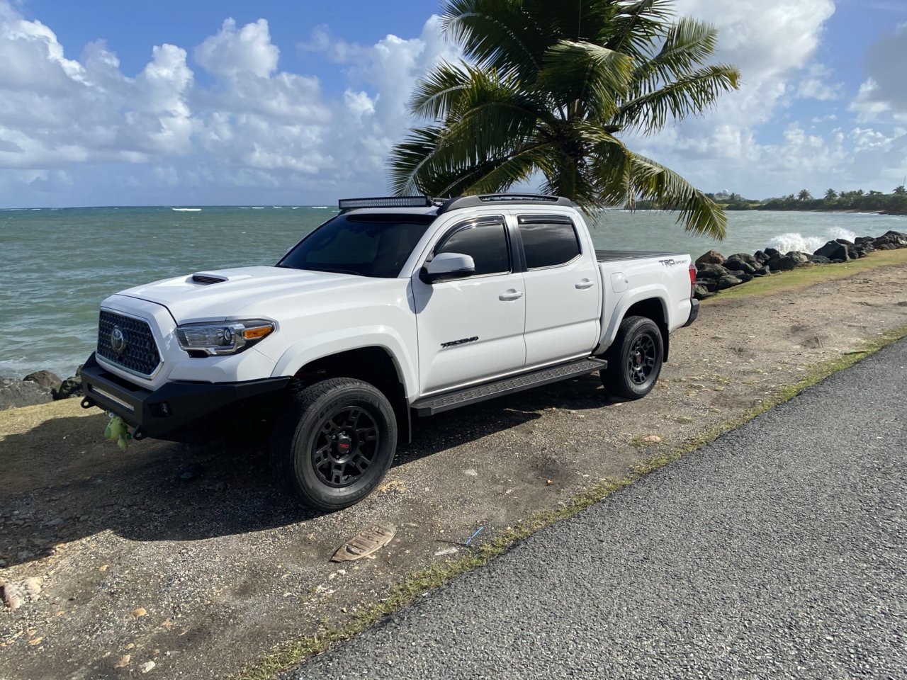

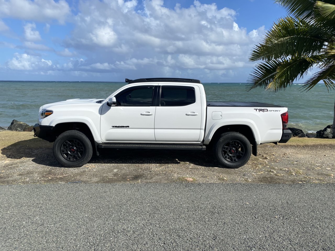

    Well, I finally was able to get a good shot of the truck with the Eibach lift. I am still waiting on the AAL to arrive but for now, this is her stance. Once I get the AAL installed I'll post another one. Going to add an uptopoverland Bravo rack once they get back to me on how much is the shipping. I will be adding the Scorpion AT Plus tires as well once the stock tires wear down some more. I have 25k on the stock tires and they still got plenty of tread on them. Might look into selling them.
