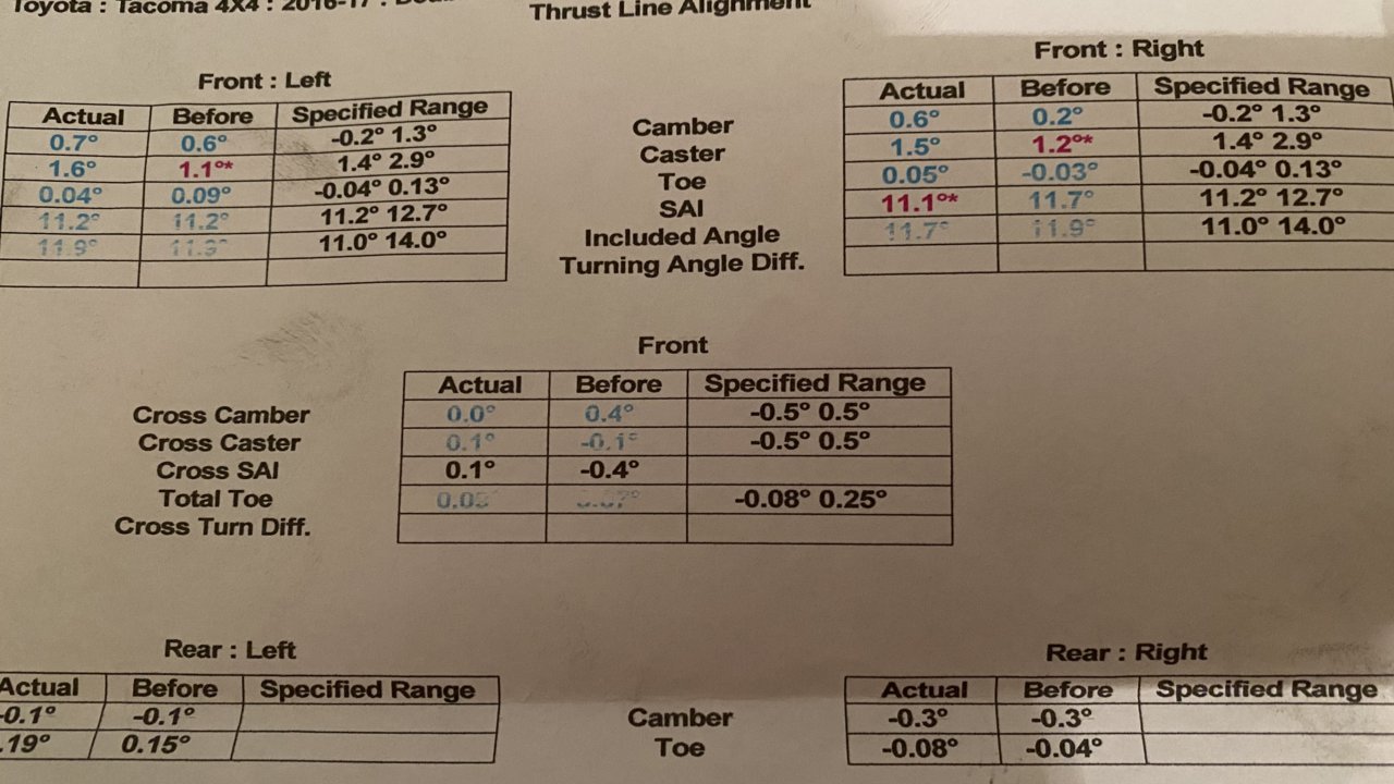

    Thx for posting up, I was wondering what spec range was for each. Surprised caster so low 1.4-2.9.
    I have JBA's on the way too, waiting on the ship tracker email.

    SPC’s. JBA should get you what you need good luck and post numbers when you get them installed

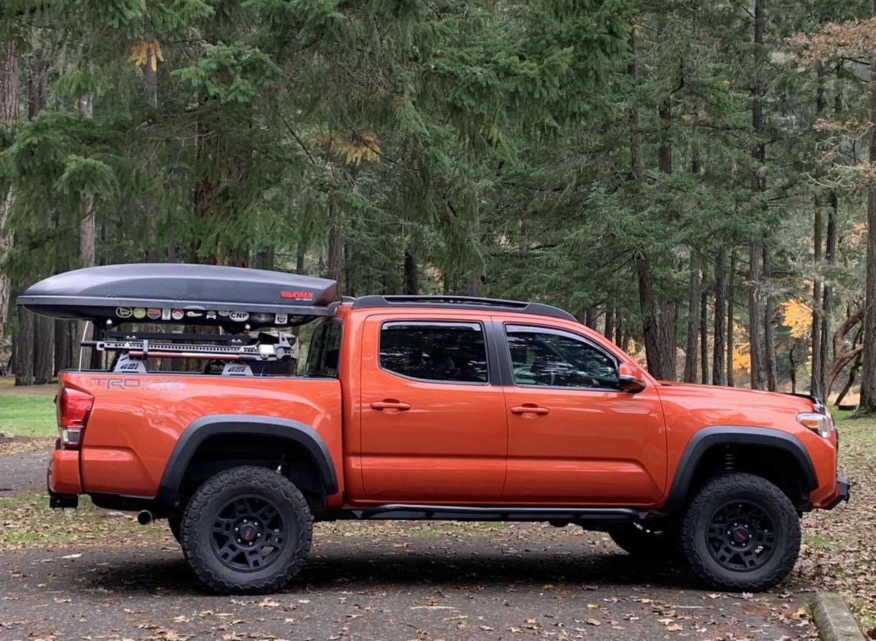

    2018 Tacoma TRD OR QuickSand
    Cooper AT3 XLT 295/75/16 Method Double Standard wheels Eibach Pro lift Baja Design Fogs Baja design Ditch lights W/ Cali raised Lo pro Brackets WrapArmor Hood Decal
    Second notch and ride feels good so far on road. Tires are 265/75/16 rear I’m using maxx trac blocks 1.5” C31AF1FA-080A-4417-BBB1-B79EE777FF1B.jpg

    69
    Looks good. I just put mine in the second notch I’m just deciding what to do in the rear
