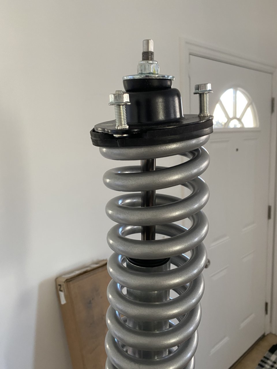

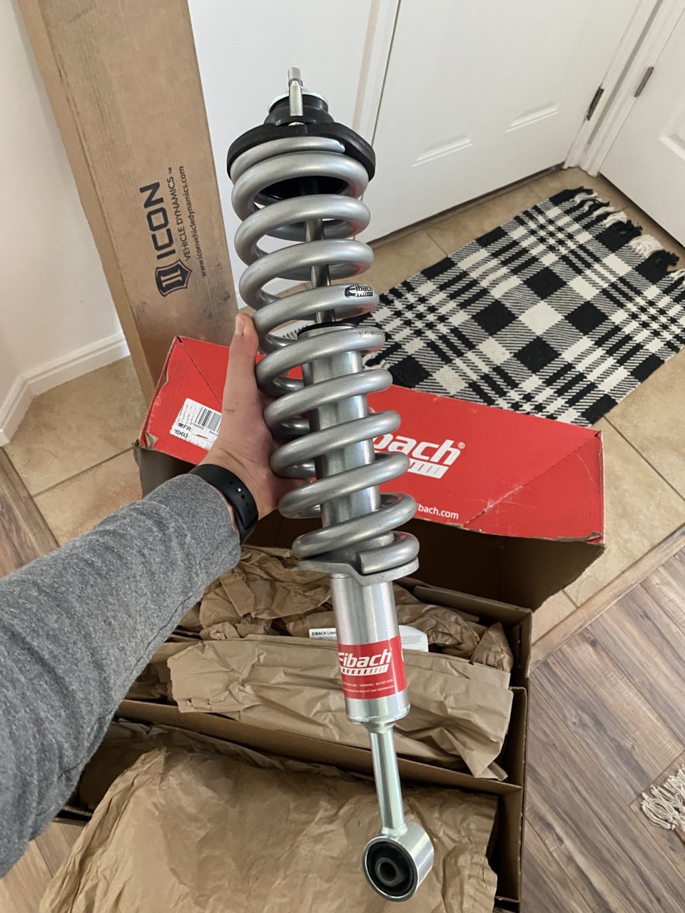

    I just received my kit. I bought the struts already assembled but noticed they look a little off. The top hat looks like it is crooked or on an angle. Did anyone else experience this buying assembled struts? Is this normal?

    Mine came assembled too. That definitely looks crooked.

    Is it sitting in the perch spot correctly? Is the spring end in the slot?

    The shock doesn't looked centered in the spring.

    It's completely normal. Because the strut mount has a rubber bushing above & below the plate it allows the plate to squish one side of the bushing more than the other. This happens since the spring style is not flat at the top. Once you install it and tighten up the bolts everything will straighten out. :thumbsup:

    I was thinking, Install it. and if it still looks off you can drop the lower control arm and loosen the top nut so you can reposition the spring and then tighten it. Just about like a "no spring compressor install" I know but that is what I would probably do.
