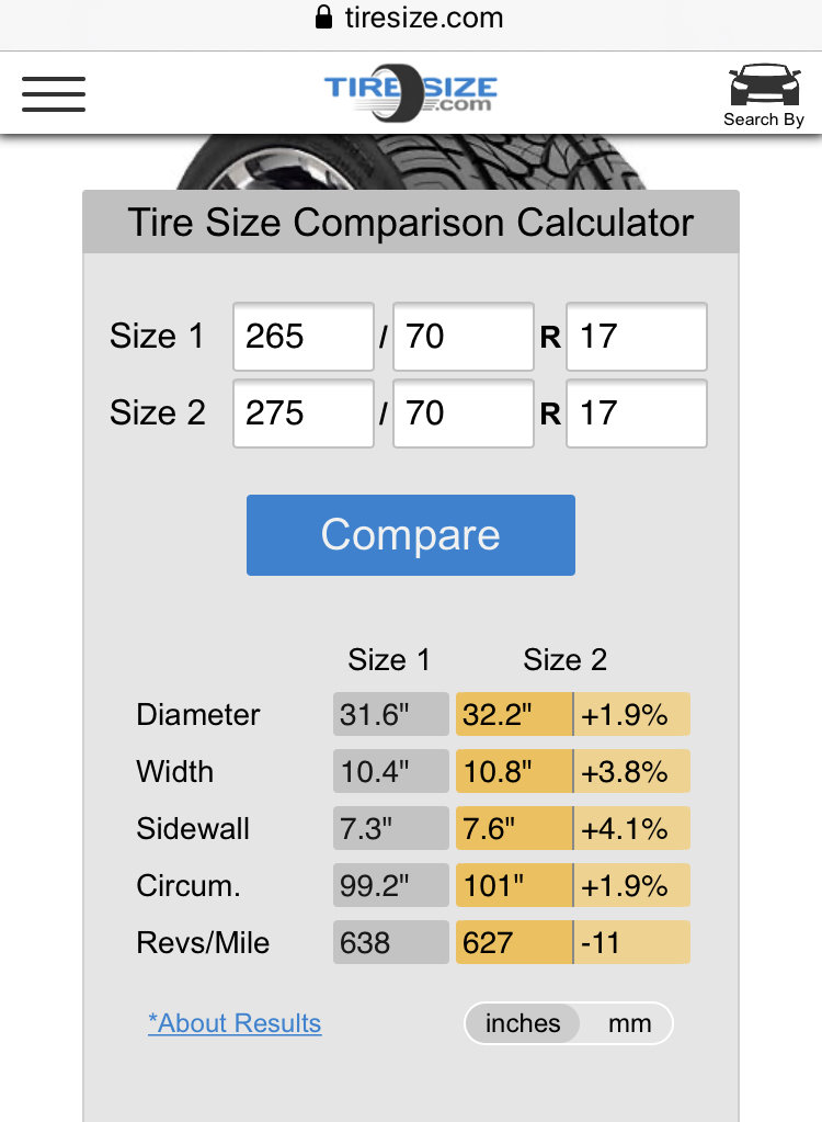

    You should be just fine. I believe stock wheels are +20. Comparing my wheels/tires to yours, mine are like .25” wider. The offset difference is -9 or .35” further out. So let’s call mine .5” half inch further away. My UCAs measure @ 2-3/8” from tire wall. So you should have @ 1.75” free n clear. And the Eibach pros should bring you up 2-2.5” they say. I wish I could say what my change was but I actually dropped down instead of up cuz I went from a 3” spacer kit to removing that and installing the Eibachs which gave me a .5” increase in height. But I don’t know what my stock height would be with my size tires so I have nothing to measure or gauge the actual height increase with.

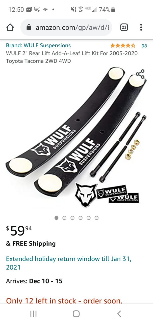

    No I bought the Wulf 2".

    https://www.amazon.com/dp/B07Y438X7Q/ref=cm_sw_r_cp_awdb_imm_t1_qQsYFbYJXZB3S
    I didn't leave a review but those on there should sell it to you.

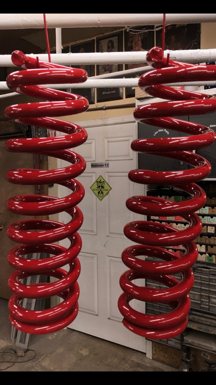

    Dagum that's a nice price

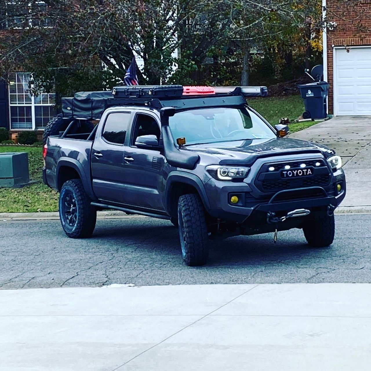

    Prinsu Roof Rack Mictuning Rock Lights 8ct Mictuning 32” light bar Caliraisedled Ditch Lights Caliraisedled TRD Pro Grille Calirqisedled rear Amber pod lights Baja Designs s2 sport pod lights Eibach pro truck lift stage 1 OME Heavy duty leaf springs JBA upper control arms Smittybilt X20. Winch Smittybilt RTT SSO front bumper

    Why would they mount a satellite dish so low that the trees can block it?

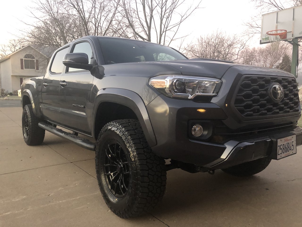

    And, here are the installed pics!
