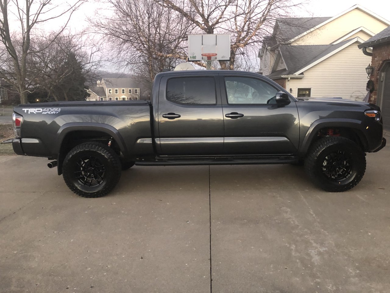

    I finally completed my install over Thanksgiving. Here is my very long post to dump my experience into!
    Eibach Stage 1 pre-assembled on the first spring perch, 1/4" drivers side spacer, OEM UCAs, ICON 1.5" AAL (overload removed), ECGS Bushing, stock weight, 32" tires, no diff drop, no carrier bearing drop, no new axle shims. Thank you @HeadStrong Off-Road for the help along the way - I highly recommend them.
    The installation was pretty straight forword. I watched a lot of videos to prepare, hit my bolts with lots of penetrating oil for months prior to install, and took my time! Something I did different than the videos was that I did not unbolt my tie rod or UCA castle nuts. I unbolted and installed the sway bar relocation brackets first, then swung it up out of the way. I unbolted the lower ball joint mounting bolts, released the CV axle from the hub, and moved the whole assembly up and forword with a jack stand to rest it on. I had to do this for the front left for the ECGS bushing install and it worked great to get the old strut out, install the bushing, then install the new strut so I did the same on the right. Surprisingly, I was able to remove all my bolts pretty easily up front - I thought I was going to have to cut the strut top nuts off.
    The ECGS bushing installed well, but it does take patience to align it and then tap it in. I installed it with the strut removed which gave me some clearance inside the LCA to short swing a 2lb hammer against the bearing press tool (should be able to loan one from an auto parts store). Removal of the needle bearing was very easy with the ECGS tool - I used a steal wire with a loop to hold the removal flange while slipping it into the diff and getting it into position. I did not stuff any plastic or anything inside, the wire held it well, positioned it, and then I pulled the wire out.
    07FBC3F7-8855-4B87-8C40-BD93657C4E98_1_105_c.jpg FF0E0FD3-A1D5-4E8D-ABD4-3DE2A9FE9017_1_105_c.jpg
    The rear was relatively easy as well. Watch the videos, clamp the leafs together very well, and use 2 jacks under the axle to manipulate it. My U-bolts unbolted with ease using an impact wrench. However, the left rear shock top bolt was seized so I had to cut it off to get the shock out. Also, my truck had a small axle shim that I re-installed. I forgot to measure it but it seemed like a small 1-2 degree shim. I wanted to install the Headstrong AAL but they have been out of stock for ~6 months so I gave in and ordered the ICON AAL. The downside of the icon is that you have to cut/grind off one of the factory spring clips, there is no mounting location/bracket for the parking brake cable (zip tied back for now), and the U-bolts supplied are very long.
    My results measured at the centerline of the wheel up to the fender flare edge:
    LF: +1-7/8"
    LR: +1-1/2"
    RF: +1-1/2"
    RR: +1-1/8"
    Pre-Lift Measurements (~1/2 tank of fuel)
    LF: 35-1/2"
    LR: 36-1/2"
    RF: 36"
    RR: 37-1/8"
    After 100+ miles and alignment (empty fuel tank)
    LF: 37-3/8"
    LR: 38"
    RF: 37-1/2"
    RR: 38-1/4"
    I am continuing to track the measurements out of curiosity since I did see a lot of variation initially. I may report back if people want to see what I have.
    Before Picture (a slight up hill):
    After Picture (a slight up hill):
    Alignment:
    Things I learned:
    1. I wanted 2". Based on my experience with a DCOR 4x4, you are not likely to get a full 2" up front.
    2. You could pre-plan to do a 1/2" drivers spacer (need longer studs on top mount) with a 1/4" passenger spacer to get that extra 1/2" without going second perch which could be too much. I estimate (just my opinion) that moving up a perch could get you 3/4" to 1" which will be too much for stock UCAs. And probably end up nose high if not installing a new leaf pack with 2" of lift.
    3. A 3/8" drivers spacer might be a better option; but Taco Lean is more evident in the front with an empty tank and levels out/inverses with a full tank. I am considering doing 3/8" drivers and have or make a 1/8" spacer for the passenger side.
    4. Corrosion...I had a very foggy day with a lot of condensation 1 week after install. Shocks, shock top bolts, washers, and nuts all have some corrosion where the dew settled out. I had considered pre-treating everything and should have. I am going to go back, clean it up a little and coat the hardware with fluid film.
    5. The lift seemed to accentuate my tire noise/hum/subtle vibration at 25-35mph up front (my tires have ~5k, are rotated, and balanced). I lowered my tire pressure to experiment and it greatly improved it. I will continue to mess around with pressures to get good tire wear and be sure its not something else up front. That said, my truck (and others on here) seem to have some minor noise/vibration that Toyota sort of acknowledges. I am not going to overthink it bc it was like that when I got it last year.
    6. As far as I can tell, I have no driveshaft vibrations. I will measure my angles at some point soon, but I think I am good.
    7. The alignment seems good for the lift height - does not feel loose pr wander. Time will tell.
    8. The ride is definitely stiffer then stock - as everyone says, less nose dive on breaking, less sway. Drives well on the road and I don't find it uncomfortable, but I am curious how it will do off road being so stiff. I plan to do mild to moderate trails; not likely to do extreme stuff.
    9. As I add armor, starting with RCI Sliders this winter, I am curious how much it will sag up front. Future problem...
    Congrats if you managed to read all the way through. I literally read every single page of this thread (~150 pages before I ordered my kit and every page after!) and appreciated every post that had details. So, I hope this helps someone out there!

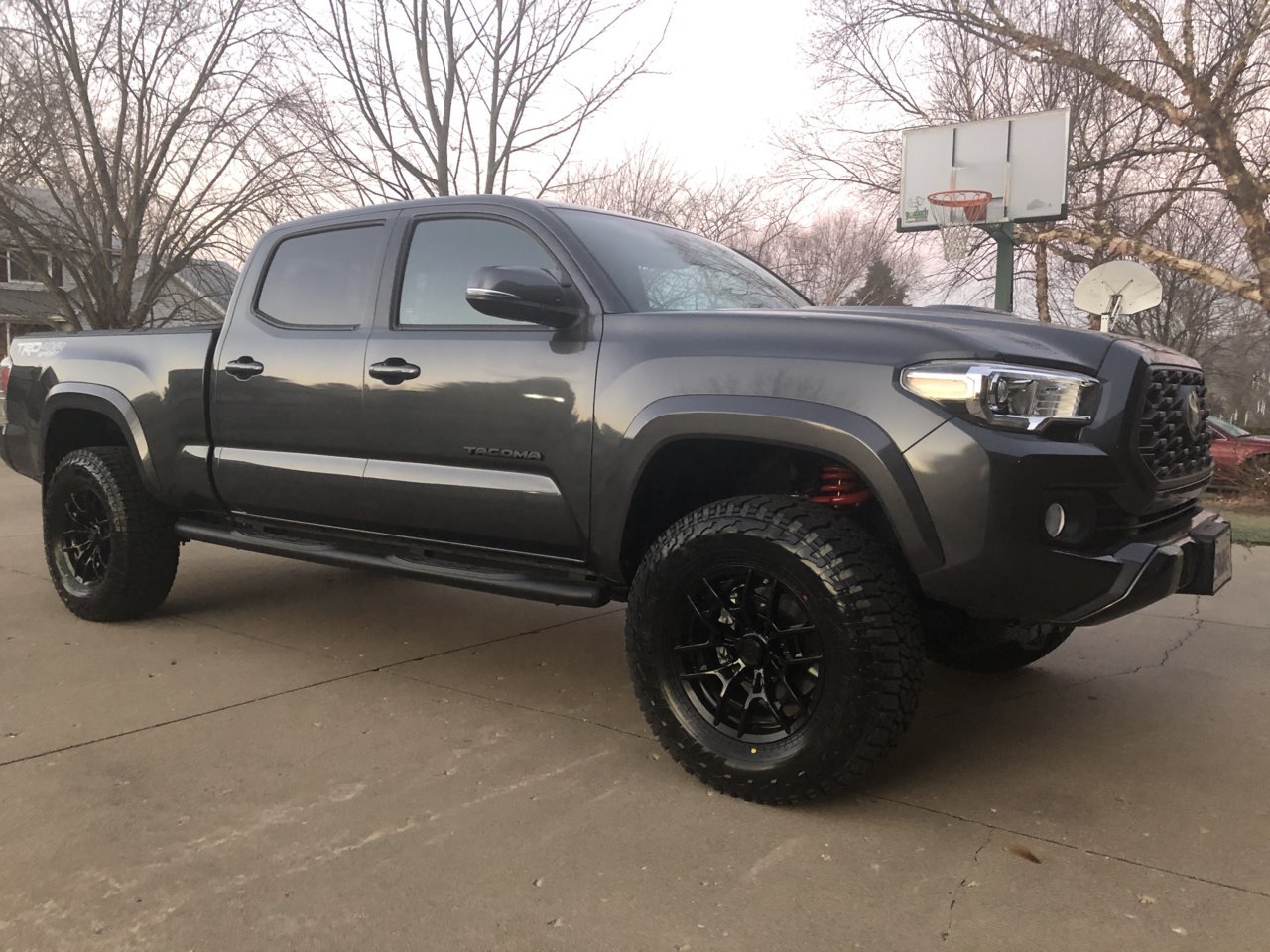

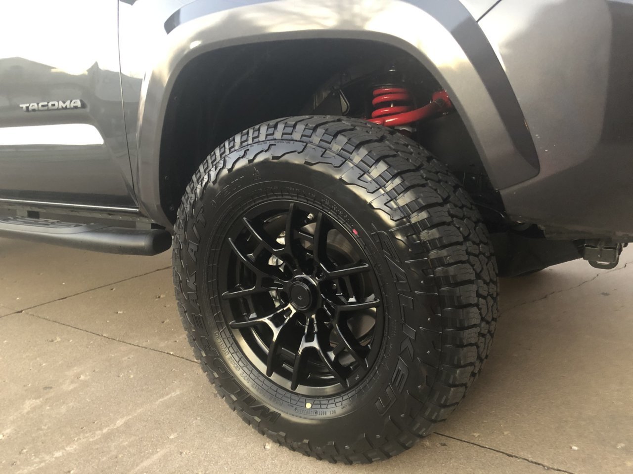

    My review of the lift kit:
    The kit went on my 2020 TRD Sport DCLB. I installed the kit at the lowest setting along with HS 1/4" front driver side spacer, ECGS bushing, JBA UCA's, Archive Garage Hammer Hangers, 1.3125" rear lift blocks, and carrier bearing drop kit, 17x8 zero offset 2020 TRD Pro replica wheels, and 285/70R17 P-rated Falken Wildpeaks.
    I simply could not be more happy with how it turned out. I love the new look and the ride quality is BETTER than stock. I installed the rear shocks first and drove with them for awhile as I awaited other parts. The Eibach rear shocks alone are indistinguishable in ride quality to the stock TRD sport shocks. The rest of the kit and other parts were installed at the same time a few weeks later. In terms of stiffness, I find the ride very similar to the stock TRD sport - very little body lean, very little nose dive while breaking, and no bounciness. If you have an off-road model, I imagine that you will find the ride slightly stiffer than stock but, since it is very similar to the sport, not obnoxiously so. As far as differences from stock, the truck does feel more planted on the road - I assume because of the larger tires. Also, I no longer feel every single expansion joint and minor bump in the back which the TRD sports are unfortunately notorious for. I assume this was largely because I installed the Hammer Hangers with my lift. Finally, the larger tires have almost no additional road noise. To put the road noise in perspective, on a scale of 1-10 (1 being quiet and 10 being a very loud tires), I would say stock is a 1 and the Wildpeaks are a 1.5.

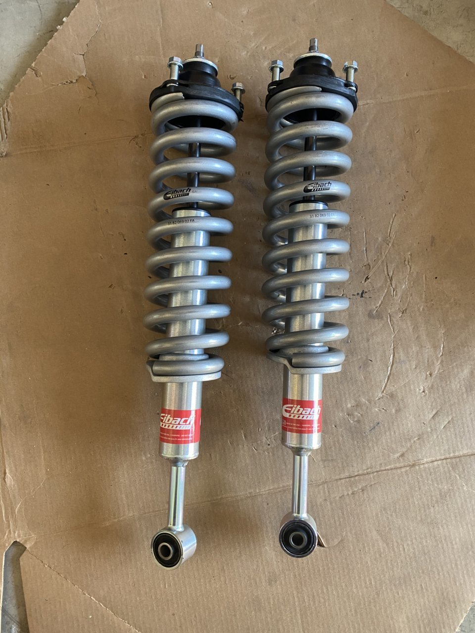

    Assembled the front this morning.

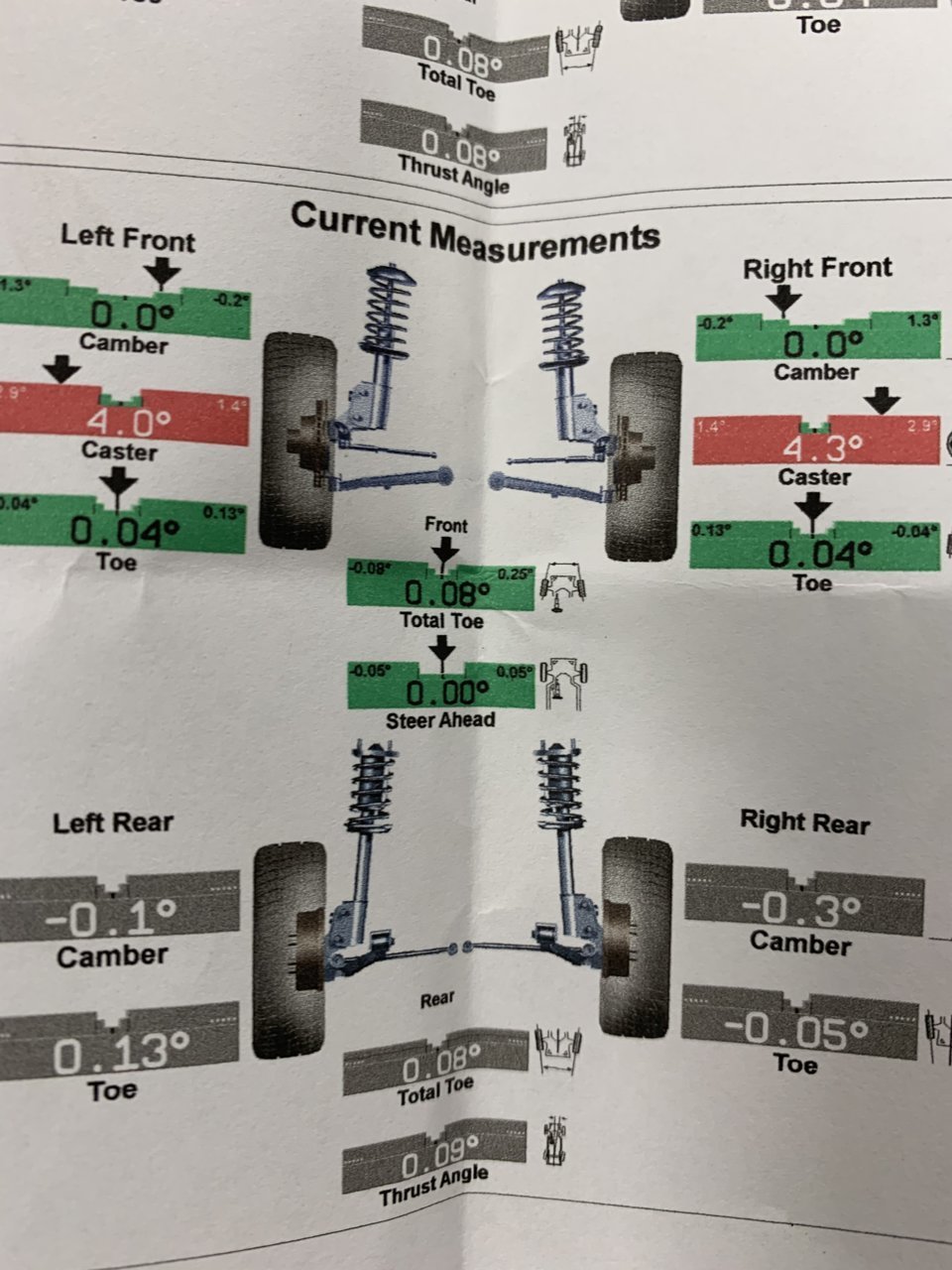

    The alignment shop is asking for specs from the lift. Should they just do factory settings or is there something else I should tell them?
  20. Dec 8, 2020 at 10:55 AM
    #4140
    MrBrooks
    MrBrooks Well-Known Member
    Oct 14, 2017
    #232988
    1,224
    Midwest
    2018 DCSB - 2021 Rav4
    No don't do factory #'s. As close to 0 on camber & toe as they can. Depending on your truck & tire size go 2-4 on caster
    Here's a sheet someone posted recently that will give them something to work from
