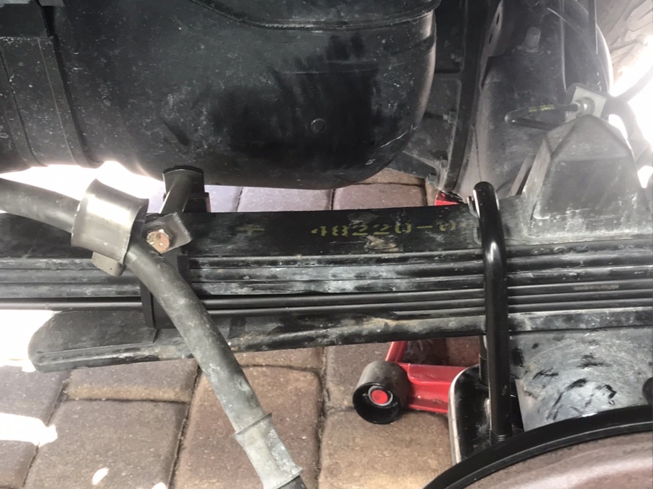

    @Dave13
    Brake line bracket- I used the original brake line bracket and just drilled out the hole to accept the Icon bracket bolt. I beat it a bit W a hammer to push it down and closer.

    I was going to look at doing that too but I don’t want to strain the brake cable to much. Yours looks tight but do have enough play/flex in it?
    I also thought about making a small extension bracket out of aluminum to mount to that same bolt but position the cable bracket a couple inches lower.

    Truth is that the bracket is maybe an inch higher than before so it’s not a major alteration in position. I’m going to see if they have something similar at the auto part store and upgrade as well.
