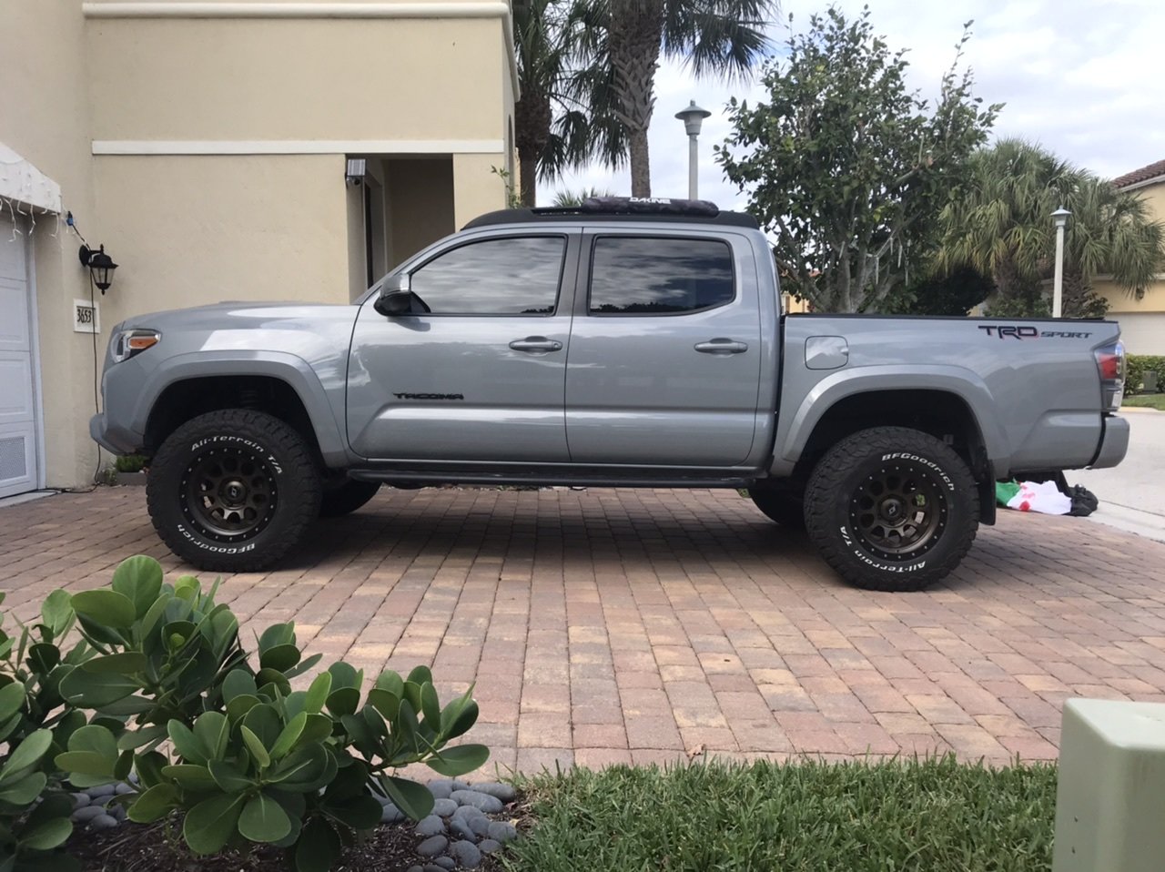

  14. Dec 20, 2020 at 9:45 AM
    #4174
    E40Taco
    E40Taco New Member
    Dec 20, 2020
    #350209
    2
    2020 Black Tacoma Off-road
    Looks great! Any rubbing? Just got the same lift set up but still on the fence about going 275s or 285s.
  15. Dec 20, 2020 at 9:47 AM
    #4175
    OMGitsme
    OMGitsme Well-Known Member
    Feb 8, 2019
    #282305
    2,401
    Sold
    Thanks!
    Not in any of my mall crawling. Love the 275's.
  16. Dec 20, 2020 at 6:58 PM
    #4176
    E40Taco
    E40Taco New Member
    Dec 20, 2020
    #350209
    2
    When you get a chance do you mind posting more pics of it?
