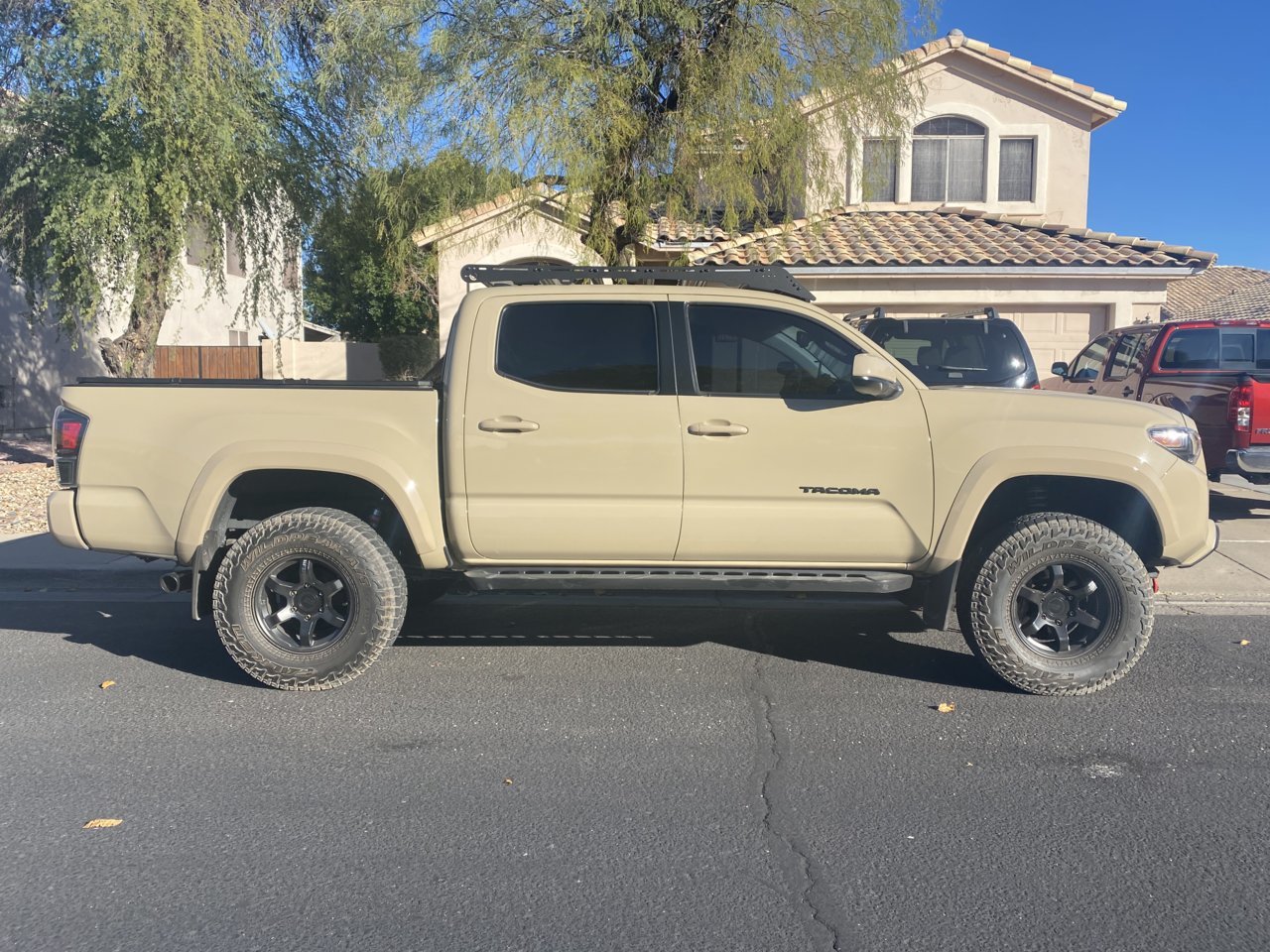

    Installed the fronts with a lean spacer on Monday, and the rears with the eibach 1” block on Tuesday, probably about 2.5 hours total.
    First couple days the front was sitting at about 2.75” over stock, and I had about half an inch of reverse rake. But after driving all week and putting some miles on it the fronts have settled to about 2-2.25” and i have about .25” of rake. The fronts are dead even left to right with the 1/4” lean spacer.
    I’m going to switch the block for the headstrong aal being that’s what I originally wanted but they where sold out. May even consider a single aal but I need to do some more research.

    Good call on ditching the block

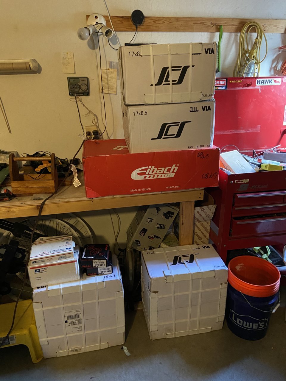

    Well it’s finally almost time! Just need to get the struts assembled Monday, order my tires and set an alignment appointment for the following week and hope everything goes smooth.

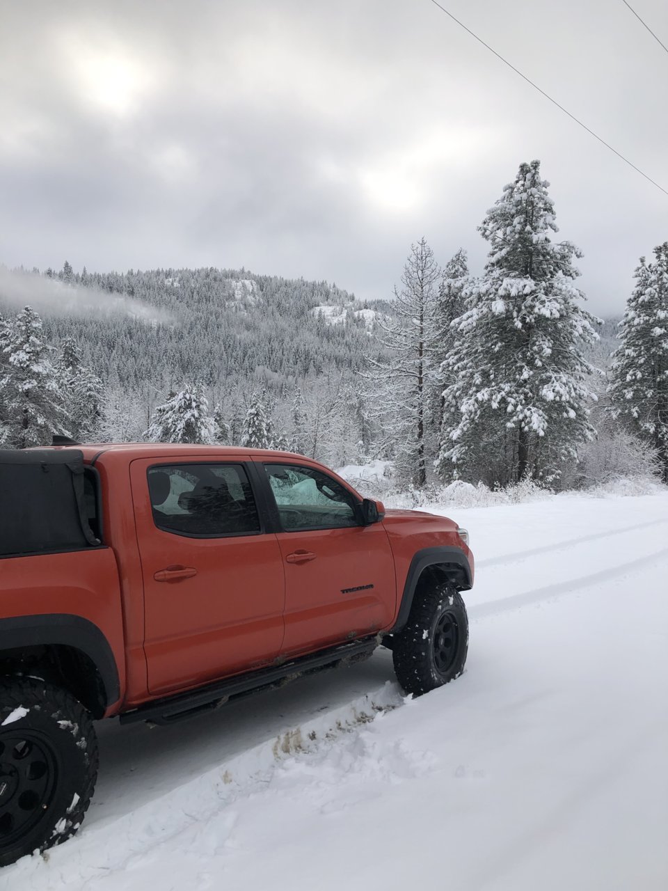

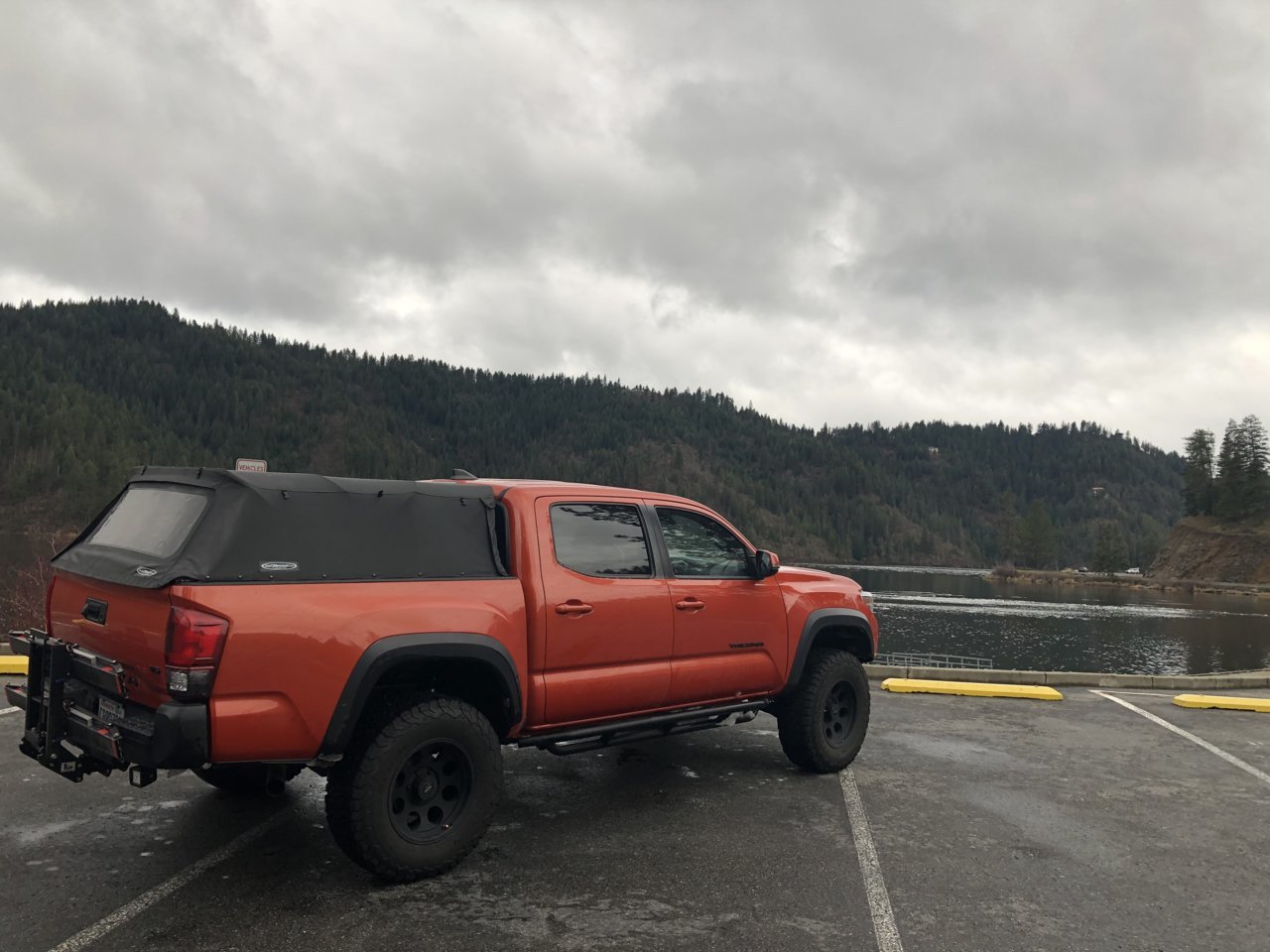

    Wanted to chime in with my review of the Eibach setup after ~5,000 miles. I installed with second clip, and still am very pleased with going that route. I was concerned it would be too stiff (I don't have a bumper or armor), but overall my suspension feels great. No front end diving at stop lights like the soft TRD Off-Road shocks did. With the recent snow in the PNW, I feel this suspension is getting worked more and is getting softer (but it may be in my head). I still should upgrade my UCA's, but overall recommend second clip to anyone.

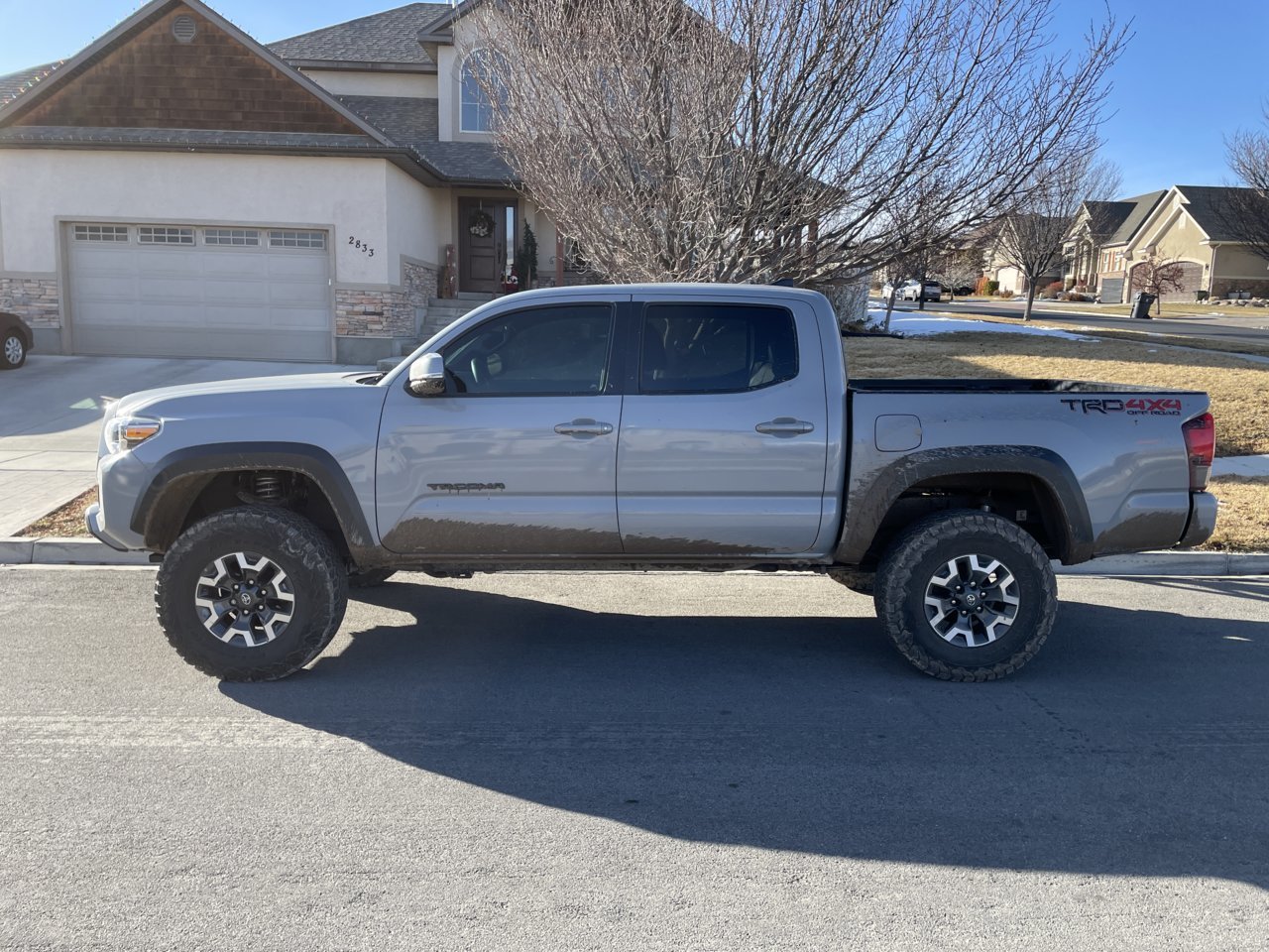

    Here’s how my 2019 sits with the Eibach lift on the first notch and Headstrong AALs. I’ve only driven like 200 miles since installed. This was just after playing around in the hills behind our house. Such a huge difference between these and my 3/2 spacer lift I had on it before.
    And these are 265/75/16 KO2s.EEC6D3C9-22C5-493E-A909-52FA7ECC588B.jpg

    Truck is sitting nice, is that the 1.5" Headstrong AAL?

    Yes it is. And without the overload leaf too.
