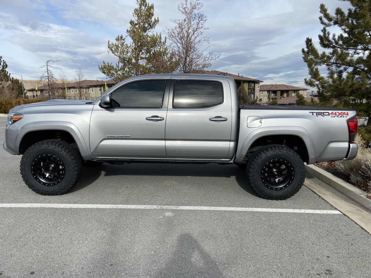

    #TransformationTuesday Looks good man! Literally night and day.
    The black wheels really make that Silver Sky POP

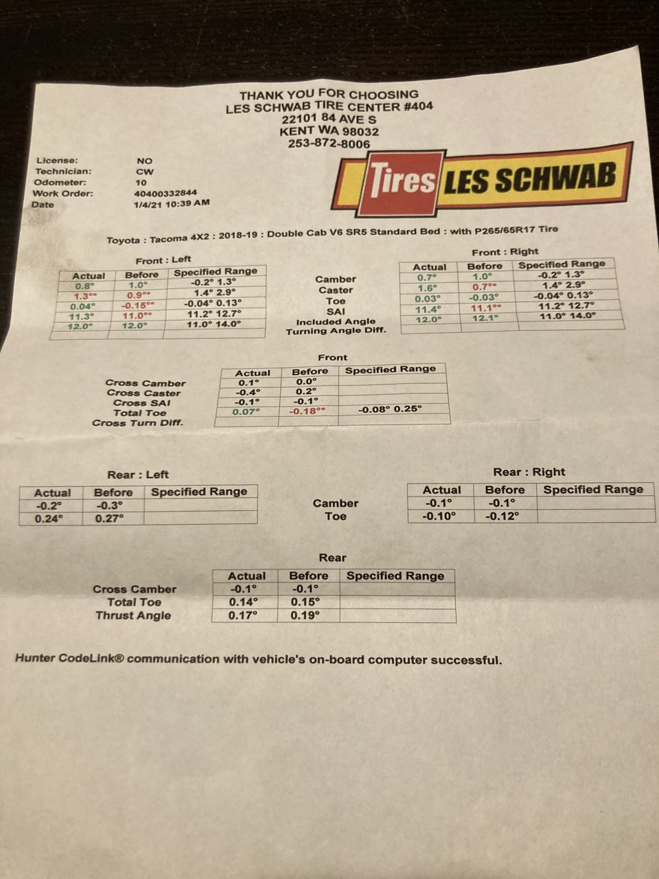

    No, it’s all OME up front. It’s a lot more lift than I bargained for. Needed to do upper control arms ($600 out the door) in order to align. And definitely need larger tires

    Oh ok, I gotcha. The UCA are expensive, but believe me your truck will drive so much better when you get those caster numbers up.

    I was under the impression I did not need them. Before OME UCA install truck pulled left and was all over the road.

    From what I've seen and experienced, any 3rd gen Taco lifted ~2 inches will need aftermarket UCA to get their caster back into the +2 degrees or greater range. Any caster numbers lower than this will not track very straight on the road. It will want to wander and steering feel will be vague.
    Also, cross caster matters more if you mostly drive roads that are very crowned (for water runoff). Cross caster can help eliminate pulling to the right while driving in the right lane.

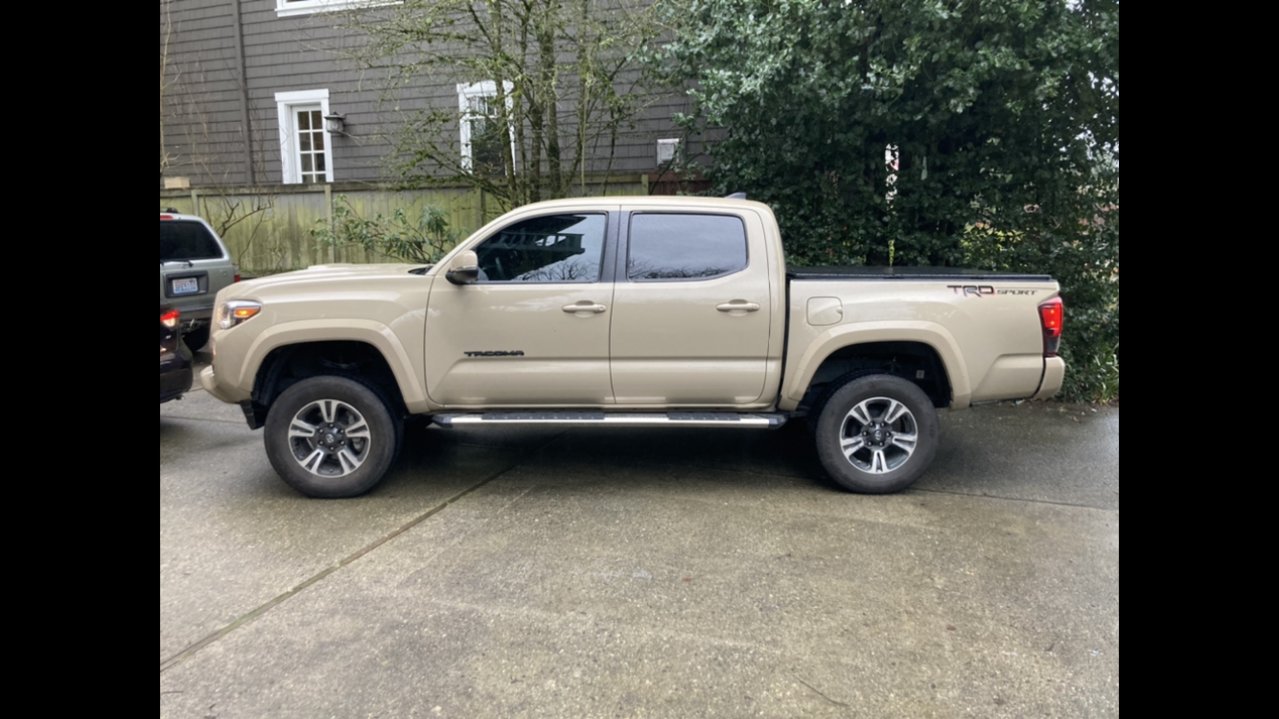

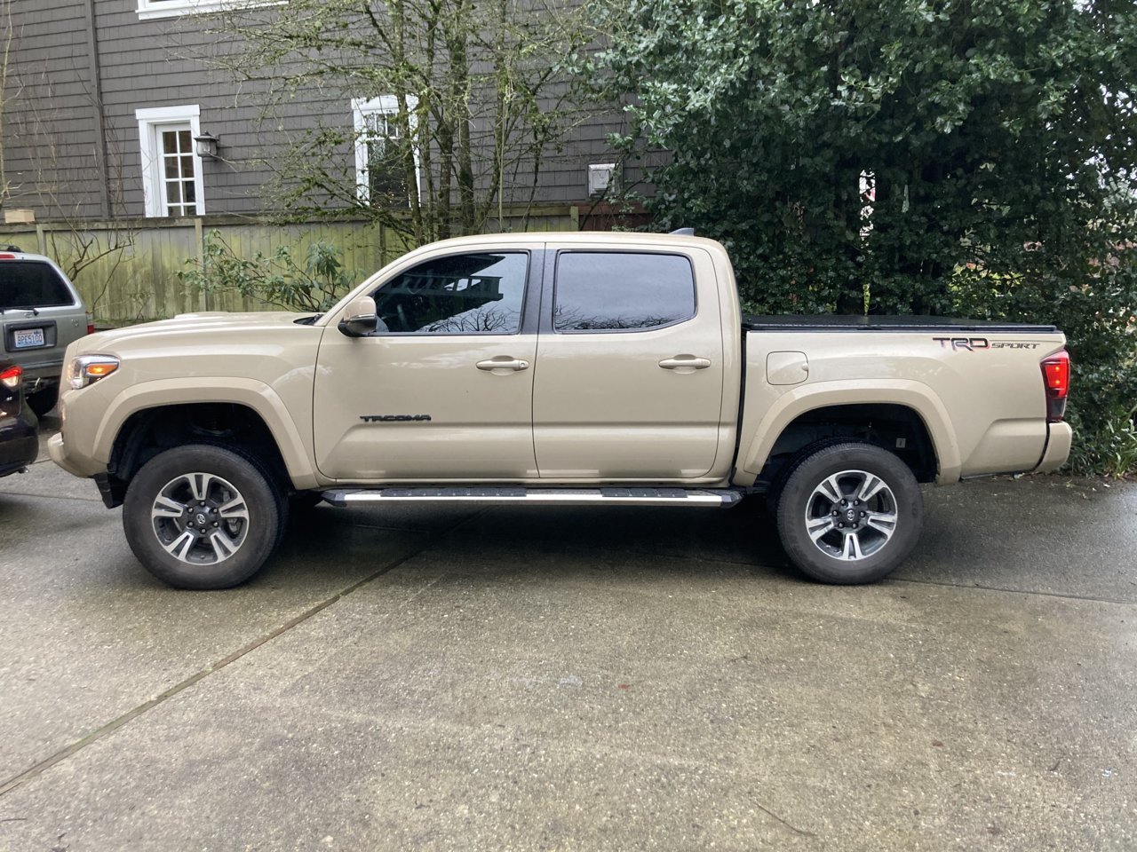

    I originally purchased the old man email kit without upper control arms. The rep at Toyotech said I will not need them. After lifting the vehicle with the 887 springs I achieved 3 1/4 lift over factory. For whatever reason it was this high… I had to additionally purchase upper control arms.

    Wayyyy high. Double/triple checked/ got second opinion of why it’s higher than a giraffes ass. No clue.
    Yes kit came with carrier bearing drop. Needed more of a drop tho. So used washers as shims till it went away , then cut chunk of 6061 aluminum to replace spacer and washers. Vibe felt 15-20mph, similar to chunky mud tire vibe. Truck is 2wd, no diff drop. I haven’t read of anyone with this ‘lift is higher than expected’ issue yet. 887s are known to sag after a bit tho

    2wd. That's why you got more lift than the others. Front is lighter than a 4wd.
