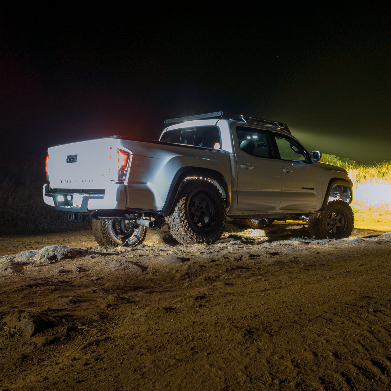

    Setup? Tire size, wheels? Looks sweet man! What notch on the Eibach's?

    Lowest notch, 17x8.5 -10 285/70, SPC UCA. 0 rub even in full articulation.

    That's good to hear, I have SCS SR8's with same specs. I plan on getting Eibach's. Just not sure what tire size. But 285/70 is a good start. I would really like to go 285/75. I feel like I could clear with CMC and trimming. Not opposed to. Just have never had a lift kit, so I honestly don't know. I appreciate the info.

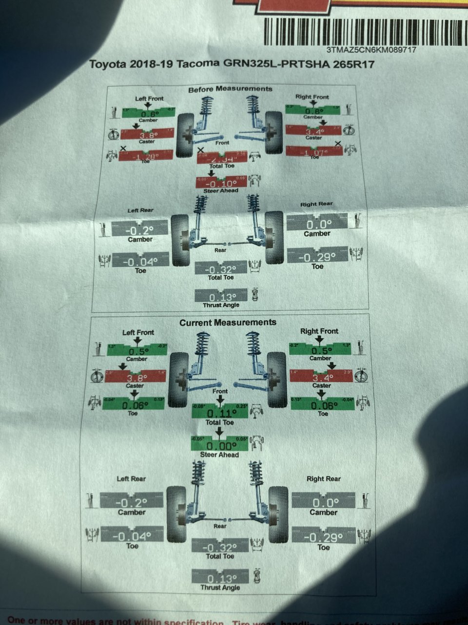

    Do you have a pic of your alignment specs? I went though hell to get my alignment where it needs to be

    I don’t have it on me. The guy that did my last alignment knew what he was doing and had it exactly where I wanted it I’m about 15-20 minutes. He had me stand there and look at the screen while he made the adjustments. I told him where I wanted it and that’s what he did.
