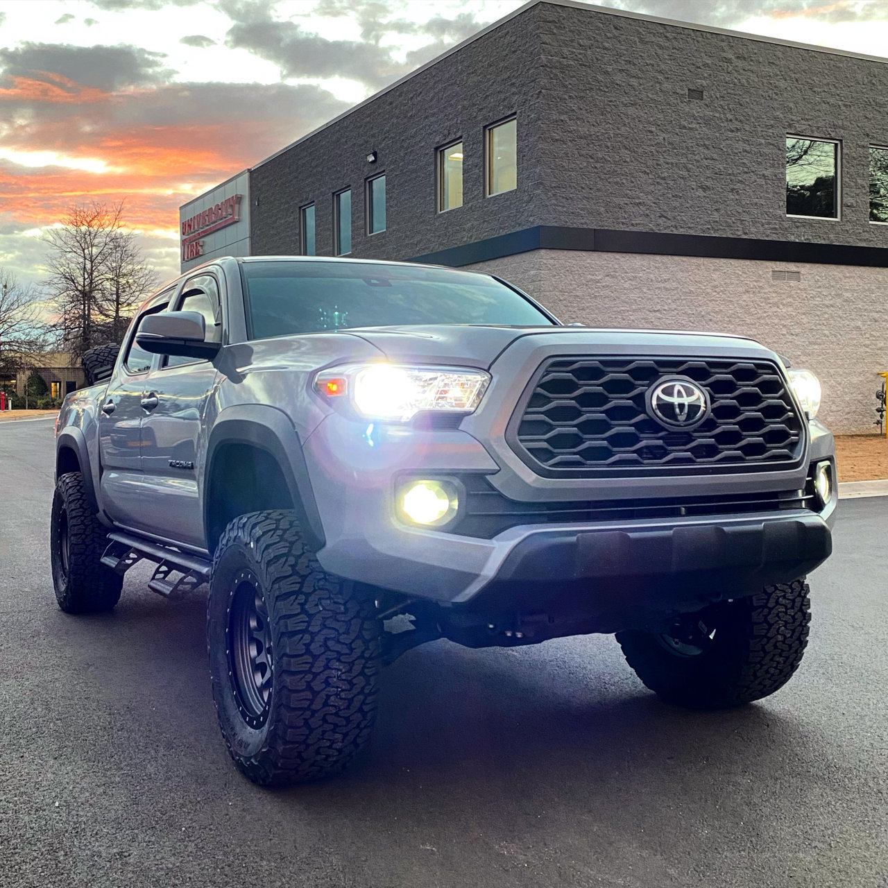

    33x12.50r17 KO2S on SCS Ray 10s with a -10 offset. Zero cutting and zero rub! Loving the new setup so far!

    Is it just the pic or are you squatting?
