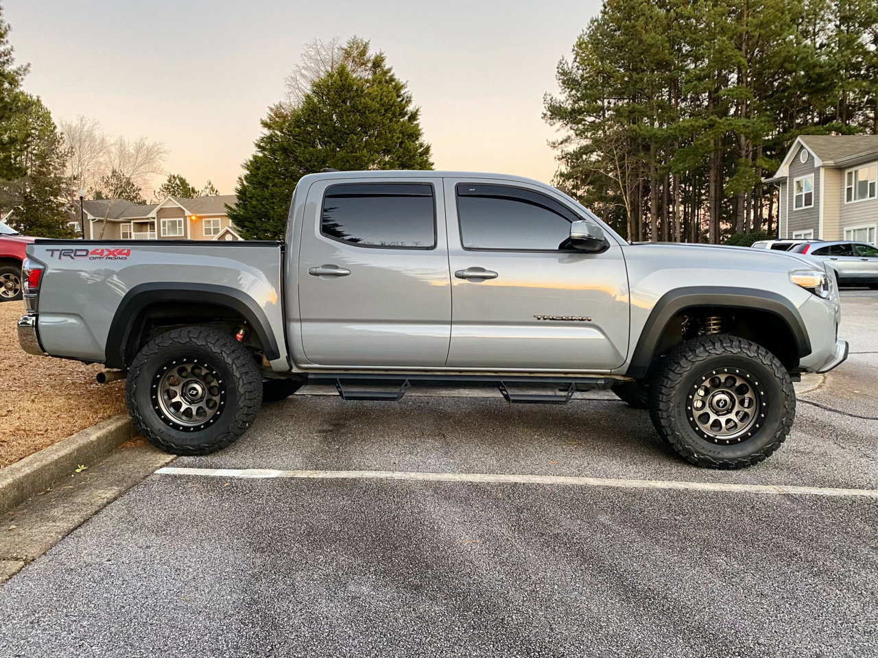

  11. Jan 28, 2021 at 2:11 PM
    #4371
    rbhowie
    rbhowie Active Member
    May 7, 2020
    #327226
    40
    Atlanta, GA
    2020 Cement Tacoma TRD OR 4x4
    Eibach Pro-Truck Lift, 1" Eibach rear lift blocks
    Update: for those wondering, YES you can fit 33” tires with this kit! I’m running 33x12.50r17s on SCS Ray 10s with -10 offset. These tires are approximately 1” wider than 285s and a true 33”. It’s pretty close, but ZERO RUB and ZERO CUTTING at full turn in the front and plenty of clearance in the rear. Plus, it rides better than stock even with load range E tires! I’m now set on the second notch in the front with 1” Eibach lift blocks in the rear. AVOID the third notch without weight in the front... ask me how I know. Super happy!

  13. Jan 28, 2021 at 3:07 PM
    #4373
    rbhowie
    May 7, 2020
    #327226
    40
    Atlanta, GA
    Here ya go:
    abstract23, BadDad69!, Burns and 9 others like this.

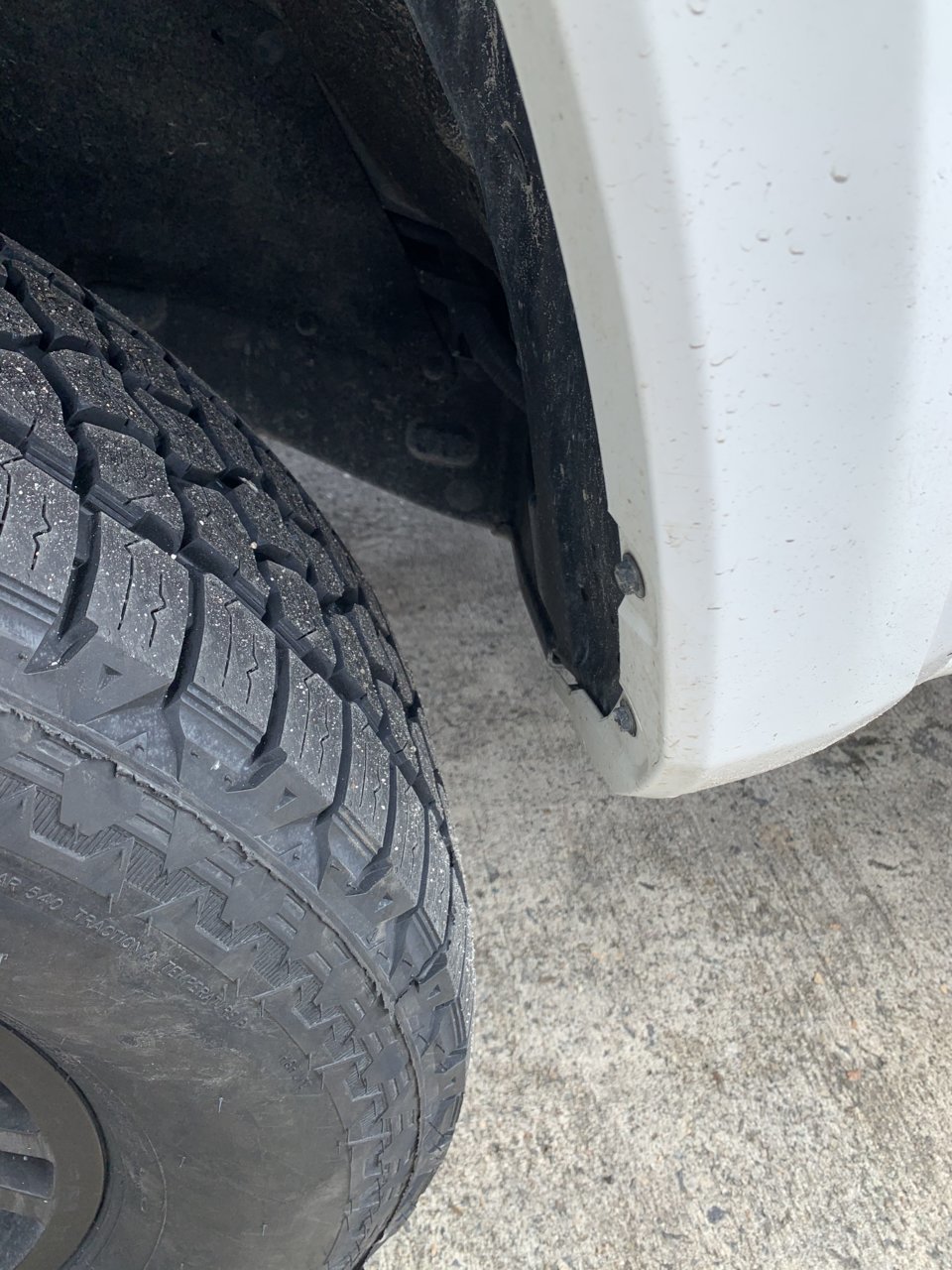

  17. Jan 28, 2021 at 3:22 PM
    #4377
    cmt_taco28
    cmt_taco28 Well-Known Member
    Mar 2, 2020
    #320836
    133

  18. Jan 28, 2021 at 3:22 PM
    #4378
    Kblack1968
    Kblack1968 Active Member
    Jun 21, 2019
    #297042
    30
    Kevin
    Ocean Isle Beach, NC
    2016 Tacoma Super White TRD Sport 4X4
    Eibach coil overs front and Deaver AAL rear. 17” TRD Pro wheels.
    I haven’t taken a lock to lock pic yet but I will.
    CygnusX191 and rbhowie like this.

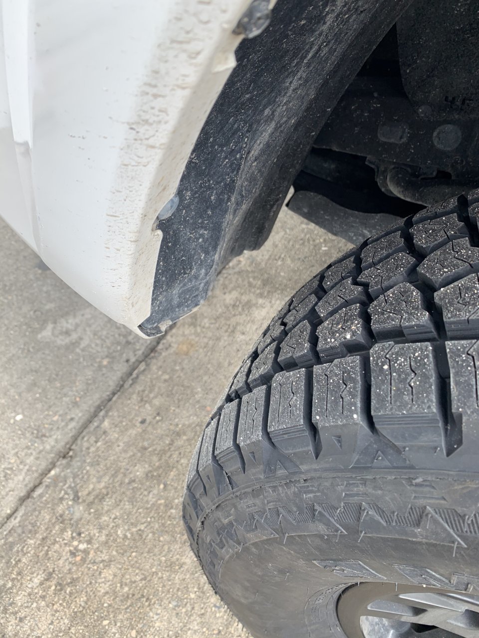

  19. Jan 28, 2021 at 3:24 PM
    #4379
    Kblack1968
    Jun 21, 2019
    #297042
    30
    Kevin
    You can see the cab mount in this pic and articulating the front tires it’s about 1 to 1.5 inches away. Double checking my alignment on Sat morning
