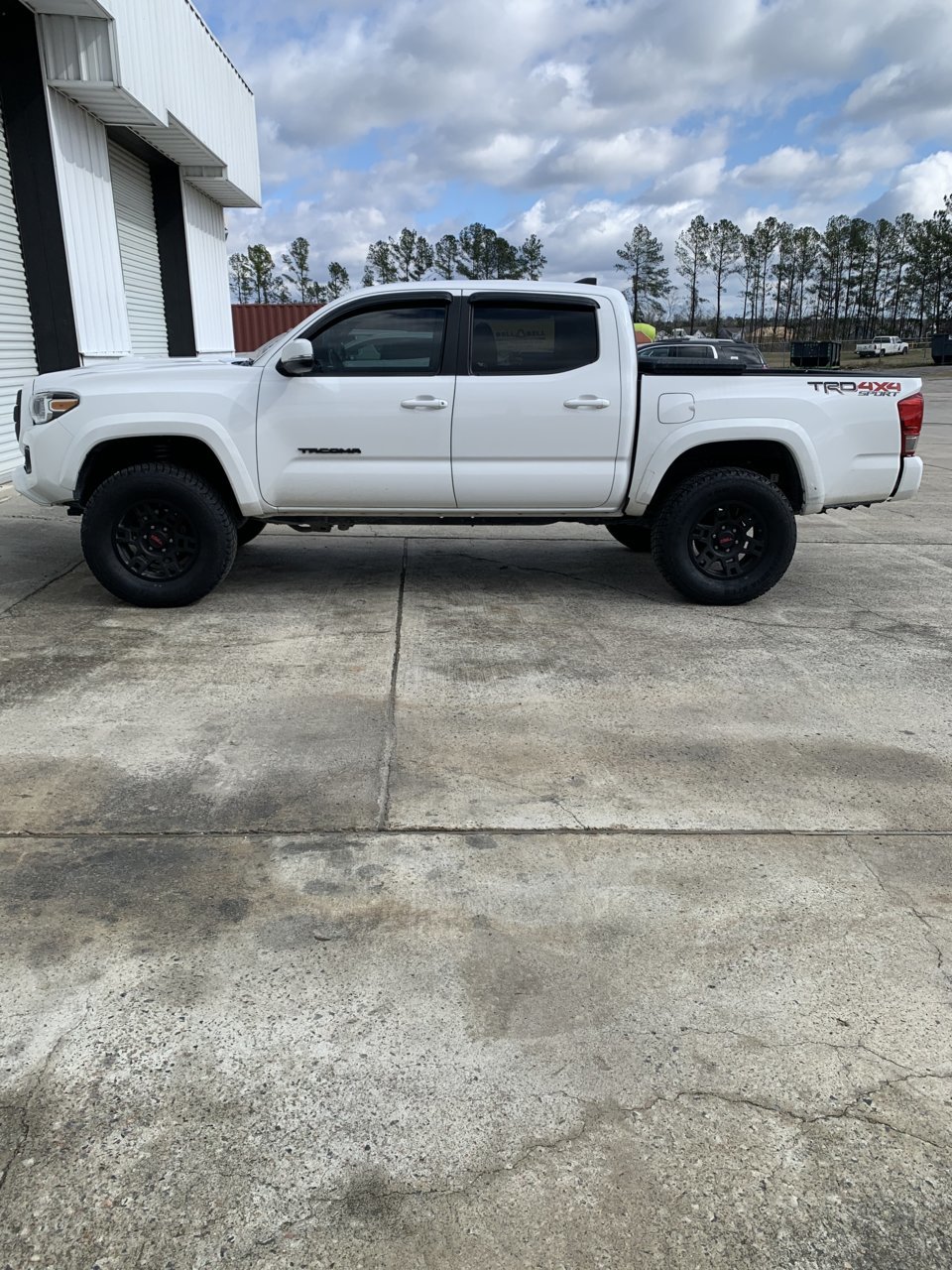

    Installed the eibach lift on the first notch along with OME Dakar medium leaf springs. Also installed the driver spacer but I’m still getting the driver side lean. Tho the front is very minimal but still noticeable, rear is the most noticeable.
    Anyone also have this issue or know of anything to solve it?

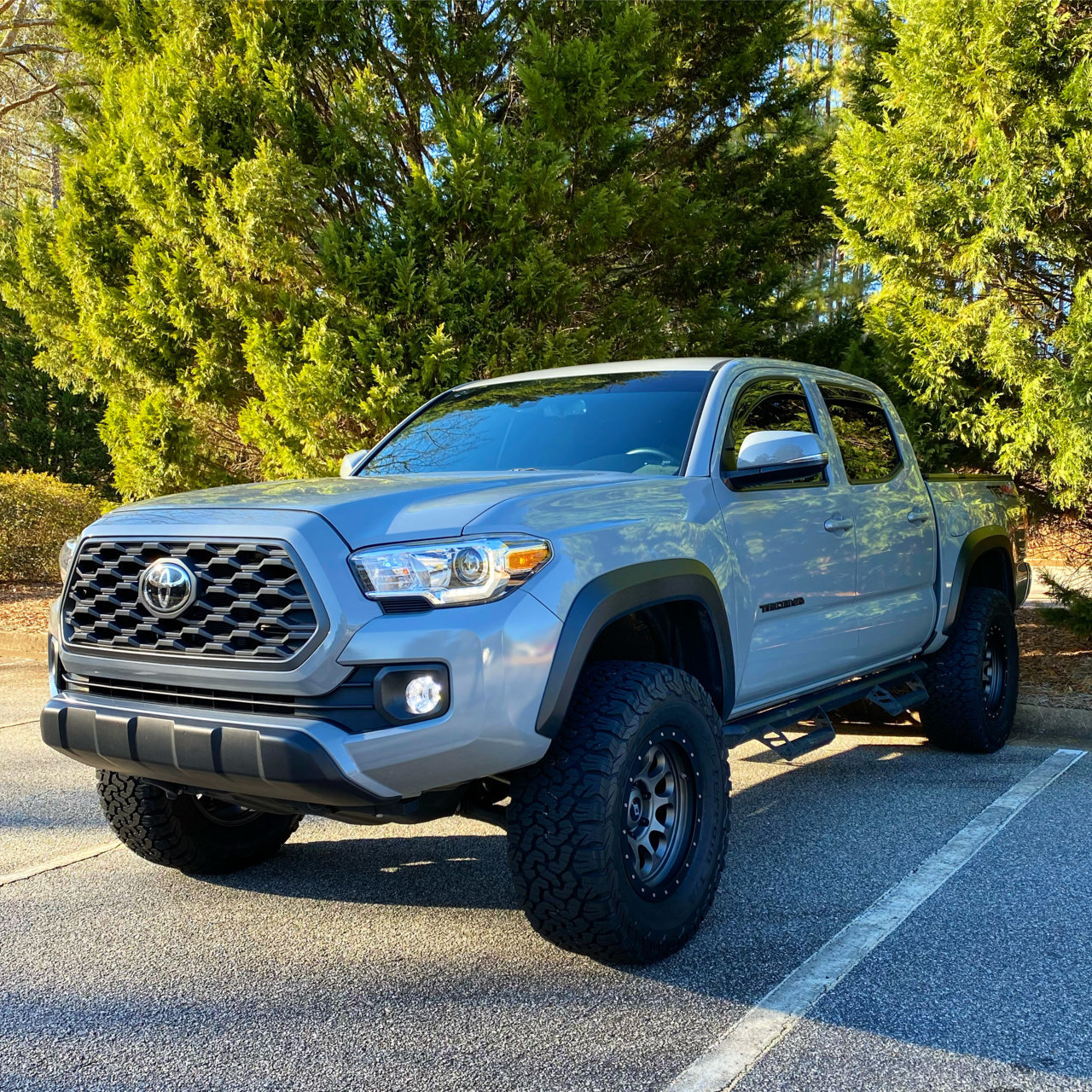

    Thanks! I was expecting more than that actually. Looks like more than 2 inches of lift (mine stock is 21"). Truck looks awesome.

    You have all kinds of room. Nice.

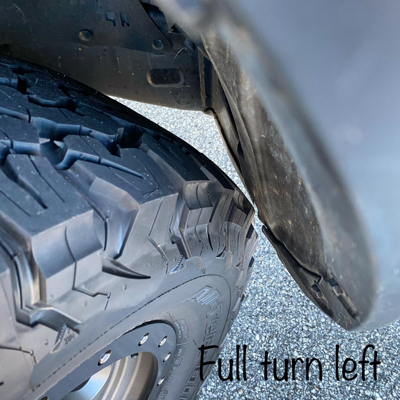

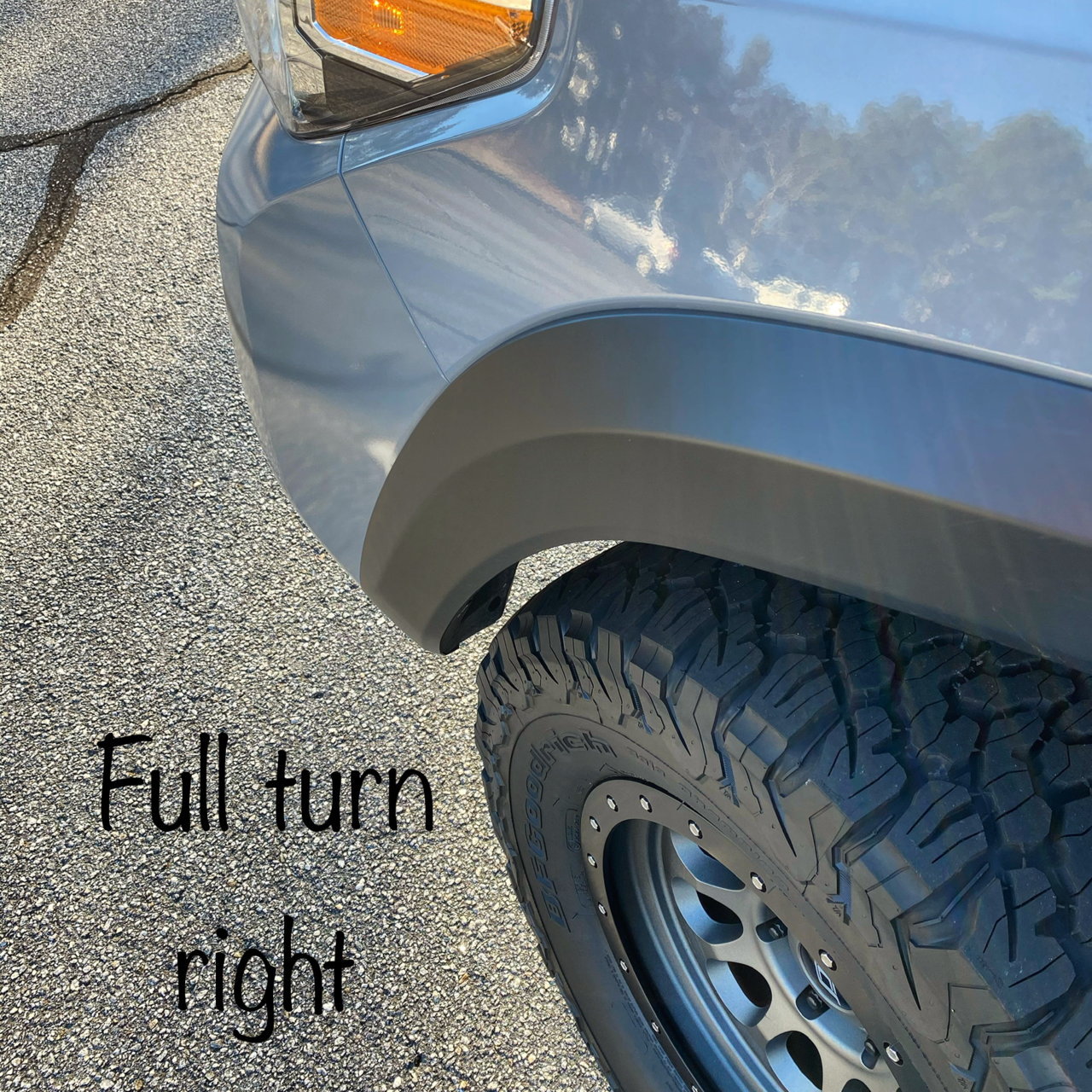

    I can attest this is exactly how mine turned out, wheels turned left and right look like mine too

    OME leaf springs are side specific. Drivers side are marked with a big yellow +
    Passenger side have a big yellow -

    Yes my bad. Rear leaf (springs) lol

    I’m on the second clip, for sure. They’re running different sizes so the measurements will be different from mine, but rest assured both tire sizes fit with minimal rub. Also, my measurement was not exact by any means. I took it with a tape measure in one hand and a phone in the other. Every truck is different but you can expect around 2.5” of lift at the second clip. I found out shortly after I posted that I have a VERY slight rub on the plastic when backing up at full left turn locked. I can definitely live with it. Wouldn’t change a thing.

    Taco looks killer! I went back to this page and didn’t see anything listing what you have in the rear. What leafs do you have?

    Thanks man. I have the stock leafs with 1” Eibach lift blocks in the rear. That’s it.

    wtffffffff. Lol looks good for having just that.
