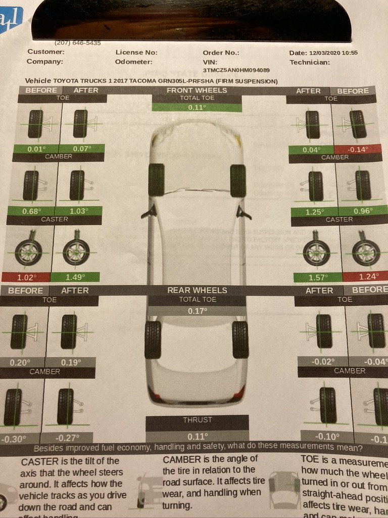

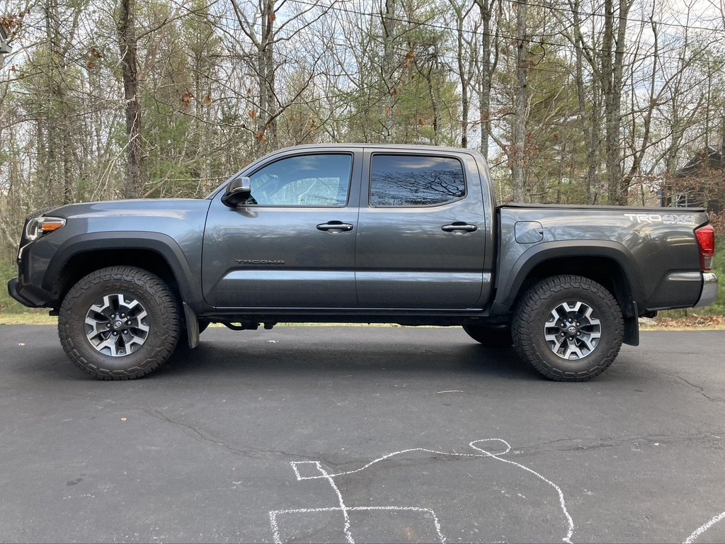

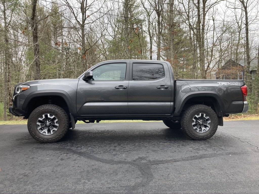

    Small update to my previous post (page 208 I think). I still find the ride a bit too stiff overall as a daily driver with an empty bed. However, it did ride much better with the family (wife and two small kids) and a bunch of stuff in the bed for a long weekend. So, a bit of weight makes the ride better, especially the rear.
    Current measurements ground to fender (hub to fender) are:
    RF: 37-1/2 (22-5/8)
    LF: 37-1/4 (22-5/8)
    RR: 38-1/4 (23-1/8)
    LR: 38 (22-3/4)
    Note: 2017 DCOR, no bumper or armor. I am on the first notch, 1/4" drivers spacer with 1.5" icon AAL. I have 32" tires (not 31.7") 265/75-16 Yoko XA/Ts. Still have stock UCAs but I am strongly considering getting some JBAs this spring/summer for better caster.
    Edit: Also, a little under 1/2 tank of fuel.

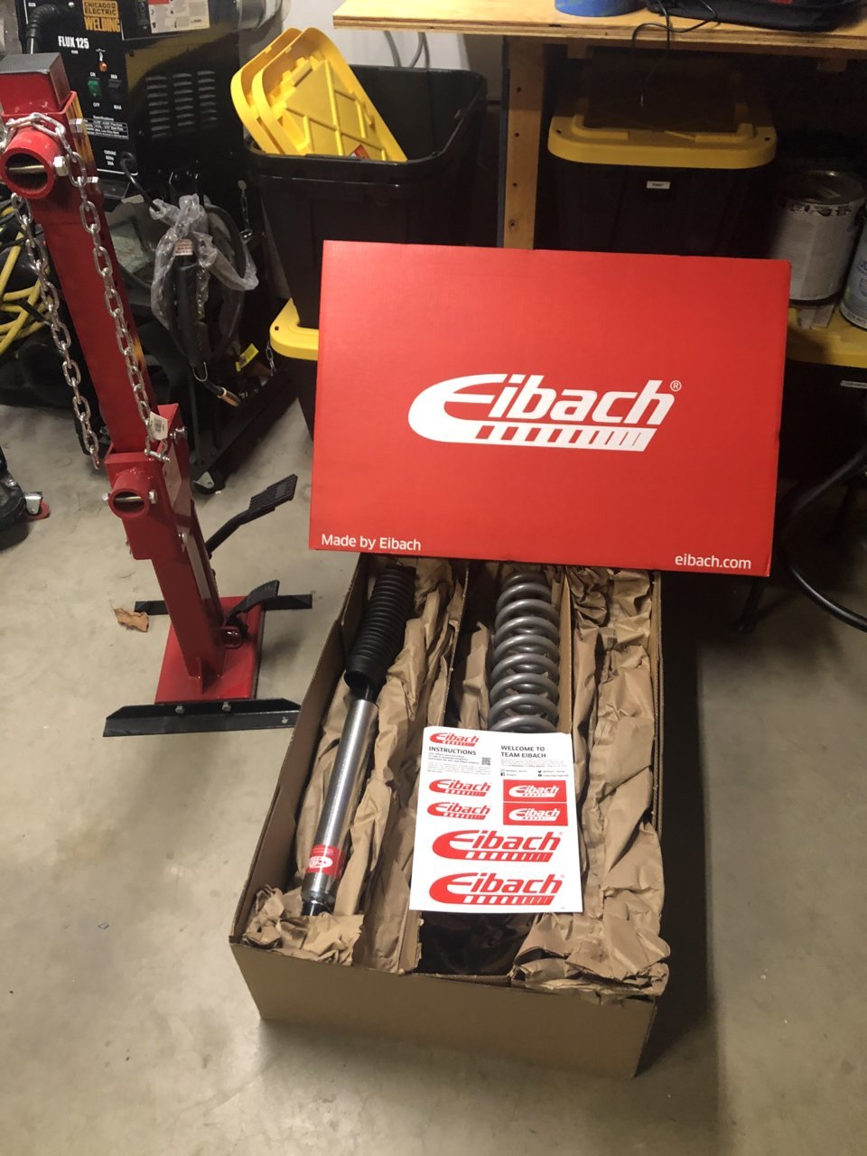

    Finally received my lift from Eibach today. Now have to hurry and wait some more for ultrasound on knee from work injury this past week. Can’t catch a brake lately.
