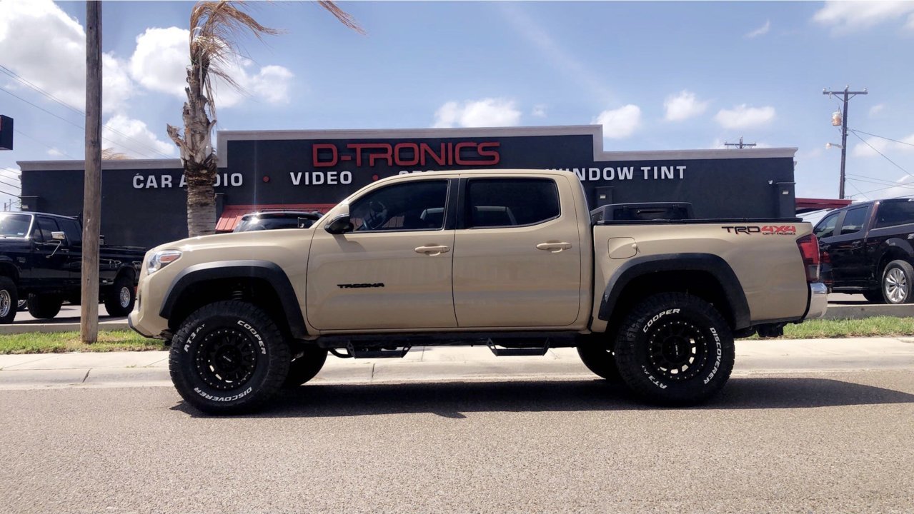

    295/75/16 Cooper AT3
    Eibach Pro Second Notch
    Tires were just mounted this morning and so far I’ve yet to rub! I do think some trimming is needed especially for OffRoad use but I’m definitely excited about this combination overall.
