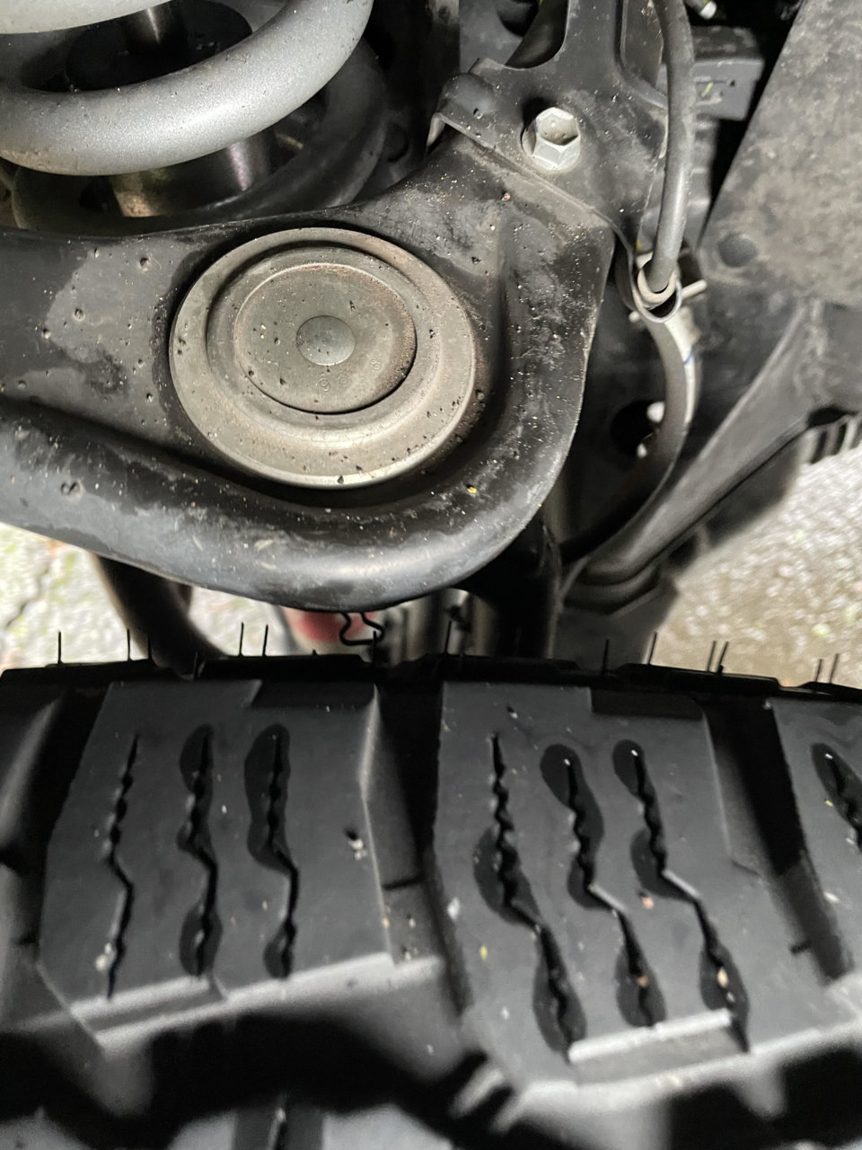

    Got this lift kit a couple months ago and wanted to wait for any settling before I did any other mods. So far it's been amazing, but I had a quick question. If I was to upgrade to 285/70r17 KO2's and got the FX pro wheels that are 8 inches wide with a 0 offset, will possibly rubbing on the UCA be an issue? I think that even with the bigger tires I'll be another half inch away.EB1.jpg EB2.jpg

    Im not sure what the offset is on those wheels, but im pretty sure almost all stockers are +12 or so, so the 0 offset fx pro’s should bring the tire/wheel away from the UCA

    I think the stock are around +30. Did the offset calculator and got about .94 inches more room and the KO2s are .8 inches wider. So I think that means I’ll have about a half inch more room in there?

    I have 285/70/17s with a very similar wheel. I've done the cmc and pinch weld and have no rubbing anywhere. I'm at 2.5 inches up front. Still on stock UCAs.

    Awesome thanks guys. Mostly concerned about rubbing on the UCA. I think some guys at work can help out with a CMC. Threw the lift on with a 3 leaf AAL myself. YouTube is deceiving, took about 11 hours on a Sunday with no prior experience.

    Running method wheels 0 offset and 295/75/16 tires with no rubbing. So you’ll be fine.
