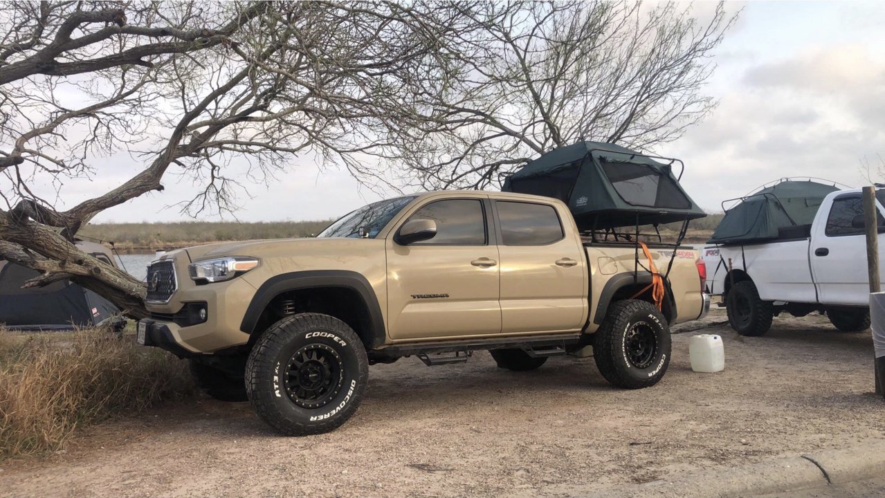

    Cooper AT3 XLT 295/75/16 Method Double Standard wheels Eibach Pro lift Baja Design Fogs Baja design Ditch lights W/ Cali raised Lo pro Brackets WrapArmor Hood Decal

    1.5” blocks for now. Rides really smooth with the new Coopers. With my old Bfgko2s I felt a small vibration.
