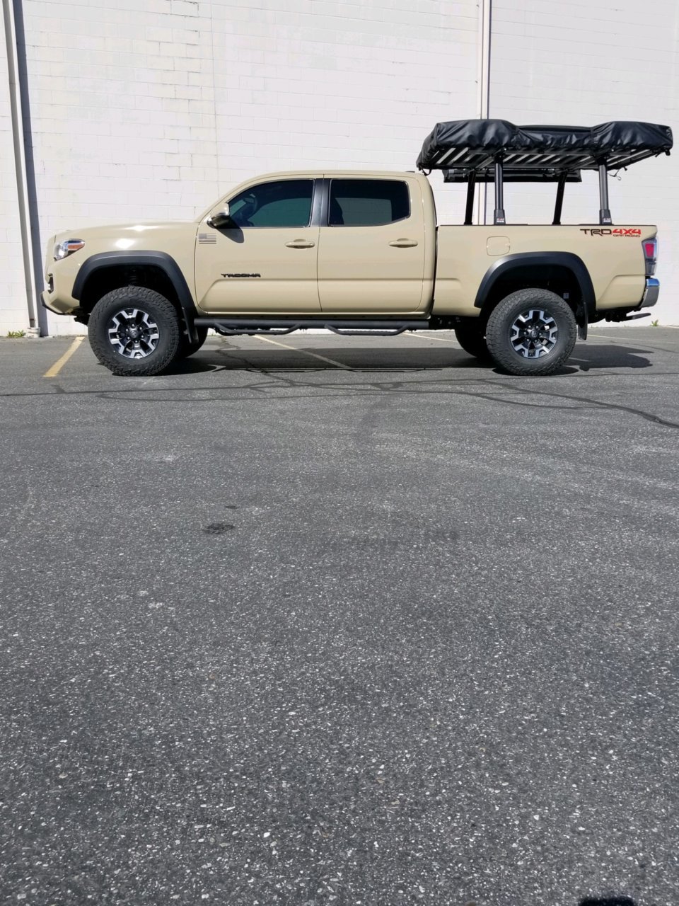

    2020 Tacoma TRD Off-Road
    LED lights Eibach 2.5" coil and shock liift with 2" AAL W/2* shim in rear, RTT
    Nope, they don’t stick out past fender. No throwing of any debris.

    My brake lines are fine, and my recommendation would be to 2”AAL in rear with 2nd setting up front. This setting has netted me 1/2” of rear rake. Hardly noticeable. I can’t imagine doing less than 2” in rear, as mine would have had the “bro lean”.
