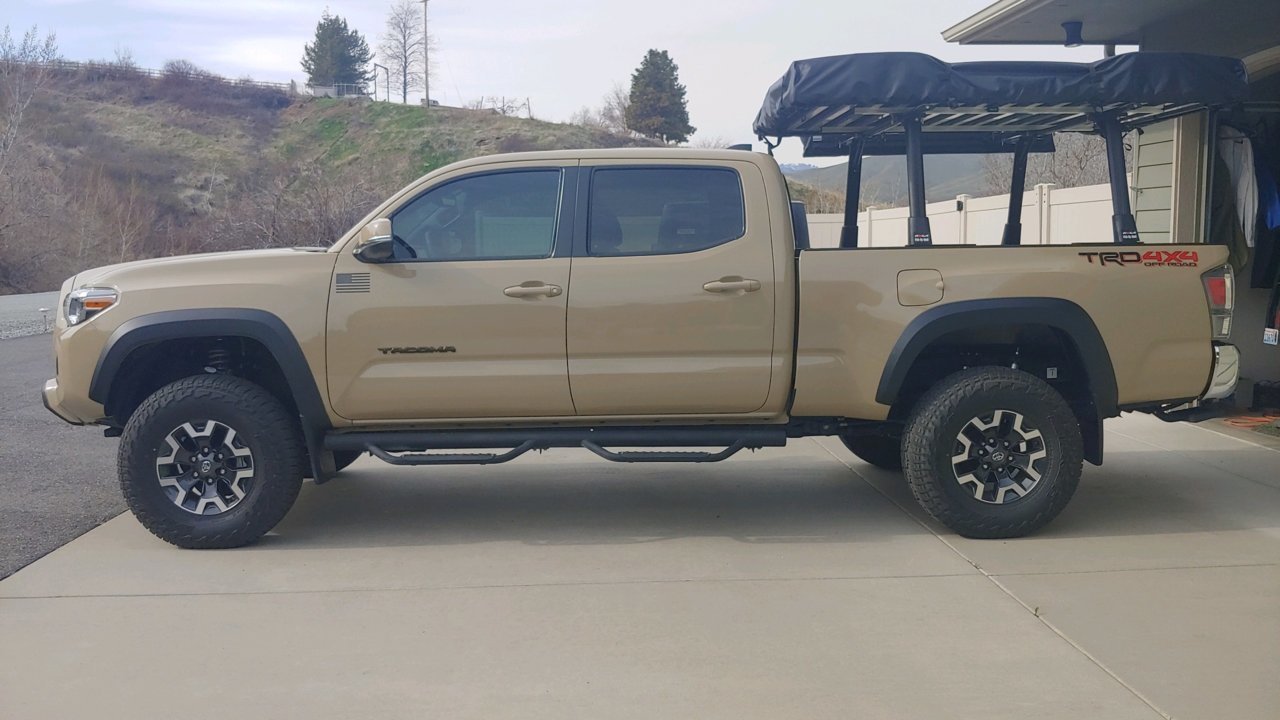

    LED lights Eibach 2.5" coil and shock liift with 2" AAL W/2* shim in rear, RTT
    I did the 2degree shims with 2nd setting up front and 2” AAL in rear with no vibes, good or bad
    CygnusX191 and taco kai like this.

    Does anyone have it on the second knotch with the 1/4" spacer?
    Any ride change?
    I'm doing mine next weekend, changing from first to second perch. May as well do it all while it's pulled apart.
    This may be a really dumb question, which I'll accept being called out for haha.
    To change the perch height. Can I leave the coil assembled to the top hat and just compress the spring so the bottom lifts enough to change the snap ring and perch?
    Or should I just pay a shop with a wall mounted compressor to do it?

    69710C9E-AE79-4380-9C17-6AF54FFC780C.jpg Yes, 2nd notch and I have the 1/4” driver side spacer, and it leveled it perfectly.
    I paid shop $20a shock yo swap over top hats.
