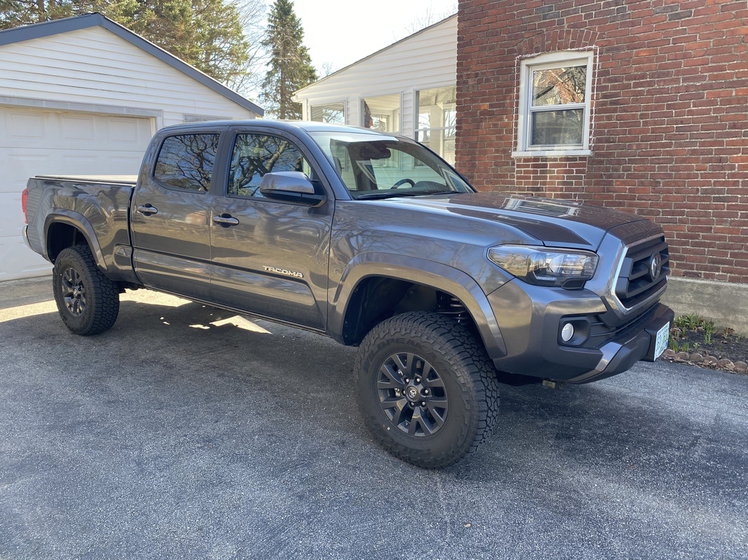

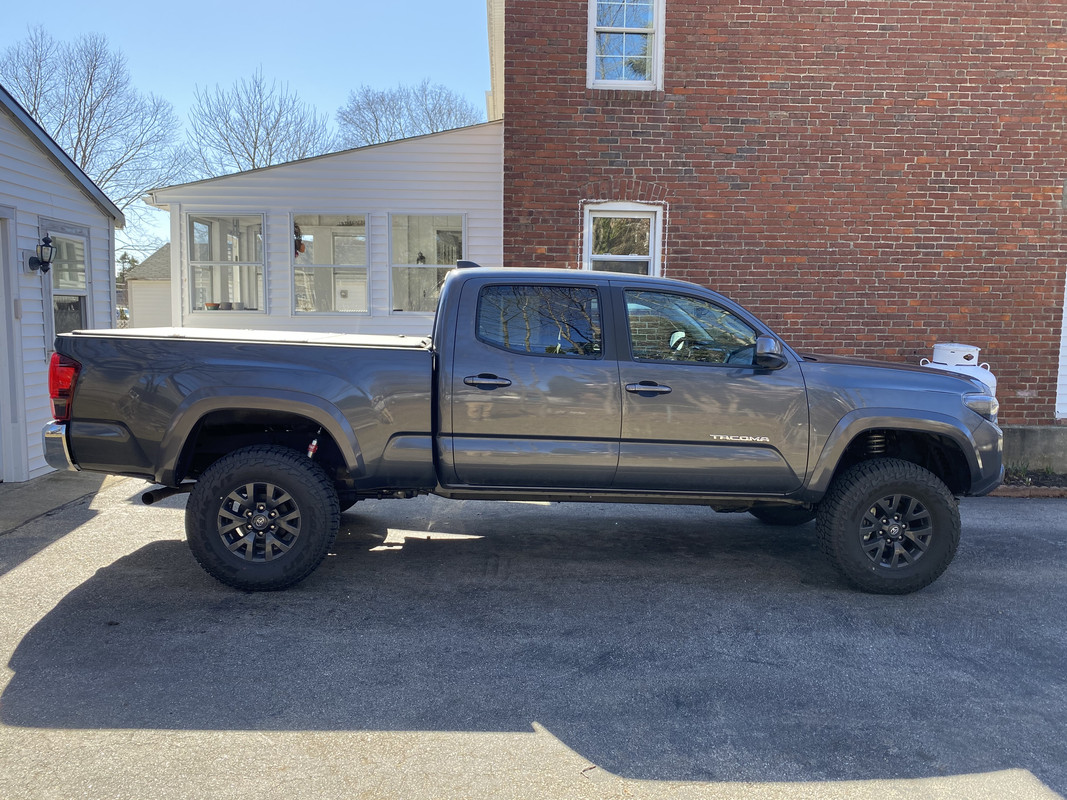

    Just installed everything today. Came out looking great! I need new wheels and tires though:rolleyes:
    Can anyone confirm if my cv angles are too extreme? Looks like this on both sides (pass. + driver). I have only driven the truck about 10 miles.
    Also thinking The excessive angles could be because I have not got an alignment yet and I can tell I am running some addition positive camber.
    Front set to 2nd (middle) notch and 2” Wulf AAL in the rear. 265/75/16 Falken Wildpeaks. Did the ECGS while I was in there as well.

    those angles are not terrible and it should settle after a little bit. Just keep an eye on them and check to see if the ribs are actually rubbing each other. If they are, that'll be the spot where it gives way and you might see some grease be flung around. Hopefully not though plenty of guys have not had that issue
