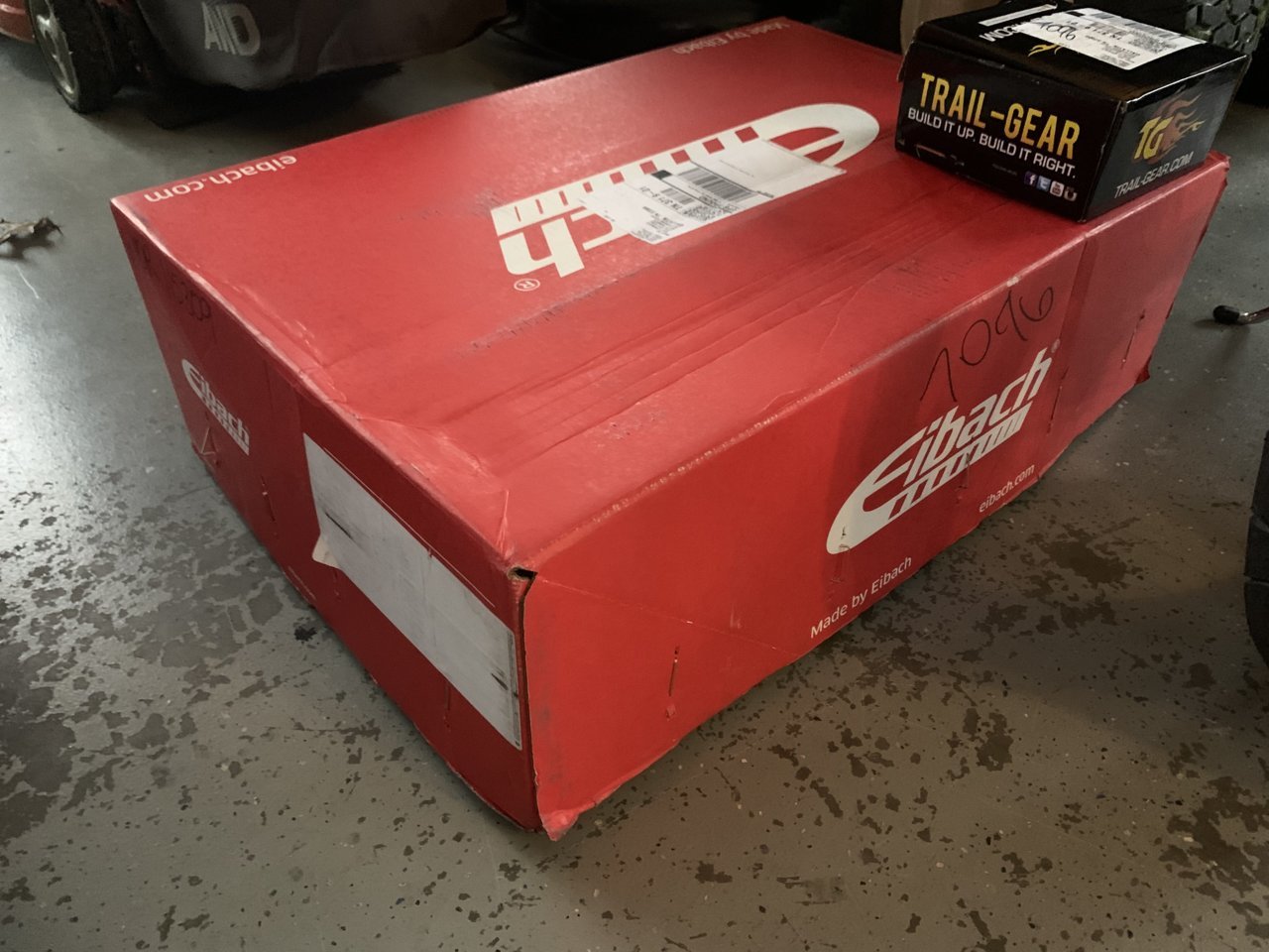

    I just installed a set today. They are back in stock but who knows for how long. We have been drop shipping straight from Eibach seems like they can barely keep up.

    received my kit from wheeler’s :amen:

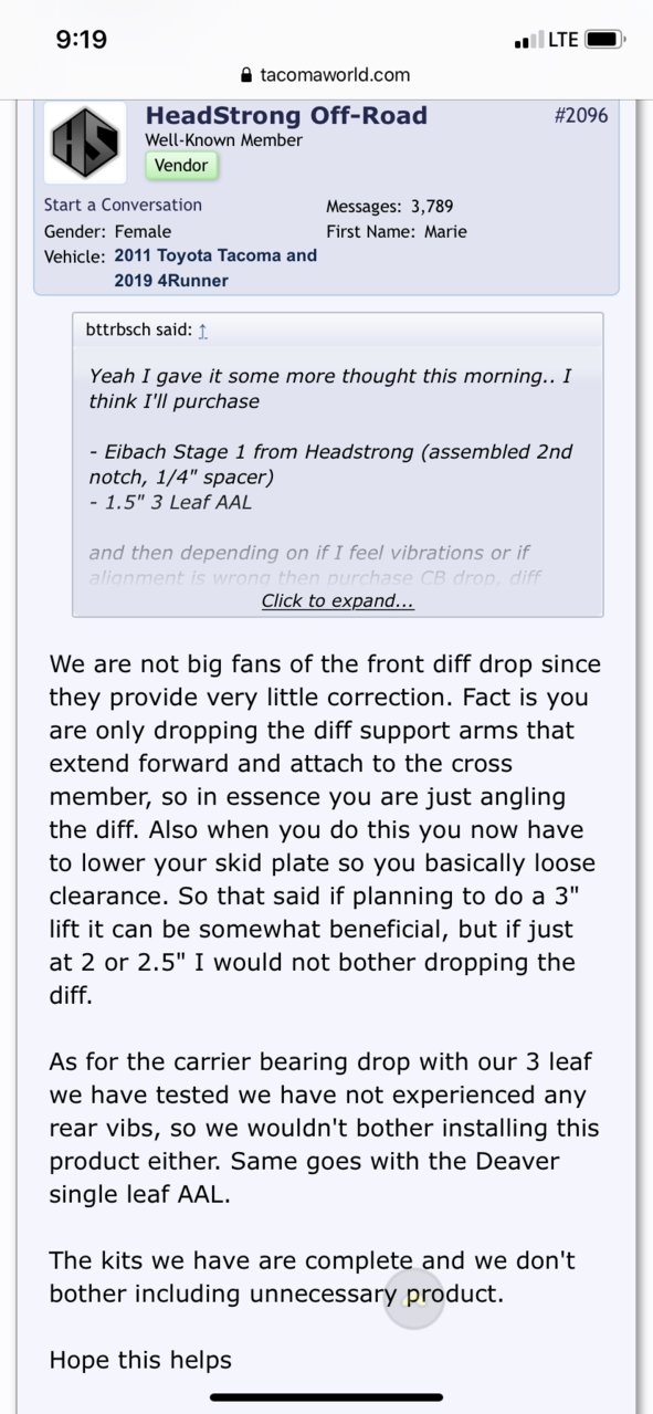

    Can anybody chime in about the Diff drop and CB Drop? I bought the diff drop but a good number of folks say it's not needed, but now the CB drop is being brought up as well. Does anybody have a solid concrete answers? TIA

    You don't need the carrier bearing drop if you are only lifted about 1 1/2" in the rear. Just put a 3* shim under the leafs and you should be good. This is how I've been running mine with the add-a-leaf and have had no vibration from the driveshaft.

    I believe you and I discussed this a few times before. Here is a response from Headstrong they gave to another member when I was researching my lift:
    YE2KA[QUOTED] and 71tattooguy like this.
